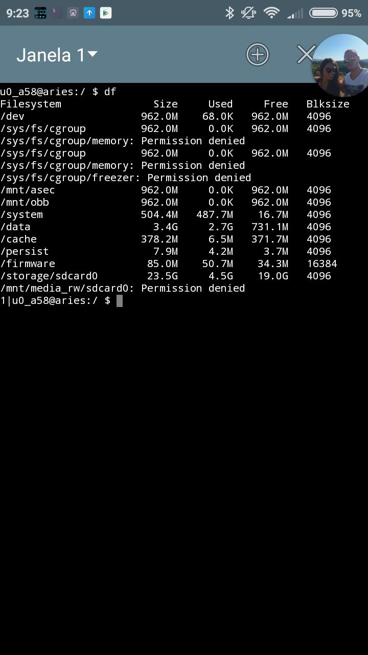

Graw2 said:
Have you already extended data partition? (5.4.24)
If you are not sure, first install terminal emulator, run df command and post screenshot here. Next step depends on the result...
Sorry mate (Graw2) i didn't saw it in time in the other topic i will post here the screenshot you ask me:
(thank you in advance)
You have not merged data and merged system yet. In this case first you have to flash latest Chinese fastboot ROM via MiFlash with flash all option. This install method will merge Data+Storage and System1+System2 partitions (it is required to install further updates), after that you can install latest xiaomi.eu aries ROM via updater app, furthermore you will be safe to install any further xiaomi.eu aries release simply via updater app or OTA

Hey there,
The method that you suggest me to do will erase all of my personal app and app data :(
Only question now is....There's any easy method to do a restore of my personal data and apps after all of those updates?
Thank for all the direct link's and for the explanation.
Hey there,
yeah, ofc it will wipe everything from your phone including internal storage as well. If you want to install further updates it is unavoidable.
In my case the most important data such as contacts, calendar, photos all synced with google. To get back these data I just need to logged in to google account on newly installed clean system.
Anyway you can use MIUI local backup&restore or MiCloud backup device, but as I know MiCloud method can't backup data for apps
