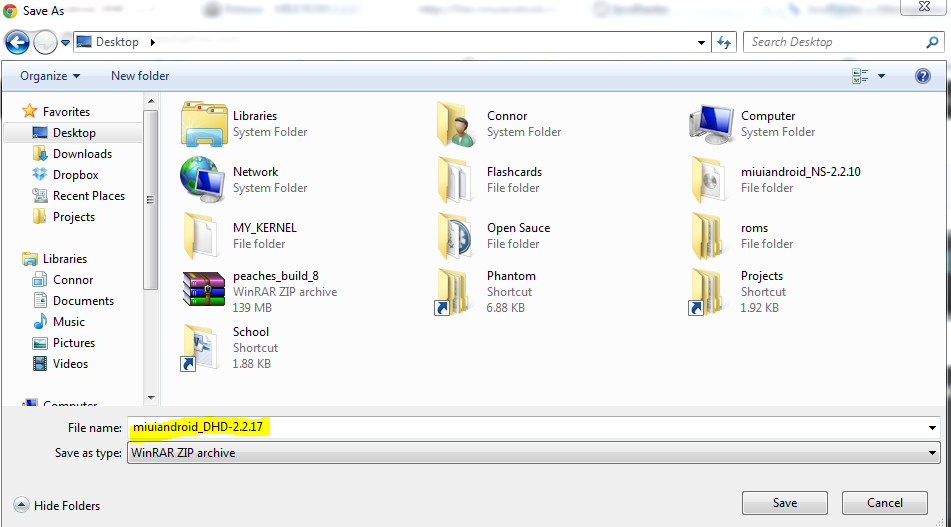

    Step 1: Getting the Files - [ALL]
    This may seem easy for some people, but we will be covering all possible points of mistake. First off, lets click this ROMs tab on the top of the page. Also, here: http://miuiandroid.com/community/link-forums/roms.73/
    This will redirect us to the newest ROM. ROMs come out every friday, and you can determine the current version by looking at the date. As MIUI version number system is as follows. Year.Month.Day, so Year 1 = 2011, Year 2 = 2012. Hence, why we are running in the 2.2.x branch now. Its the 2nd year in February (Time when this tutorial was written).
    The basic dialog pop up. Lets just download this to our desktop. We will be moving it shortly.

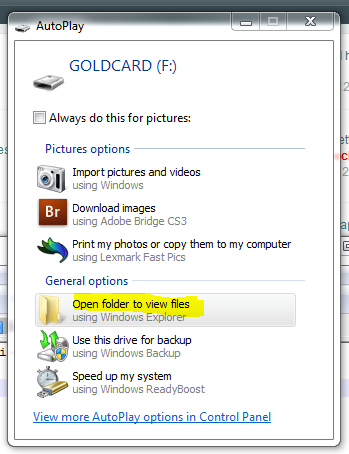

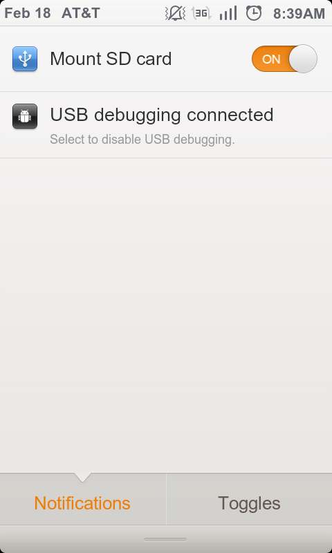

    Now back on our phone, lets mount our SD card. Simply drop down the notification menu and click the "Mount SD Card" option.
    Wait about 15 seconds until your computer detects the removable storage.

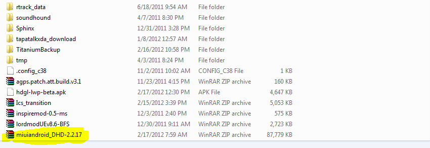

    We just want to explore the storage, as our download has already ended. We are now going to drag and drop that file into the ROOT of the SDCard. ROOT in this context means the "main" part of the SD Card. It means you cannot go back any further. You are in the root of the drive.
    (Notice how the miuiandroid_DHD-2.2.17.zip, is on my sd card)

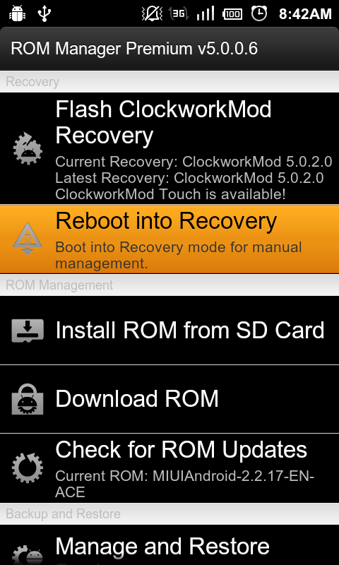

    Step 2 - Rebooting into Recovery - [ALL]
    This is fairly straight forward. Simply open up "Rom Manager", which you should have installed if your rooted. If you don't have Rom Manager installed. Install it. Its a must for any rooted user.
    The home screen of Rom Manager has a button labeled "Reboot into Recovery". You want to click this. Then after about 30 seconds of a reboot you will be at the home screen of Clockwork Recovery, also known as just "recovery mode". You use the volume buttons to navigate the screen and the power button to click items. If you have a "touch enabled" recovery you can simply click the options.

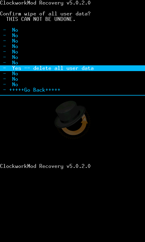

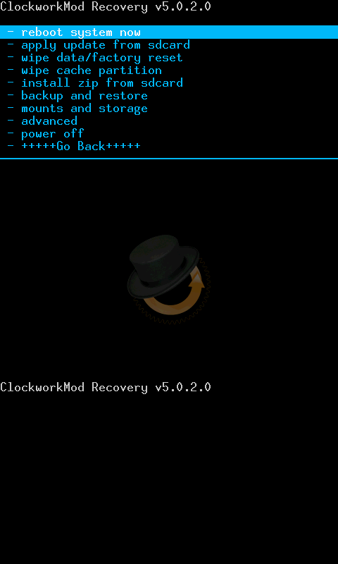

    Step 3 - System Wipe - [3,4]
    To confirm. Only users who fall in categories 3 and 4 from above SHOULD follow this step. We will be wiping the data. We have to do this because the way data is stored is vastly different in MIUI from other versions. So confirm that you have your contacts back-ed up to Google and you have made a nandroid backup from Step 2a.
    After you click "Wipe data/factory reset". You will be presented with a list of NOs and one Yes. This is just a security precaution to prevent accidental clicks. Simply use your volume buttons to navigate the menu and find the one option that says "Yes -- delete all user data". This can be seen below.

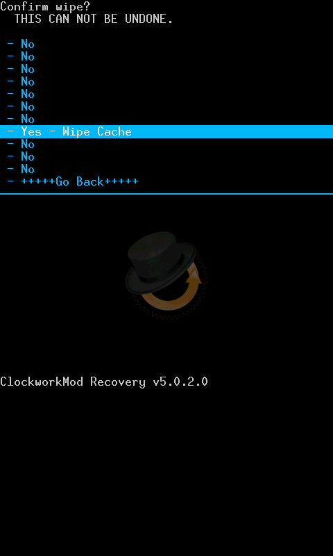

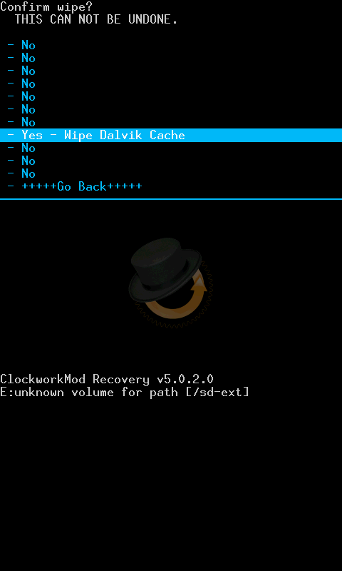

    Step 4 - Cache Wipe & Dalvik Cache Wipe - [ALL]
    This is a good practice to do this before flashing any ROM. The /cache partition just stores temporary files that are not critical to device operation and can be re-generated easily. The dalvik cache wipe is quite similar but it stores the post ran java applications. Since Android is JAVA based, it uses the same java virtual machine for compiling. The dalvik cache just stores post-compiled applications in order to speed up the system. Wiping this just forces the system to re-cache those application. It causes no problems but a slight hint of lag on first boot.
    You can wipe the cache by selecting "Wipe cache partition" on the recovery home screen. You will be presented with the same NOs and YES options that were presented in prior steps. Simply find the option that says "Yes -- Wipe Cache" and click it. (As seen below)
    The dalvik cache can be wiped by selecting the "advanced" option, then locating the "Wipe Dalvik Cache" option. You will be presented with same format as above. Click "Yes -- Wipe Dalvik Cache" (as seen below).

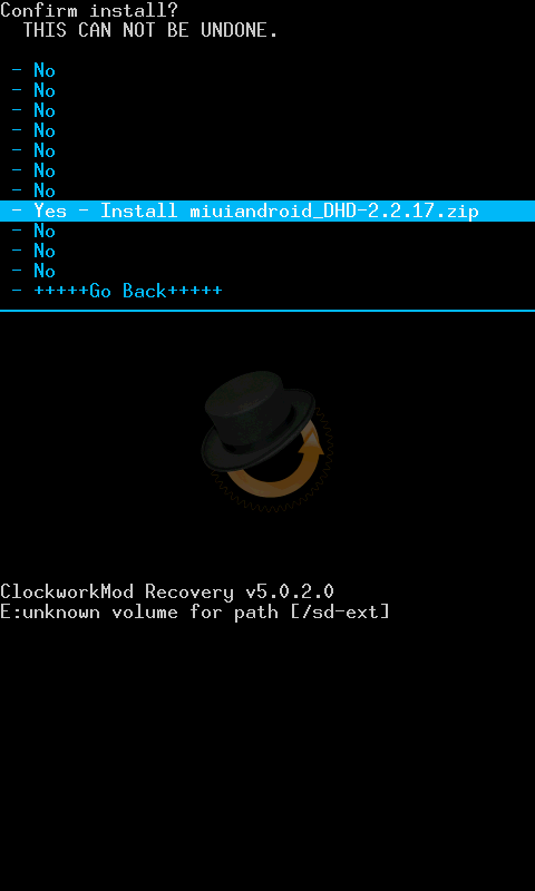

    Step 5 - Flashing the ROM - [ALL]

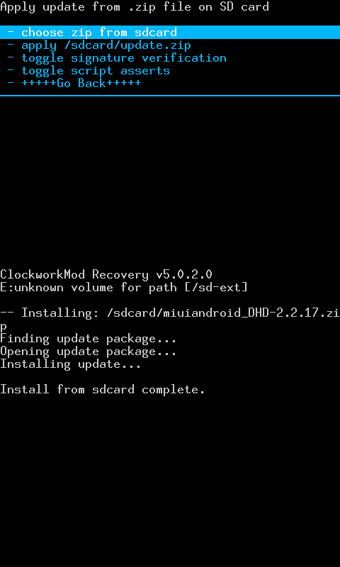

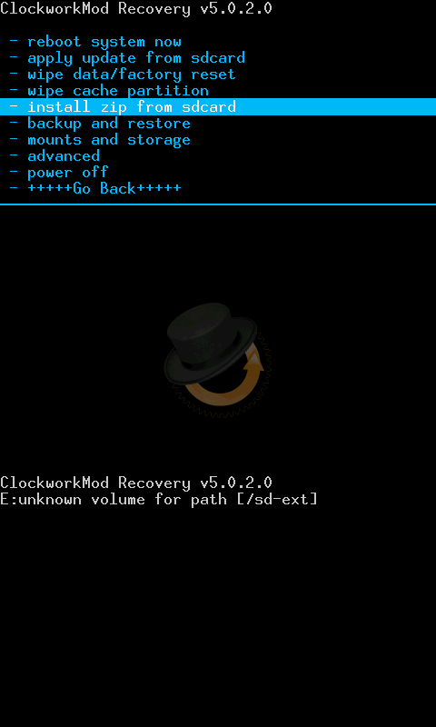

    Now that our system is wiped and ready for a ROM. We can proceed to flash one. An option on the home screen of recovery is labeled: "Install zip from sd card". (As seen below).
    The next option you must select is "Select zip from sd card". (as shown below).

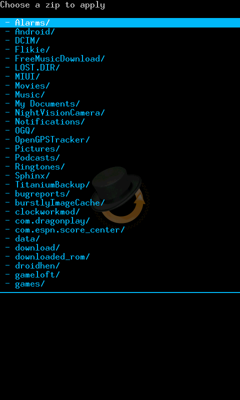

    You are now shown a huge list of all your files and folders. Since we dumped the ROM into the root of the sd card. You can simply scroll down to the bottom to see the list of ZIP files.
    Make sure you flash the ROM you are intending to. In this tutorial, I will be flashing "miuiandroid_DHD-2.2.17.zip". The DHD refers to my phone. Which is the DHD or HTC Desire HD. You have to flash the ROM for the phone it belongs. Once you select the ROM, you will once again be provided with the same list of NOs and one Yes. I hope we know how to handle this now. (shown below).

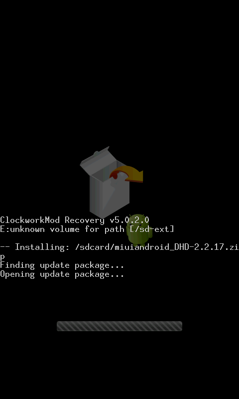

    Congrats. You are now flashing the ROM.

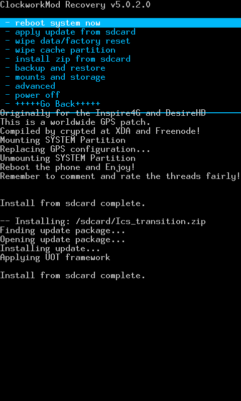

    This will take anywhere from 10 seconds to 1 minute (at the most). Then you will be presented with the screen below.
    If you notice the text at the bottom. It says "Install from sd card complete". Now if you have a kernel or another patch you wish to flash. Follow Step 5 again, except using that file. I usually flash a different kernel. So I simply go back to "Install from sd card" and repeat. Note that is completely optional, but as you get more experience you will want more for your phone.

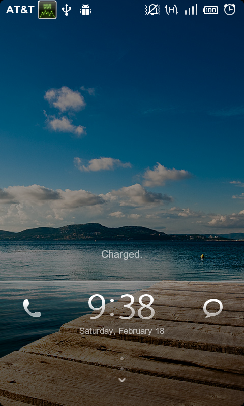

    Step 7 - Were Done - [ALL]
    If completed succesfully, the MIUI lock screen is shown.
    I'd wait till your sd card mounts itself before navigating the menu. It makes for a smoother experience.

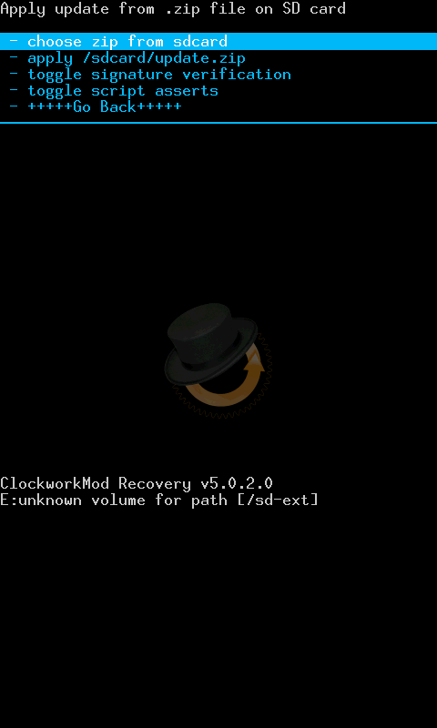

    No Signature, Verification Failed Error
    This is a simple fix. On the screen shown below.
    Simply click "toggle signature verification".

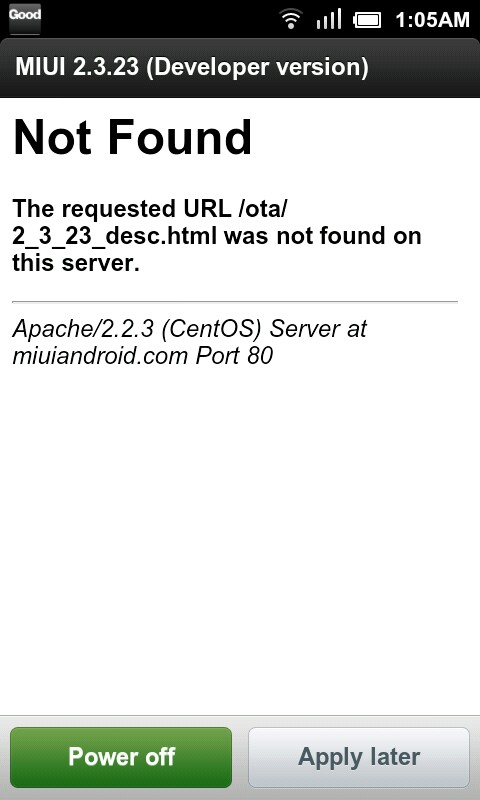

    I tried to update the ROM through OTA. Run updater, new version was detected (2.3.23). When I hit the new version tab the attached screen appeared. My understanding is that it should list a change log file related to the discovered update. The download itself started and finished successfully. Two questions to help understand better how OTA update works
    - what is wrong with the change log file? Was it really missed on the server? Or should I configure the phone somehow to see the changes?
    - why the whole ROM was downloaded? I expected to see only updates over my current version (2.3.16) loaded
    Thanks a lot
