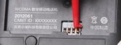

Hey, guy.

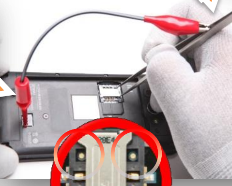

When you want to repair your bricked M2, you need to get the two test points and the battery holder negative to be short-circuit. It will force the low Level system work.
See the picture.

Hey, guy.
See the picture.

Hi, this is the rescue way for bricked M2 or M2s.
I do not know the way for samsung, sorry.

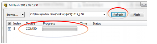

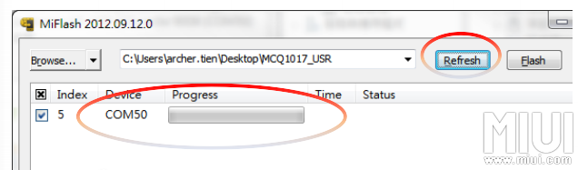

I suggest: First of all, connect your phone to your computer, and if the computer find new hardware"QHSUSB_DLOAD", install the driver, then open the MiFlash, and see whether there is device list on the panel, see the picture. If it is, you can flash it and save it.
If not, you should do the "short-circuit" ...

1, Take your battery out, find metal wire and make a short circuit between two test point and the negative pole point, see below(be careful, do not connect the wrong point!!!):

5, Open your MiFlash, you will find a Qualcomm device in the list:
6, Flash a complete rom,such as :QDT10, or JLB15, etc. Your phone will reburn...
