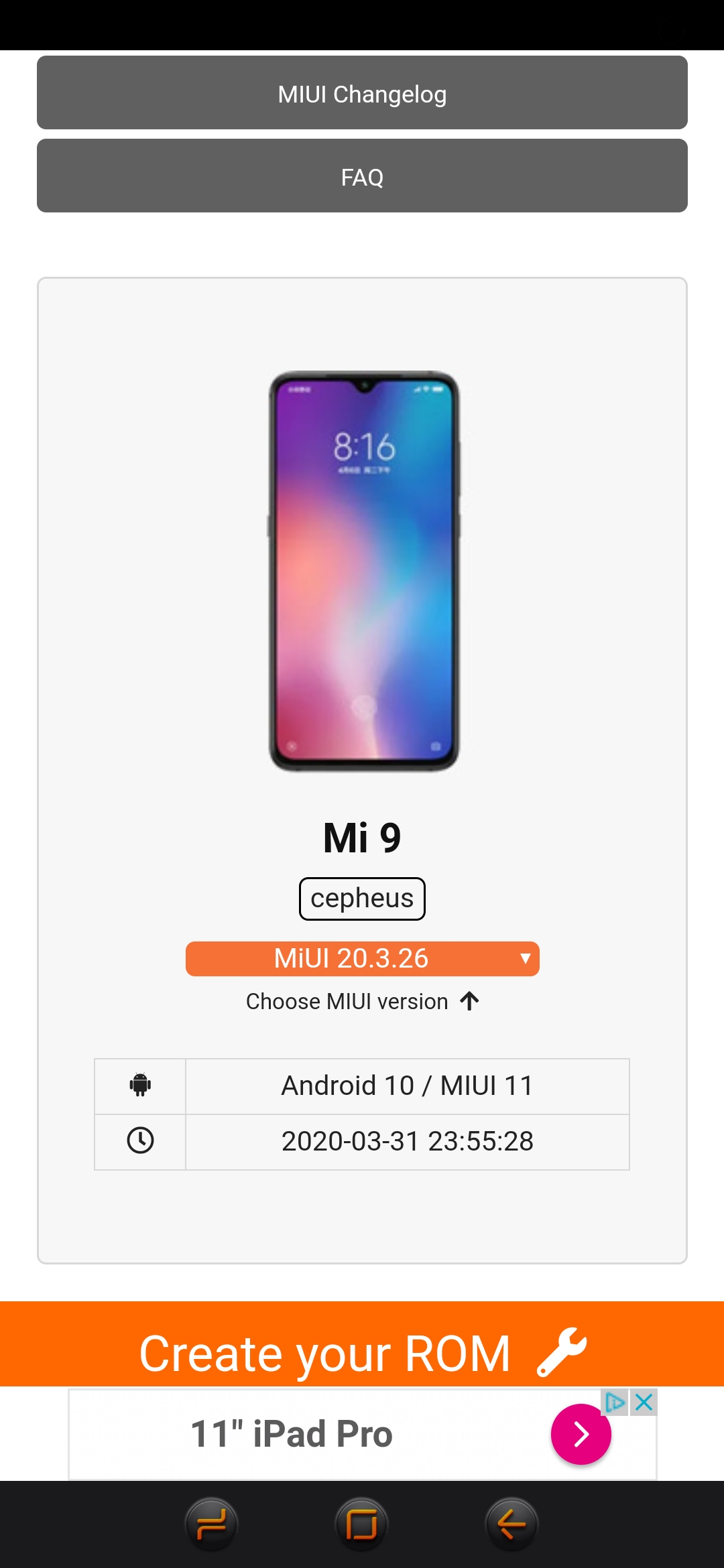

Good evening, just saw there is a new update. But unfortunately I can't find a changelog.
You are on xiaomi.eu forum, I don't know where you took your screenshot but it's certainly NOT xiaomi.eu website...
Ask your question to the right place...

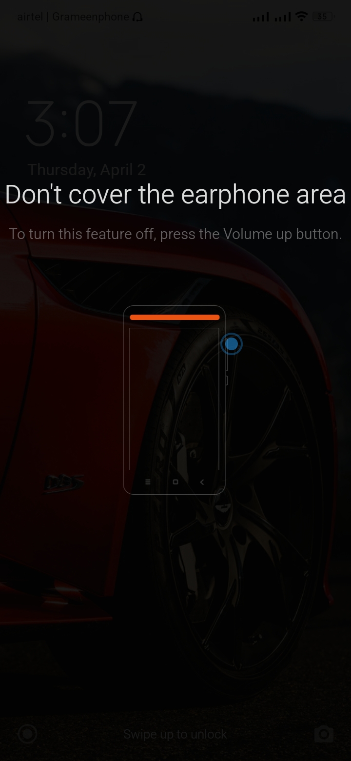

Hello,I think I'm having issues in this latest update on my cc9e.
Whenever I place a call on phone, messenger or anything, my screen goes completely dark and nothing works untill the call is disconnected.
I think the proximity isn't working.
Is this a miui problem?
And I'm getting this message randomly...

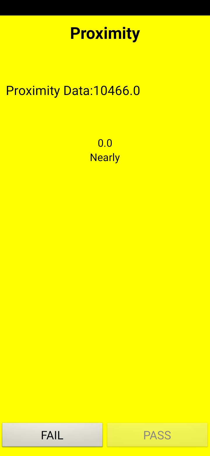

At first i thought that may be dust is covering up my proximity sensor. So, I've cleaned my phone. But still the problem persists.
Proximity data when proximity is not blocked.

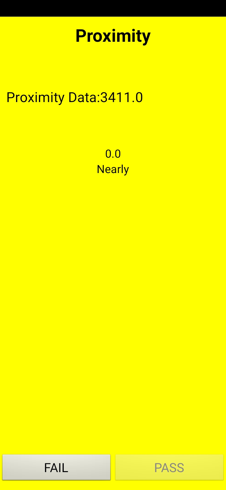

Proximity data when the proximity sensor is blocked...
Experts plz help.
I think I've had this problem on the previous update too...
But now it's serious.
Generally, if proximity sensor is not working you will always have your screen display "ON" during calls, not "OFF"...

The proximity is working but it's detecting that something is on top or blocking the sensor when there's nothing blocking it.
So it instantly turning the display off when a call is being placed.
i already tried the engineering mode but there's no option to calibrate it.
