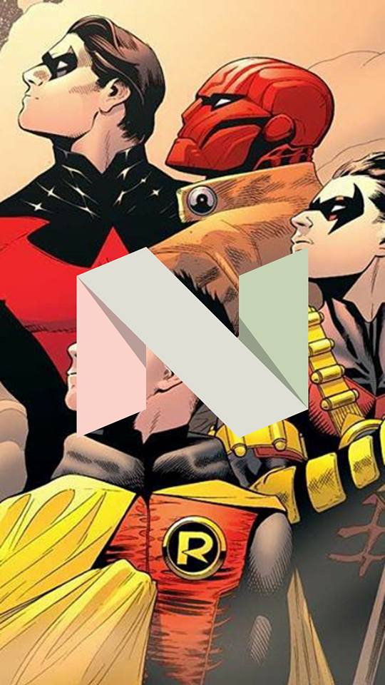

hahah no luck, now trying from 6.12.22 then update twrp, if still fail last option is reflash from fastboot :D
reflashing cn version via fastboot,
unlocking,
reflashing twrp,
reflashing eu version,
done.
now installed Android 7 Stable.
thanks you dev.
