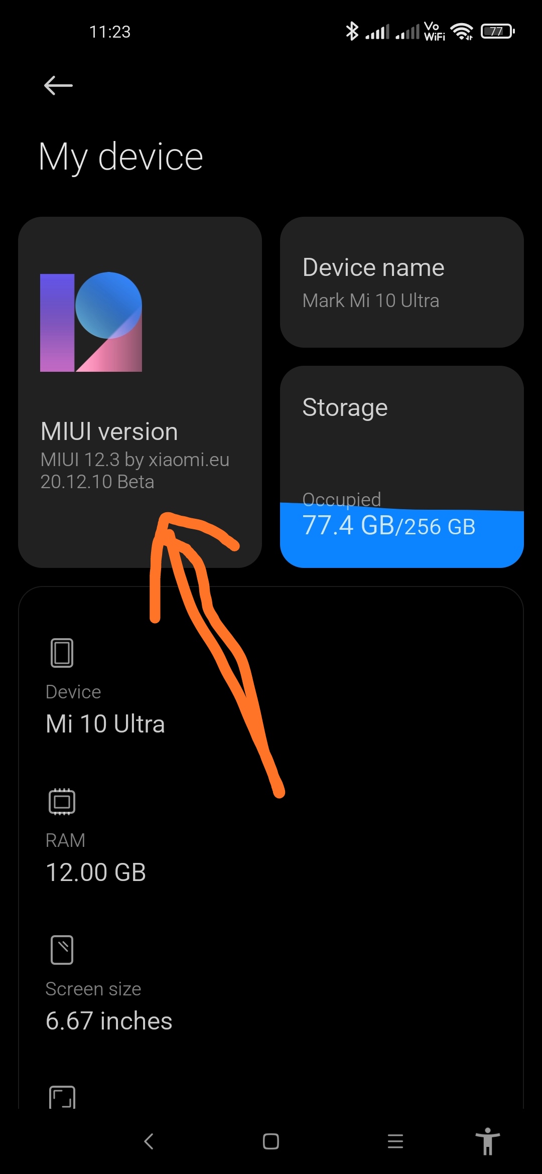

But how can I know if weekly or stable is installed on my phone? which one is better?

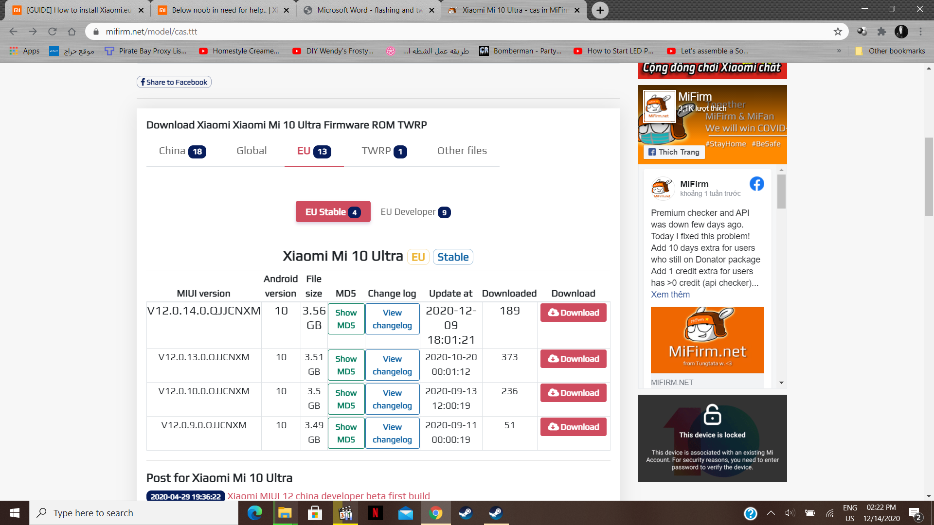

33375
I can not find the fastboot one.. I can find in China but I want global rom..
Should I pick TWRP or EU? I will go for stable I don't want developer I can barely run my phone lol

If you go to the settings, click on my device and it will say beta if it's weekly.

There are no fastboot EU ROMs now. You need to use a twrp Stable ROM.
I am downloaded already stable rom EU one "xiaomi.eu_multi_MI10Ultra_V12.0.14.0.QJJCNXM_v12-10"

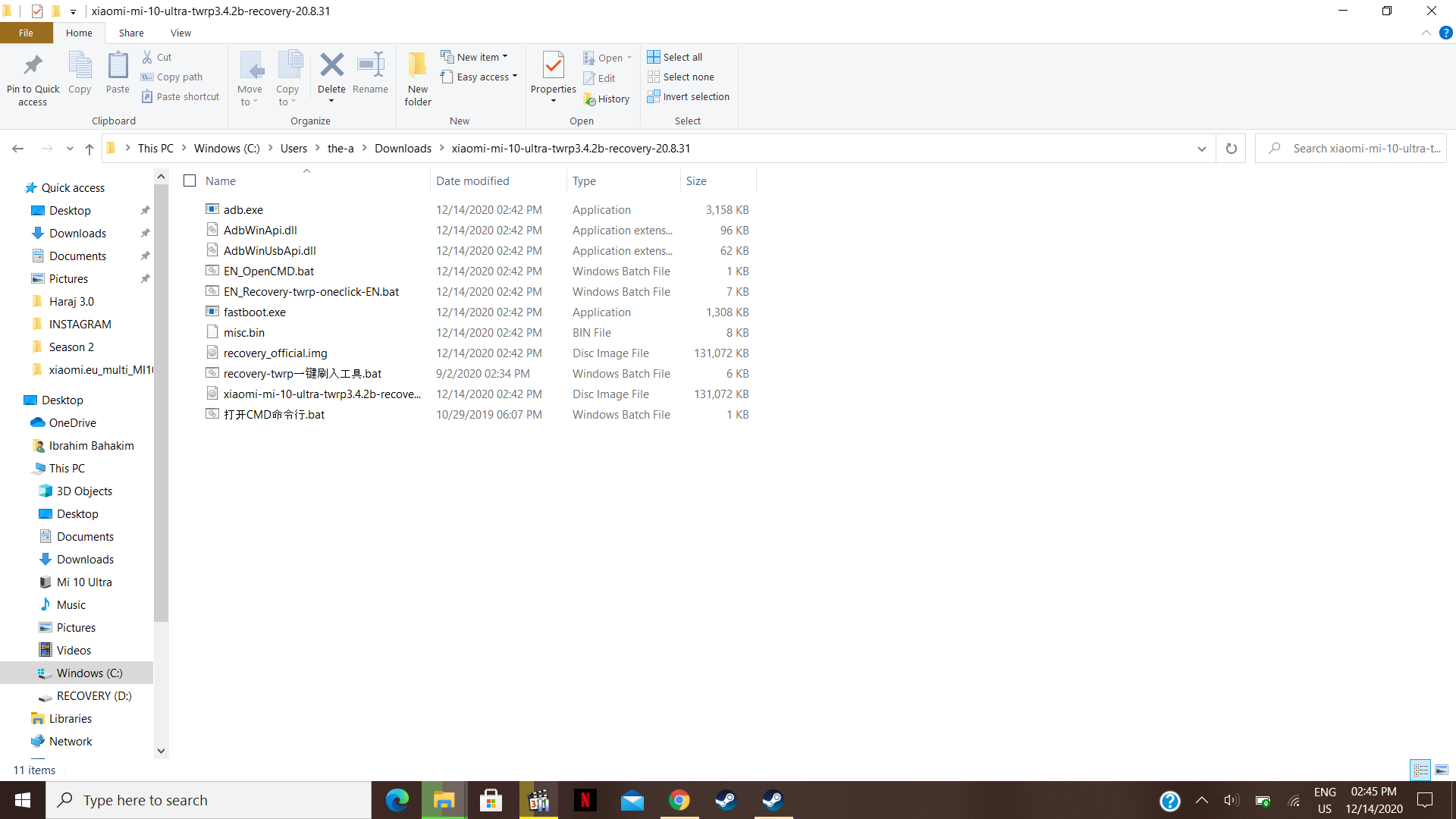

Also I am downloading the TWRP rom thing.. "MiFirm.net_xiaomi-mi-10-ultra-twrp3.4.2b-recovery-20.8.31.zip"
I already unlocked my phone so I will wait to try your PDF guide and see if I stumble anything I don't understand.

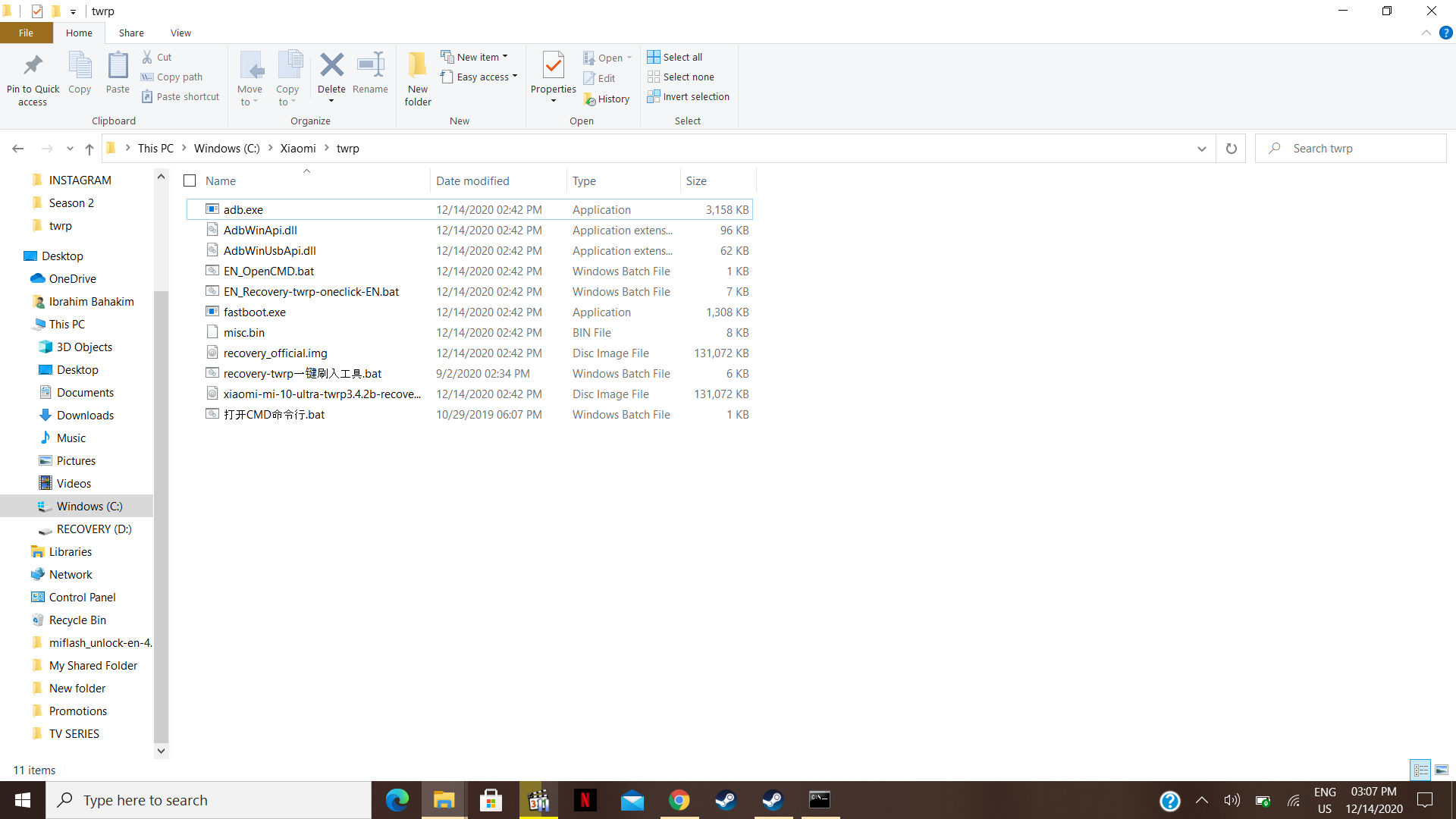

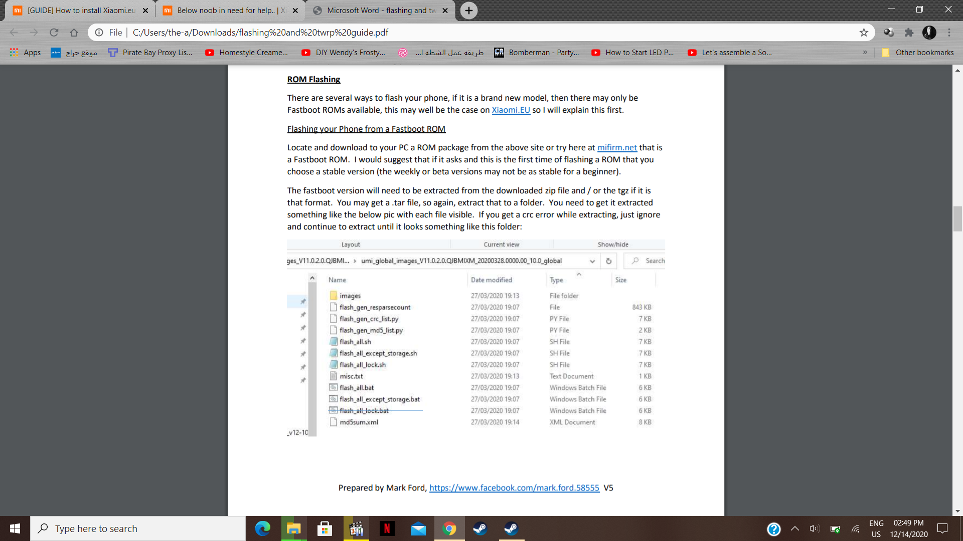

Before flashing these you need to install a new recovery partition. This currently is TWRP. You can download your version from here on the EU forum pages or Here and Here for Xiaomi phones if available.
The "here" part is not working.. I can not find the link to the recovery partition app.
Ibrahim bahakim
Dec 13, 2020
99

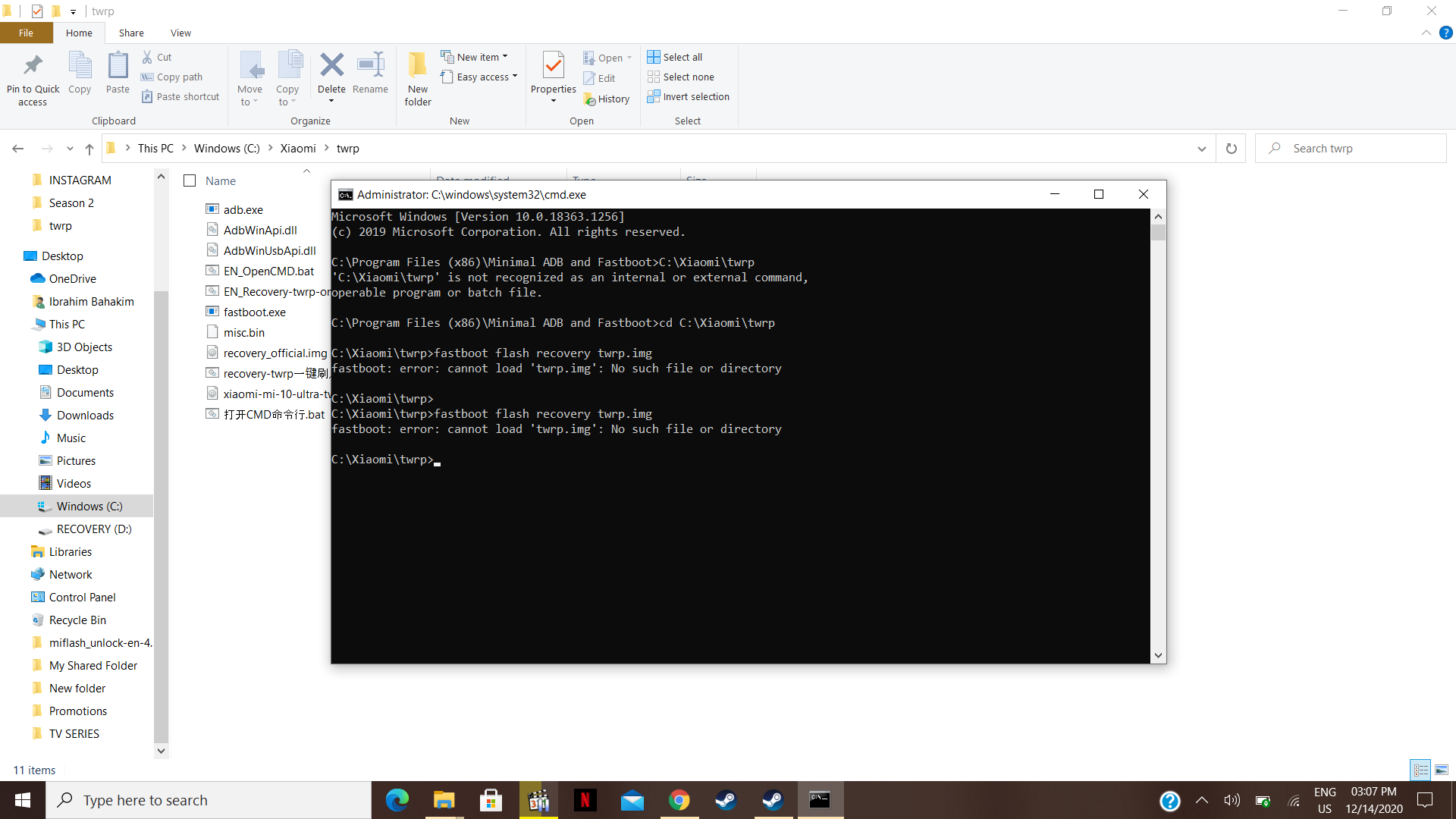

I saw which file has .img and I replaced it with your name and it did work I guess? Now it is restarted and the phone is not in fastboot... It is normal now..
Ibrahim bahakim
Dec 13, 2020
99
So what do I do now? I mean in your guide it says "This will reboot you into your newly flashed recovery partition, TWRP recovery " but I did not get anything.. The phone works normal not recovery partition app working...
The links are valid, they are gdrive links but you can always get the files from the alternative link on mifirm.net or this forum
