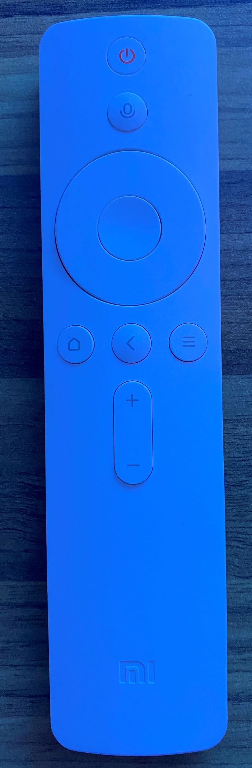

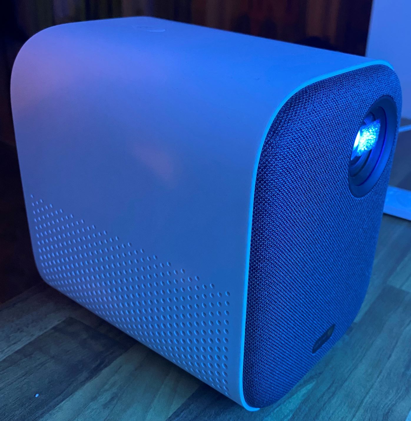

Hi Bartek,
Thanks for your reply. I just tried and it didn’t work. I am sending pictures of my projector and remote. Do you have the same?
The projector doesn't factory reset when I press and hold the buttons as suggested.
With my phone, I am able to Bluetooth scan the remote, which means that it's discoverable but it seems the projector Bluetooth is either faulty or disable since I cannot pair the remote.
Is there any other way to perform a factory reset without the remote? I even tried to plug a USB mouse and keyboard to see if I can access the projector's setting but I am stuck on the autofocus screen and cannot browse any further.
