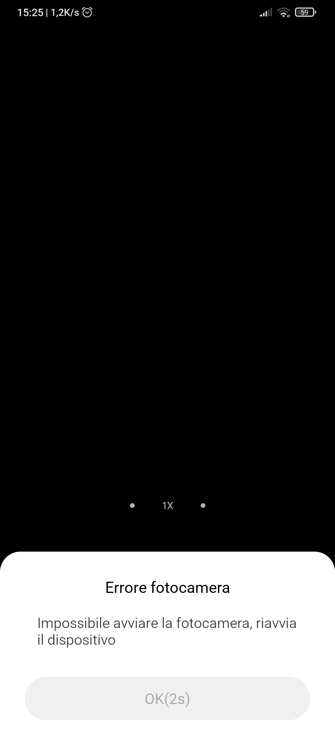

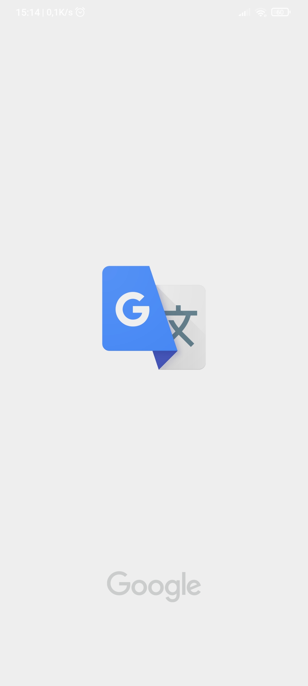

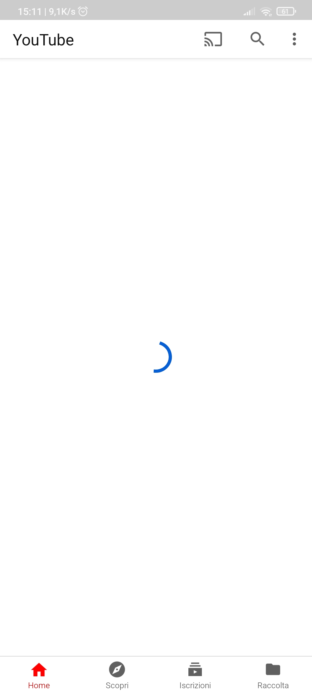

Just today I flashed the new (9 September 2020) version of the rom xiaomi.eu_multi_MI10LITE5G_V12.0.1.0.QJIMIXM_v12-10, before that I was on the previous version (I think it was published 3 September 2020). The bugs that I found till now are:
  • Both the main and selfie cameras doesn't work;
  • Youtube doesn't work, even Youtube vanced doesn't work;
  • Google Translate also doesn't work.
I don't know if there are other bugs, but for now these are the ones that I found.
At least the problem with the dialer, that was present in the rom (xiaomi.eu_multi_MI10LITE5G_V12.0.1.0.QJIMIXM_v12-10 published 03/09/2020), has been solved.
Before flashing xiaomi.eu rom I was on the latest official eea rom.
Please resolve these bugs the earliest possible since they're really annoying.
Thank you for your efforts Team Xiaomi.eu,
Best regards.

Raixod could you provide a Logcat, since you are still on that ROM from 9th Sept?
Here is an introduction:
https://xiaomi.eu/community/threads/how-to-make-logcat-with-adb.18455/
I am on the less buggy 3rd Sept-version and pretty busy at the moment, cause of work and business.
Reactions: prommy
See if this log is good !!! thank you

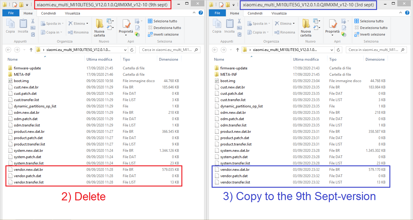

Right now I'm using a "mix" of the 3rd Sept-version and the 9th Sept-version and it's working perfectly. The dialer is working, the cams are working, Youtube and Google Translate are also working.
The only thing I did was to switch some files from one version to the other: first I extracted both versions, then I copied all three vendor files in the 3rd Sept-version and pasted them in the 9th Sept-version. After that I zipped the folder with the switched vendor files. Then I flashed the new modified rom from recovery, and voila your Mi 10 Lite 5G works with no bugs (at least until now I found no bug).

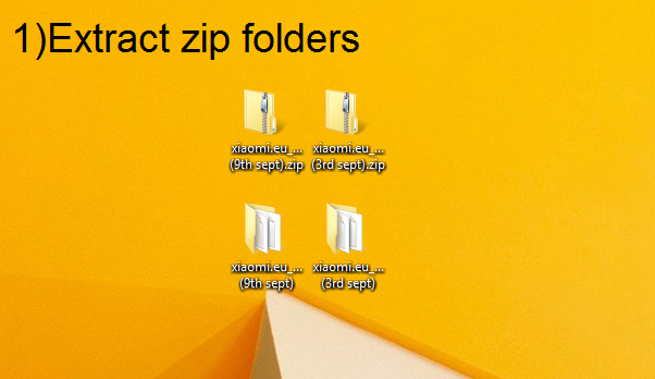

I've tried to make it as simple as possible. Follow these steps:
  1. Extract both version in your desktop or wherever you want. For easier work it’s better to have them in the same place. (Image: 1.png)1.png
  2. Delete all three vendor files from the folder of the 9th Sept-version. (Image: 2-3.png)2-3.png
  3. Copy the three vendor files from the folder of the 3rd Sept-version and past them in the folder of the 9th Sept-version. (Image: 2-3.png)2-3.png

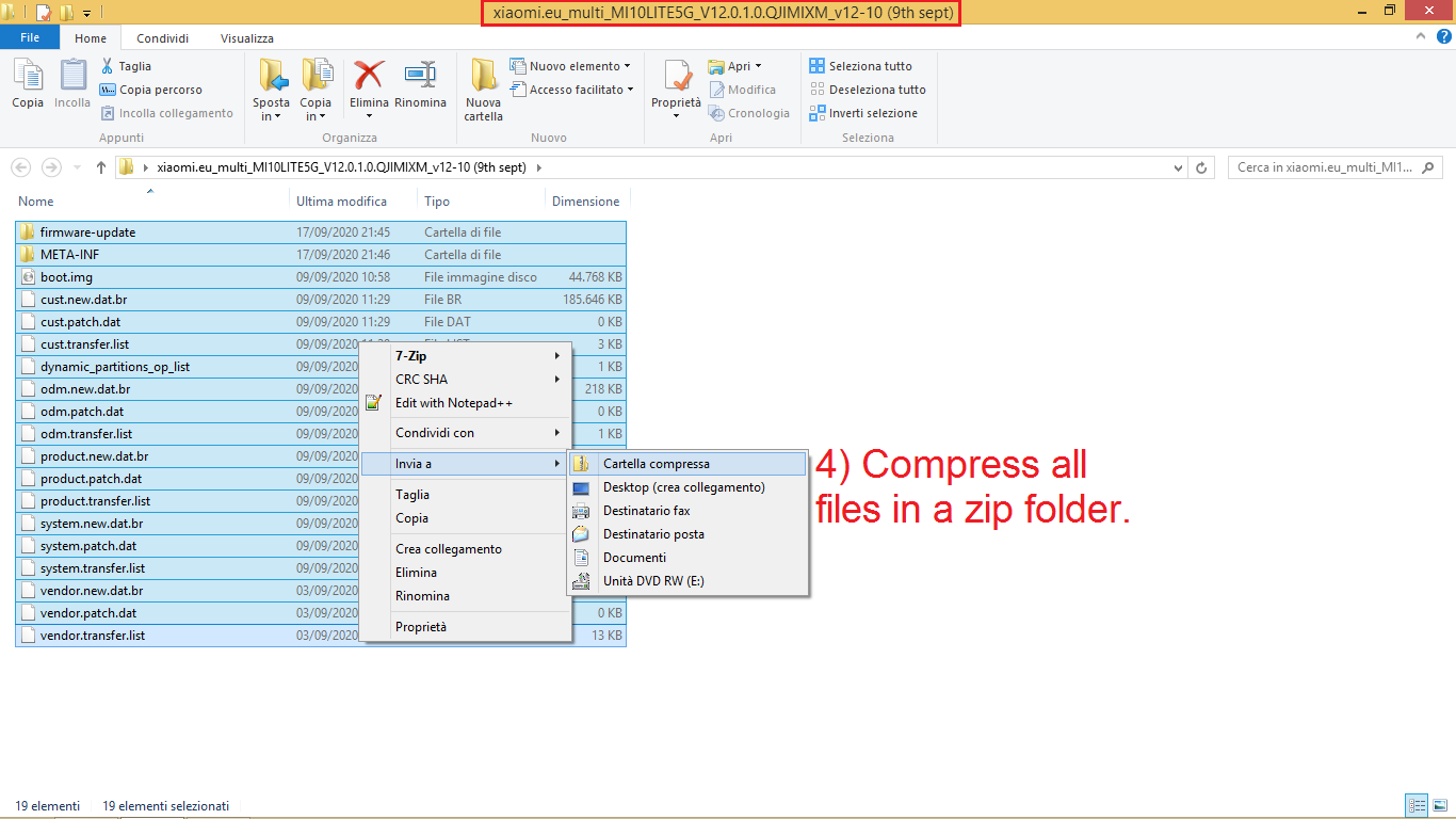

  4. In the 9th Sept-version folder select all the files then right-click and select “send to” -> Compressed (zipped) folder. (Image: 4.png)4.png

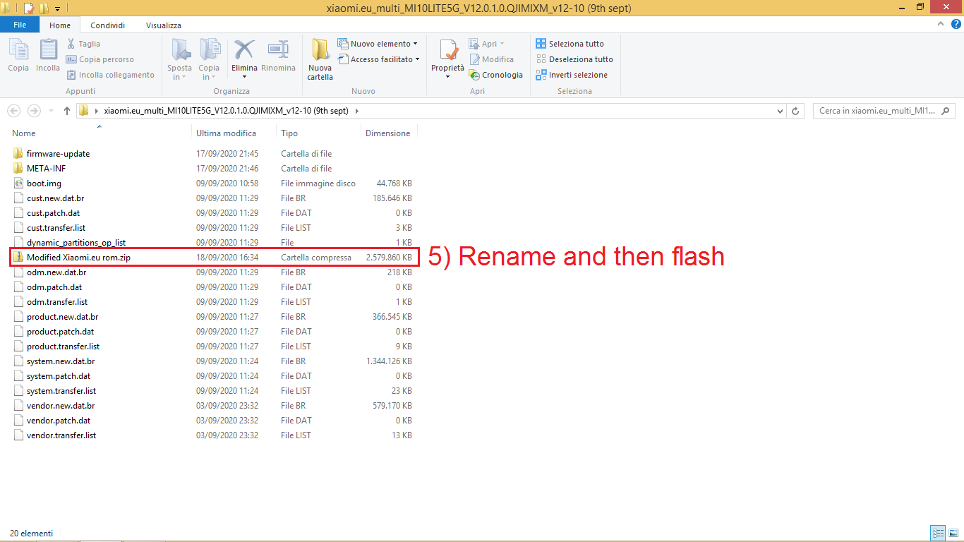

  5. Rename the newly created zip folder to whatever you like and your rom is ready to be flashed. (Image: 5.png)5.png
Like I said before I'm no developer so take what I've done with a grain of salt.
