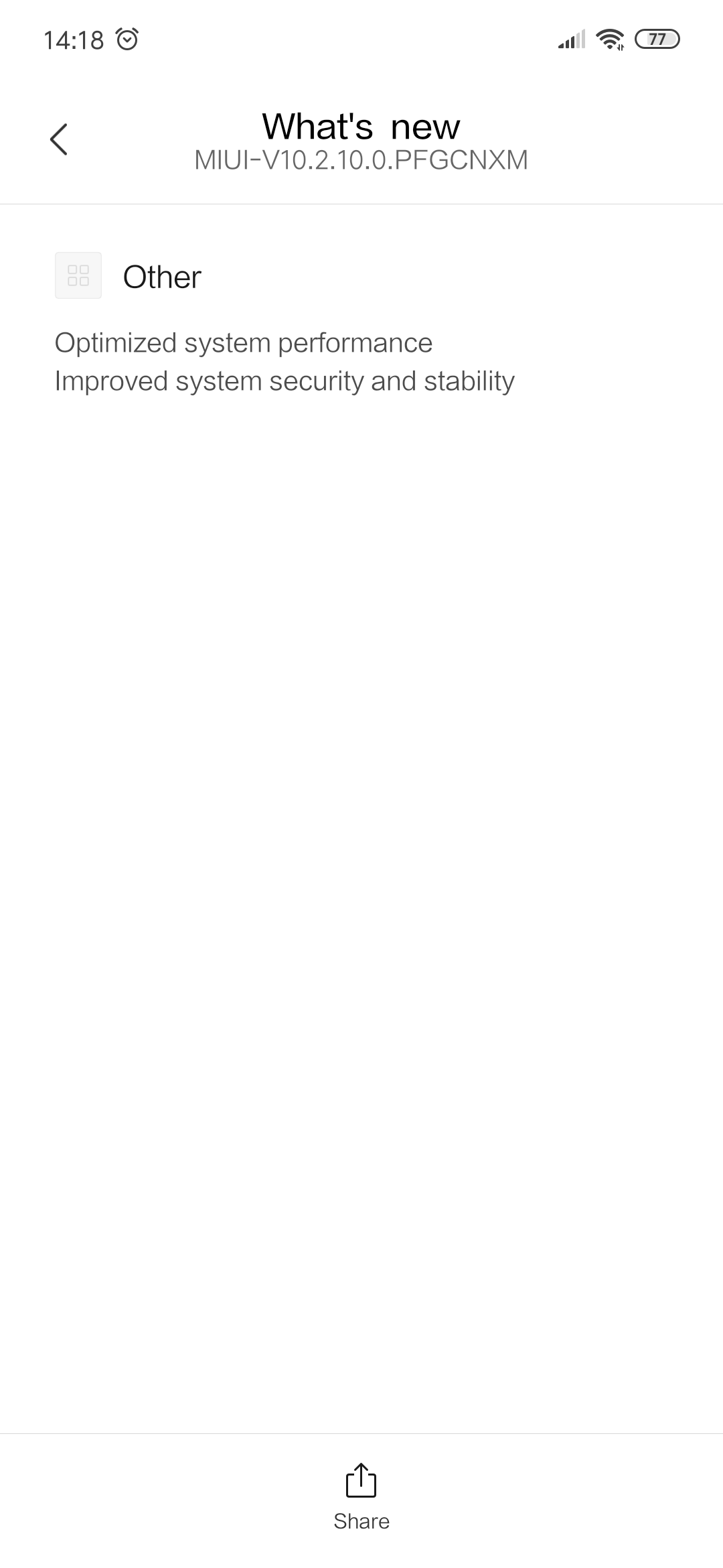

Hi everyone, I've been lurking here for awhile but now with few hours left for my unlock, something has occured to me.
I did my research and I'm now on 10.2.10 chinese version. From what I understand, I have a rollback index of 4.
Logic says that I can flash the EU 10.2.10 Rom, since it's based on the Chinese one, but better safe than sorry.
So has anyone did this, and I can rest easy that ARB protection won't kick my in the back?
