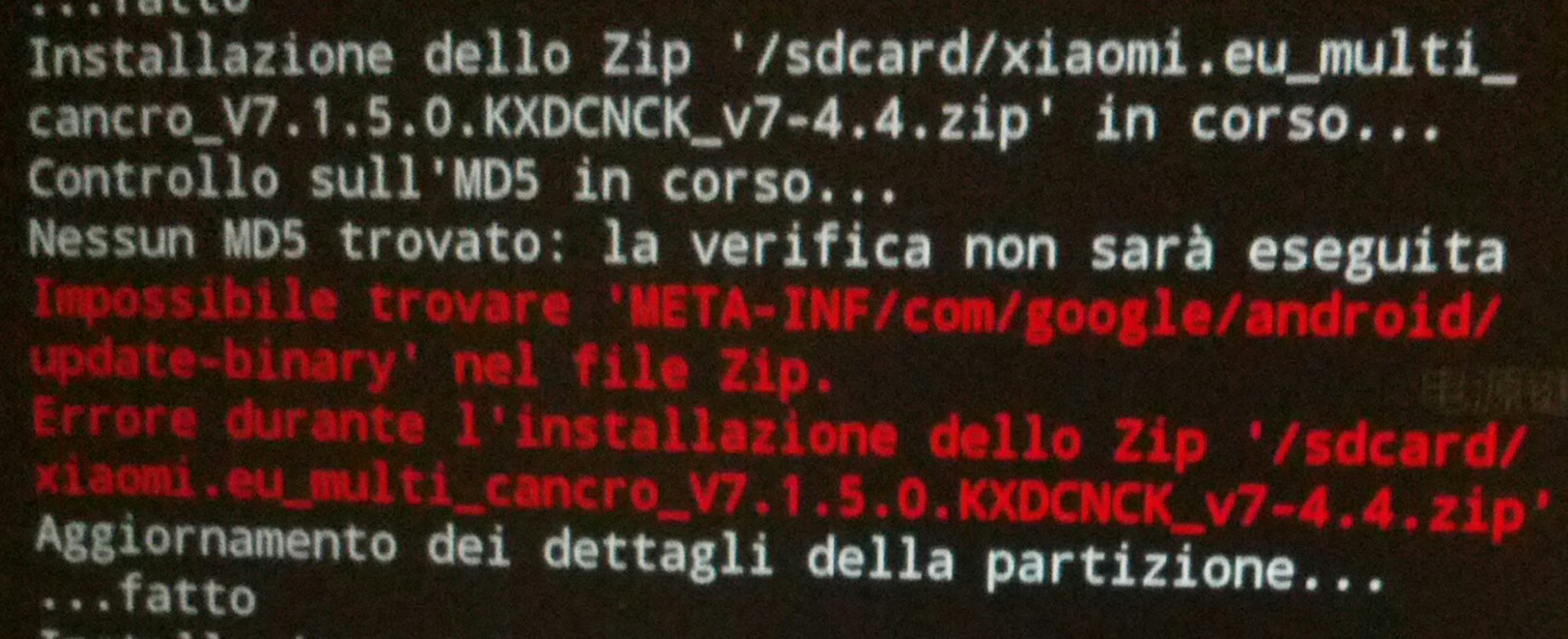

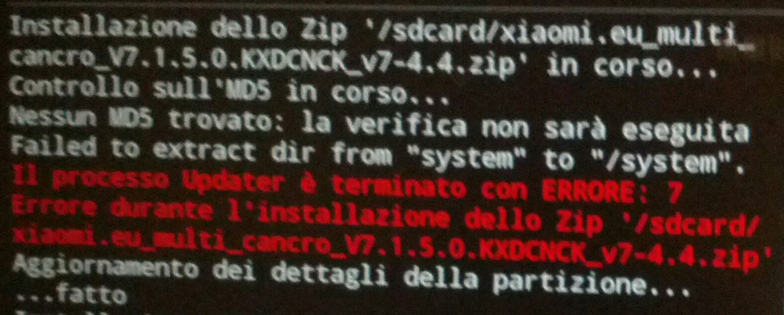

4) install zip -> always error 7 Error 7 mi4.jpg, I tried to edit "updater-script" in META-INF/com/google/android directory but the error became this one Error after file edit.jpg. I also tried to enable signature verification, mount-unmount system, keep system as read only, reboot in twrp installing supersu: all without results;

Update: Not alone.png maybe someone of you can try and verify if this is a common problem of this rom, if it is, is better to inform Xiaomi.eu staff and remove this rom from androidfilehost IMHO.

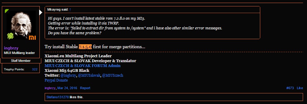

I was thinking about 1 more possibility: "xiaomi.eu_multi_cancro_V7.1.5.0.KXDCNCK_v7-4.4.zip" work with merged partition like Marshmallow, and I found this Merged partition maybe.jpg

You need the flash scripts to rebuild the dual partitions, you can find it on en. MIUI. Com and use them to flash global rom then you ll use STOCK recovery to install Xiaomi. Eu 7.1.5
