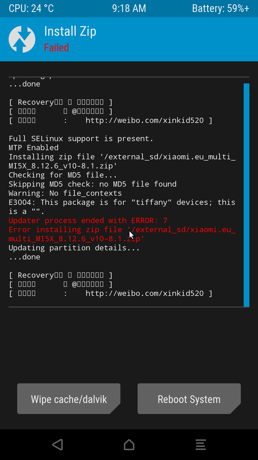

after messing around with my device I ended installing Android One but didn't like it so changed back to MIUI9.
Now I want to try the beta version of MIUI10 but whenever I'm trying to install through TWRP I get the error 7
What should I do?
Currently ROM installed: MIUI 9 | V9.5.3.0.NDBCNFA (stable)
TWRP version: V3.1.1.0

I did exactly as shown on MIUI ROM Releases, I wiped data, cache and dalvik(?) and then just installed from zip on SD Card and wiped again some stuff, then it rebooted and it's working fine.
I'm currenly using MIUI 10 812.6 v1 going to update now to version 2
