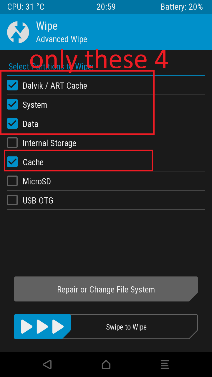

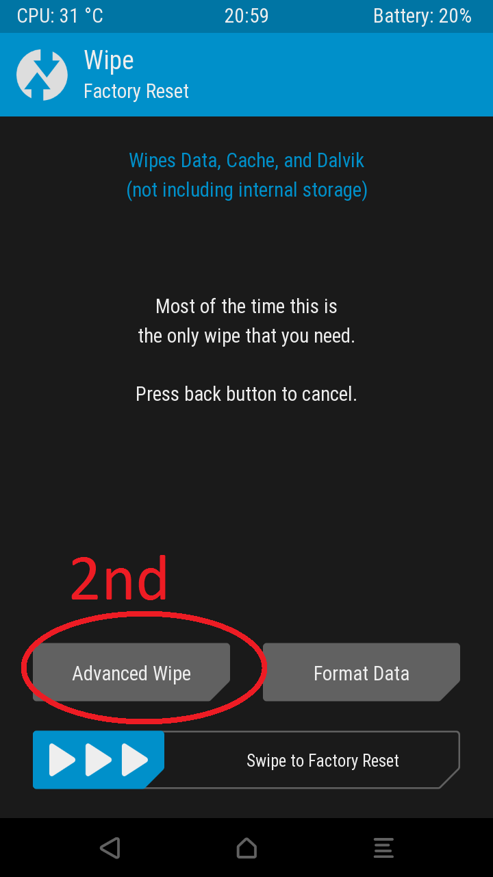

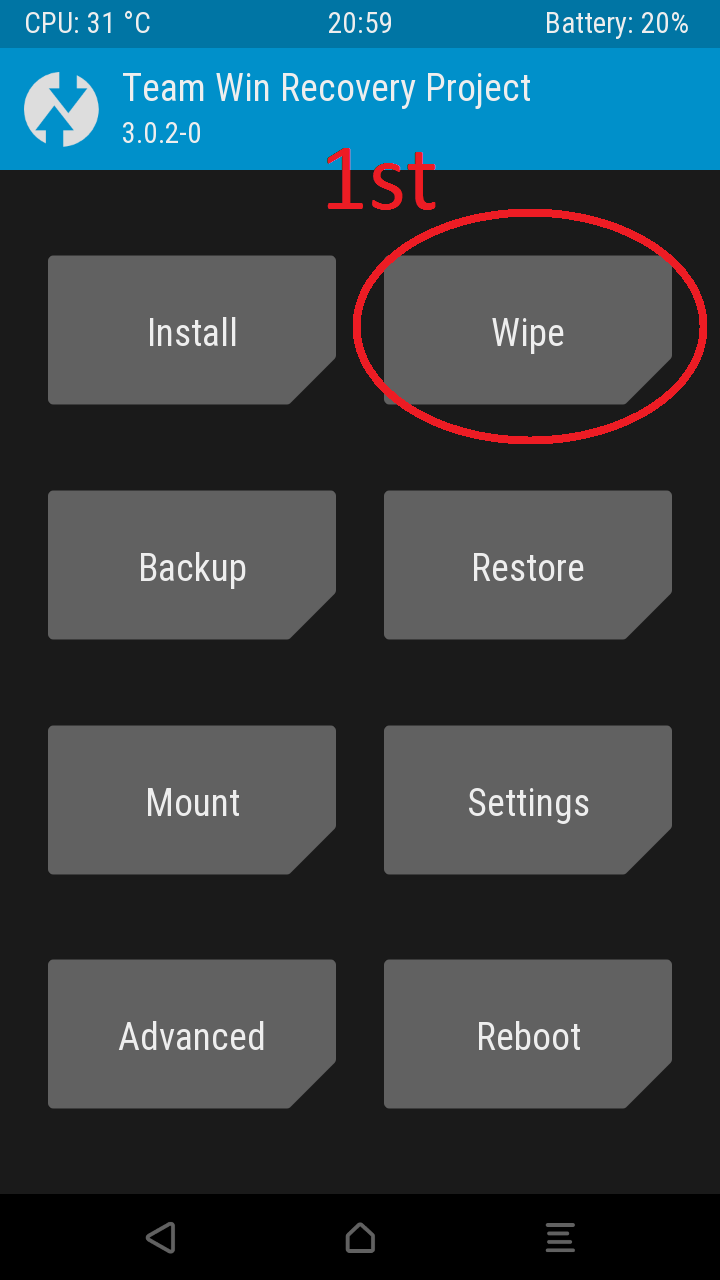

    Definiere alle Apps: Die vorinstallierten von Xiaomi oder deine selbst installierten. Wenn das zweit genannte, dann war der Wipe erfolglos
    What did you mean with "all apps". The preinstalled apps or all your manualy downloaded apps?

  6. Dingsdada
    DingsdadaMembers
    Dec 29, 2016
    7
    1
    Male
    Any manually installed Apps where still there. Factory reset seems to have failed.

    Is it safe to wipe /system on Redmi 3s? Don't you also wipe /efs partition (where your IMEI is stored, and thus vital for cellular communication) by doing that? I'm asking because I also have a Mi 5, and that's what happens if you manually wipe /system...

    By default i also wipe system for clean flash but i finded not to be a good idea because if you reboot or reboot to recovery after wiping system you end up with no recovery no android it will stuck at MI logo bootloop , and you can not turn off your phone or charge by any means ( it happend to me luckily my phone was fully charged ) !
    Yes your imei and unlocked bootloader remains safe!
    No need to wipe sytem for a clean fresh install , because the instalation process will do it also ,i sugest not to wipe system ,only dalvik cache , cache ,and data to remove old installed apps and settings !

    I installed the 8.1.4 on my wife's 3s 2/16 some weeks ago doing full wipe included system and internal storage. IMEI safe, no problem.

    can i wipe "internal storage" bevor clean install - or are there some important files?

    No problem wiping internal storage, that's where your personal files are stored. Just take into account that any files you have there will get wiped - so, if you have the ROM .zip stored on your phone storage and wipe internal storage *before* flashing the ROM, you'll have to copy it to internal storage again to be able to flash it :)
