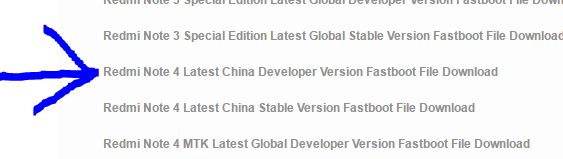

    Picutre tells the whole story... I did try everything I found on google, but with no luck... Can anyone help me?

    Yes, that's what I did as I couldn't find the Global Developer ROM

    Use the fastboot version & use SP flash tools in that guide. Once you have flashed China developer make sure to singn in with Mi Account & enable the unlock under developer options as that's where most people go wrong.

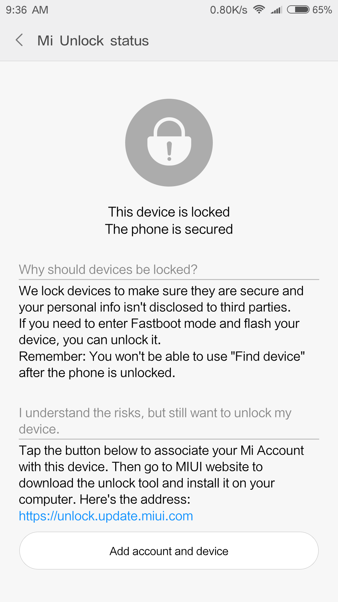

    You have it, it's under Mi Unlock status.

    Looks like they changed it to the previous screenshot I posted., Have a look there.

    That button doesnt help either..

    Add Account & device

    ye, already tried, doesnt help

    wowow, tried it once more, just because of madness and I got phone unlocked, thanks for your interest helping me
