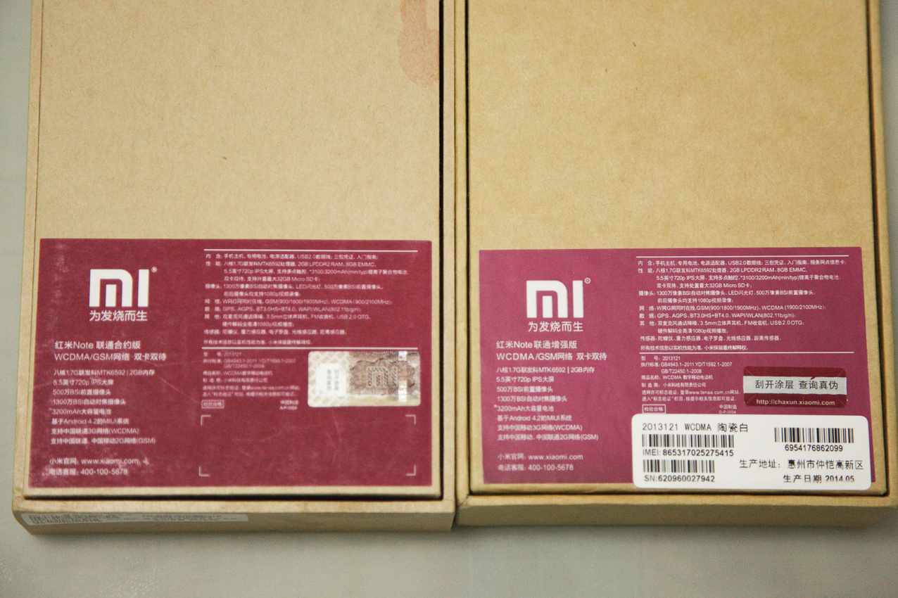

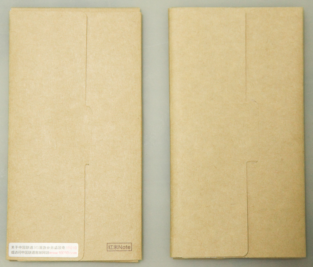

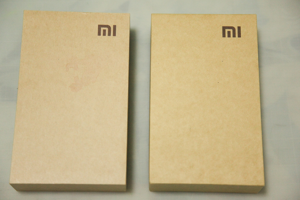

1 BOX - Real: box edges are sharper.

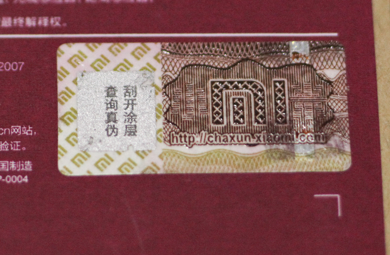

2 SEAL - The real one is sophisticated and has structure. The fake one is just a flat ordinary sticker.
real:
Fake:

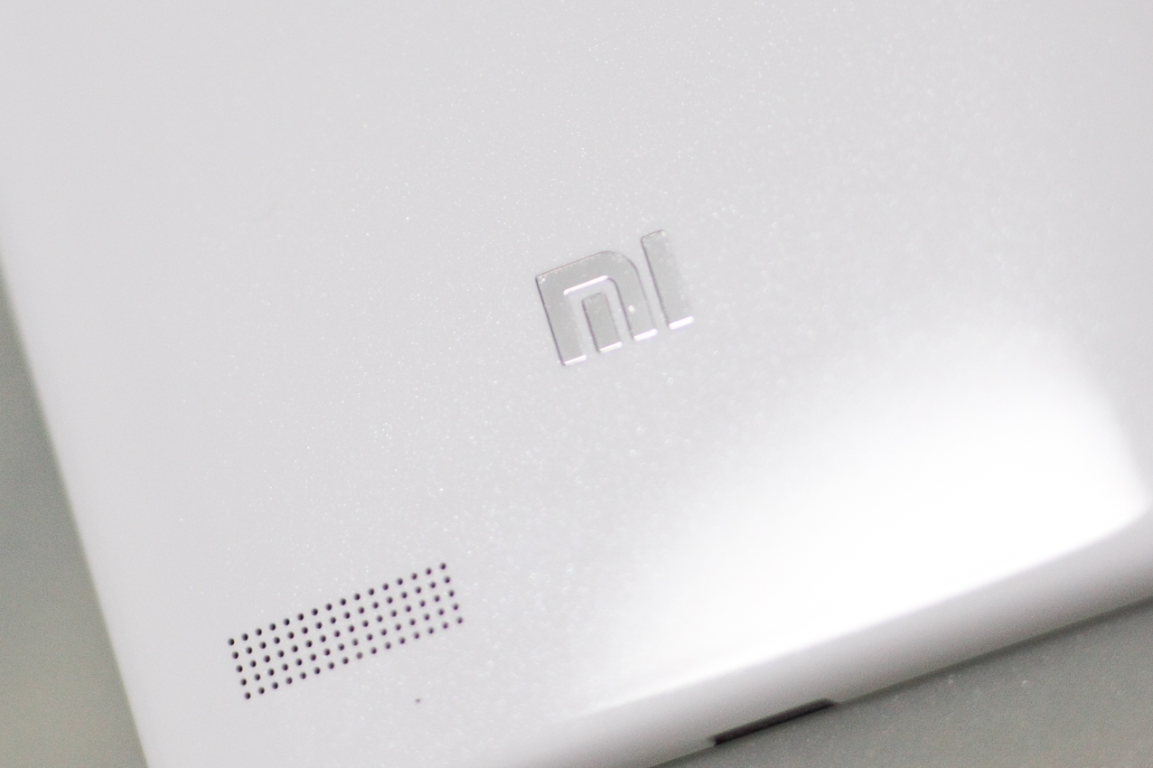

3 BACK COVER - real: snow white with sparkles, fake: dull and off white

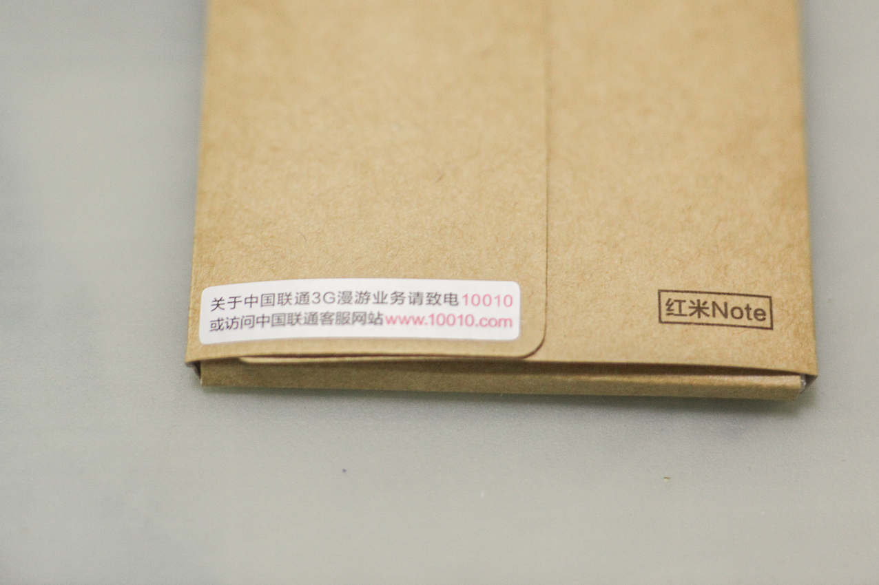

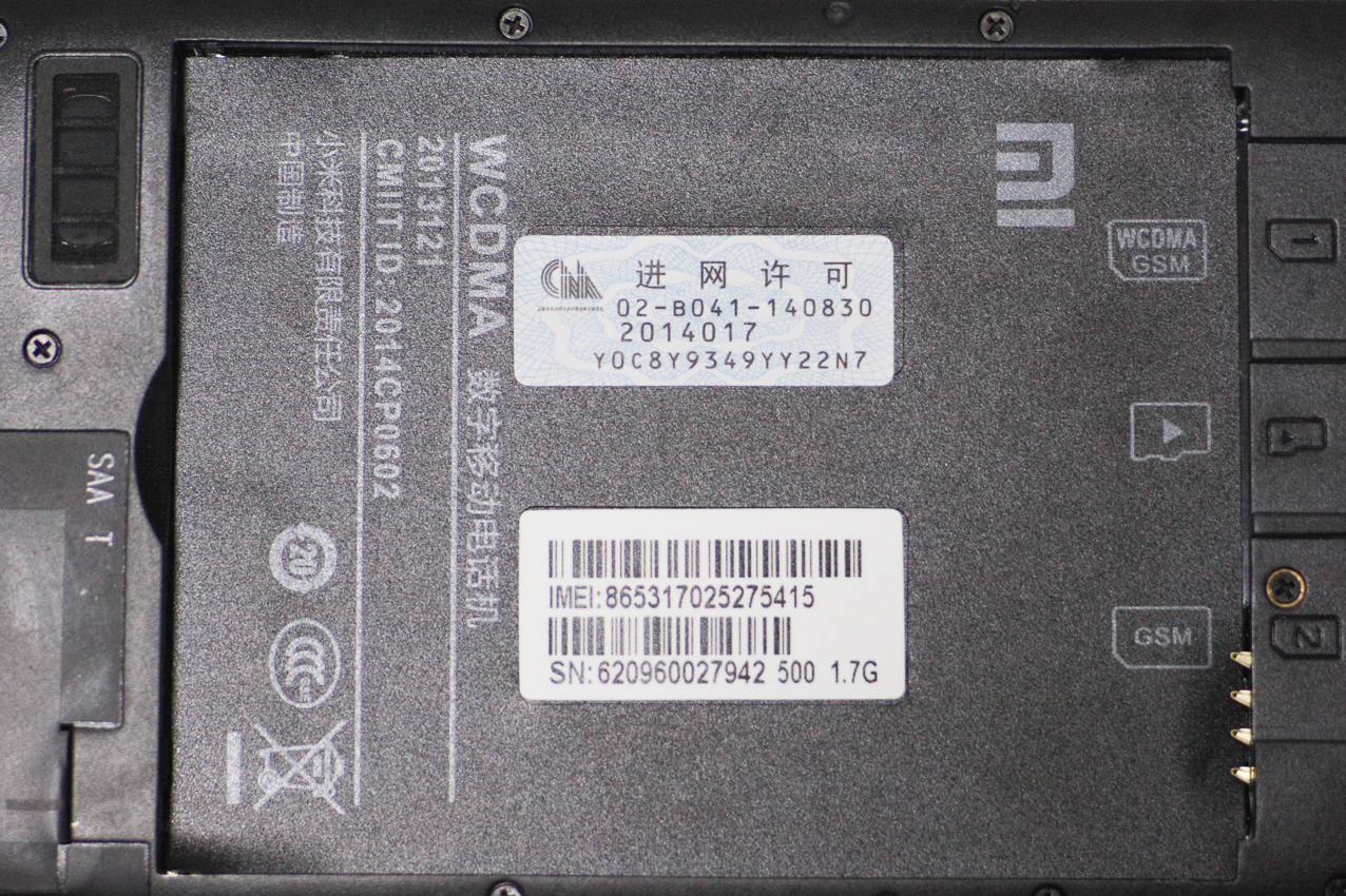

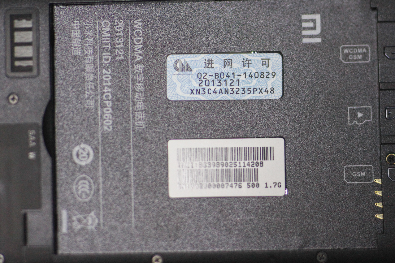

4 SEAL INSIDE THE PHONE - Real: structure, Fake : flat
real:
fake:

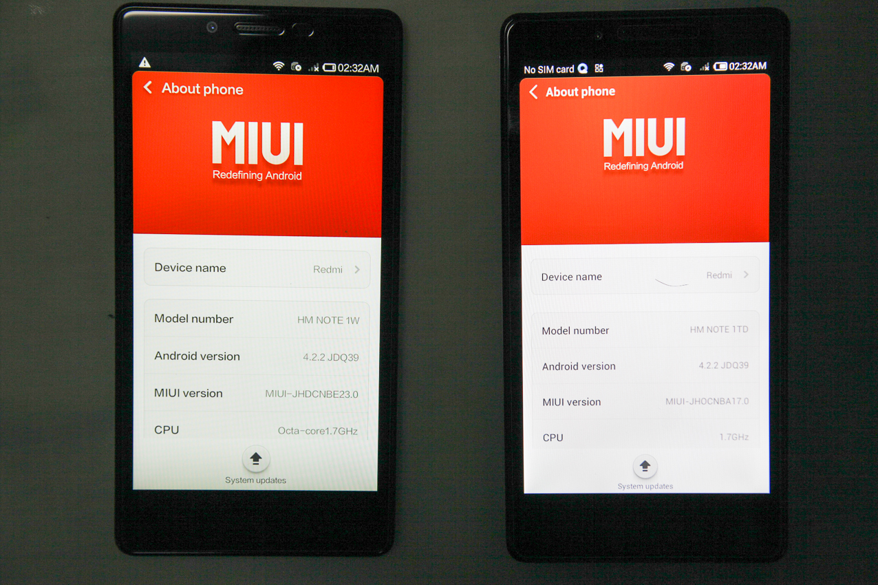

6 ABOUT PHONE - make sure is HM NOTE 1W (wcdma: global) and not HM NOTE 1TD, TD SCDMA is for ASIA use only. Check carefully if the phone is really a octa core with 1.7 GHZ, 2 Gig RAM. and 8 GB storage. Depends on what you are buying. You can't depend on the EMEI code which is printed on the box and what is showing on the screen.

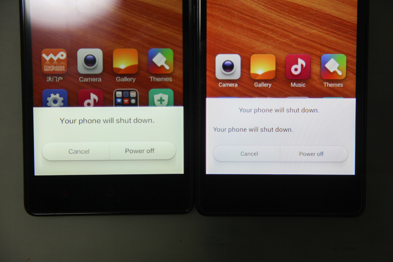

7 SHUTTING OFF THE PHONE: Fake: 2 x Your phone will shut down.

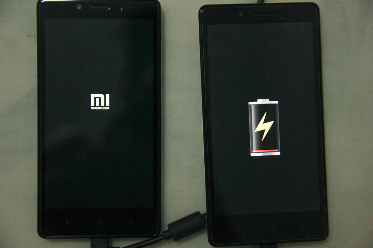

8 CHARGING SWITCHED OFF PHONE: first XiaoMi Logo and then battery, Fake: immediate battery

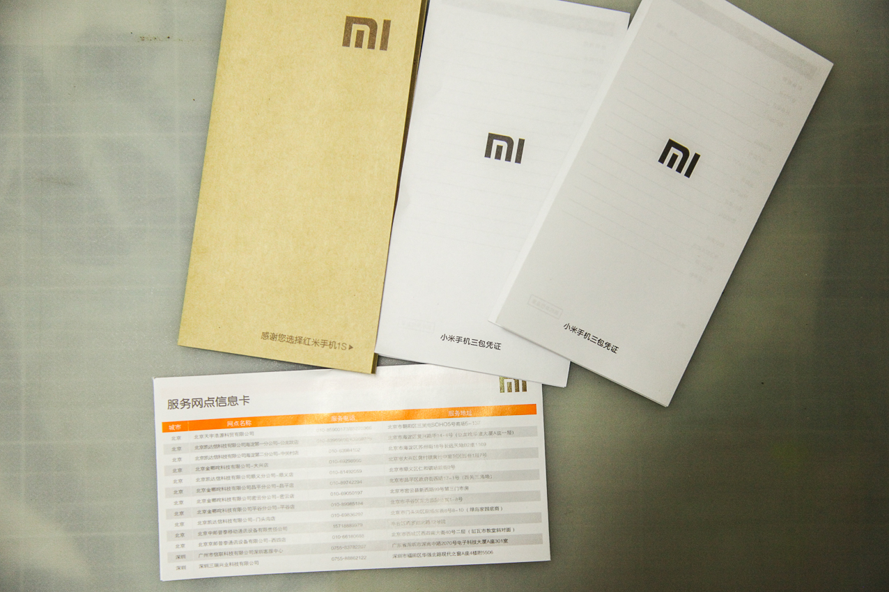

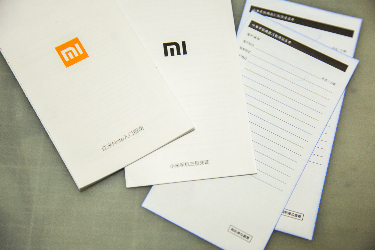

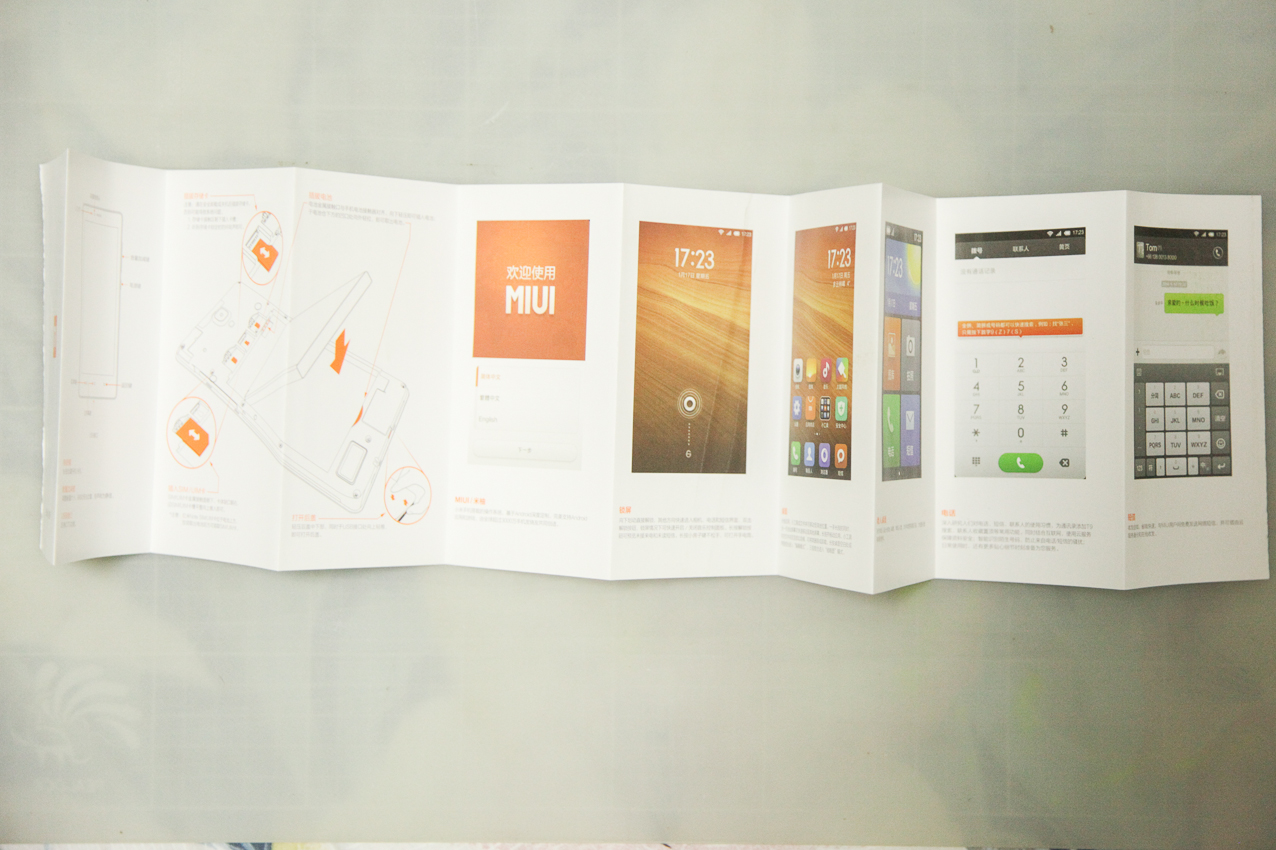

9 MANUAL - REAL: uses shiny paper with coloured photos, Fake: uses matte paper, 2 x red mi s1 manuals, no coloured pictures
real: IMG_1904.jpg IMG_1896.jpg IMG_1901.jpg
fake: IMG_1897.jpg

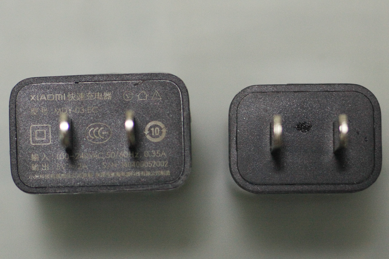

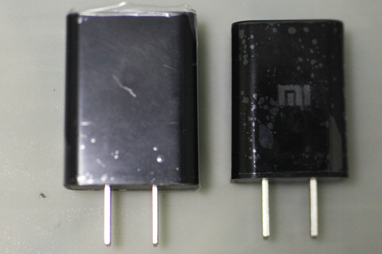

10 CHARGER - Real one is bigger and has inscription on the pin side.
