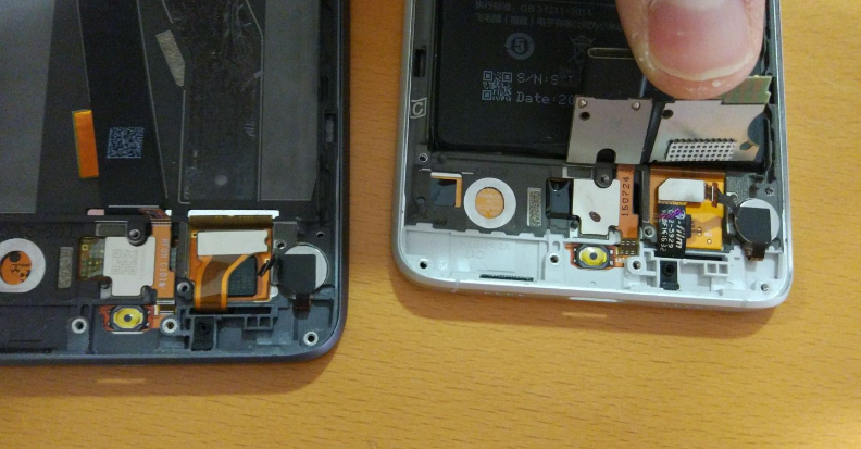

Hi, I bought a Xiaomi Mi5 in December 2016 (Banggood) and a day suddenly the screen turned black. The phone is on but the screen seems to be dead.
I open the phone to replace the screen but the connector on the screen is different from all I've seen for sale. All screen replacement for Xiaomi Mi5 screens are different to mine.
I send to you a picture where you can see the difference between the display connectors on my phone (right, white) and another Mi5 (left)
Can you help me to find a replacement ?
Thanks.
All i know, there are 2 different screen types for MI5. You can read on XDA developers the TWRP thread, there it is mentioned and also the way how to check wich type you have.
Thank you. I have already found it. The way to know the type of screen that is needs I can use the mobile.
