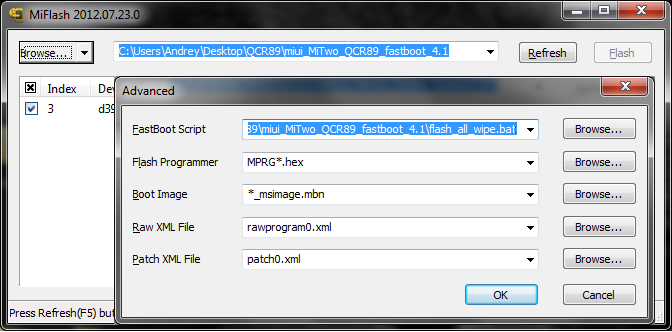

U have to choose with wich fast boot script (*.bat files) you want to flash! In each ROM there 3pcs of them:
1) flash all wipe - delete every thing in phone!!!!! (don't use it!!!)
2) flash_all_except_storage
3) flash_all_except_data_storage
So! You have to choose how you want to flash ROM via MiFlash!!! It's easy!!! :p
My screenshot, when i was flashing QCR89 (stock JB 4.1.1)
