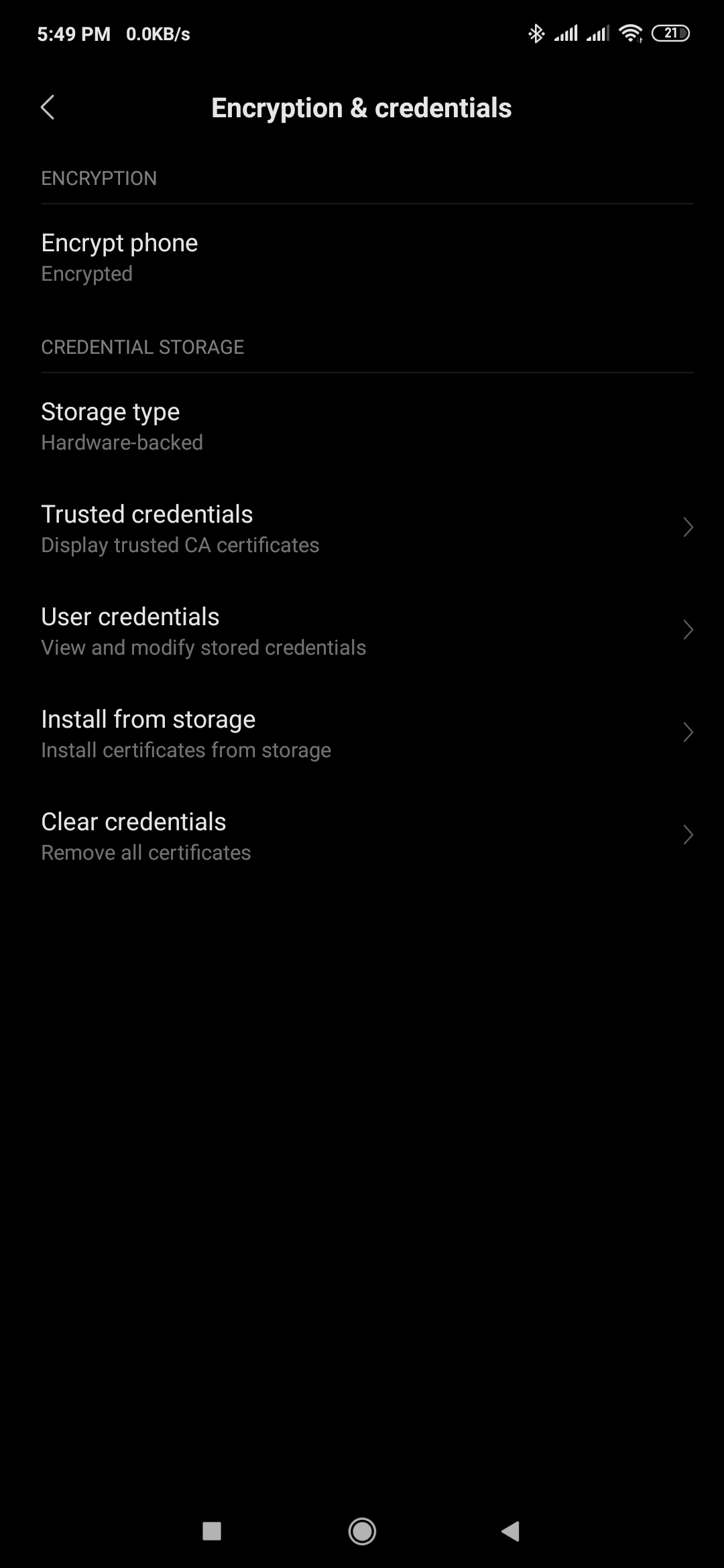

My phone says it is encrypted (as shown) do I need to do anything before flashing Eu rom? If so, what should I do? I am using global from that is flashed from china rom after unlocking
24599
My phone says it is encrypted (as shown) do I need to do anything before flashing Eu rom? If so, what should I do? I am using global from that is flashed from china rom after unlockingView attachment 24599
You'll need to boot into TWRP recovery, it will prompt you for your lock screen password to decrypt your partitions.
Then Wipe > Format Data button. All your data and storage will be wiped of course, so make sure you've done your necessary backups.
(NOT Wipe > slide to factory reset, as this won't remove the encryption which is required to install xiaomi.eu ROM)
Transfer xiaomi.eu (and optionally magisk) zip via USB in TWRP, install it (and magisk zip if you want root) and you're good to go.
Please, why do you ask to format data?
If TWRP ask for pin PW and accept it, dencryption will be done and at this point you just have to load the new rom zip and to install it.
Then after reboot phone will encrypt again in order to protect your data as mandatory.
This is the normal TWRP behavior when it works well as it is the case with this phone.

It's required to remove encryption completely to install xiaomi.eu ROM when coming from native MIUI ROMs. You'll need to setup new encryption in xiaomi.eu ROM (done for you when you set a new lockscreen password). If you try to install xiaomi.eu ROM without doing this, the install will fail in my experience.
Format data button doesn't just decrypt the phone it removes the encryption security information (i.e. your encrypted lockscreen password) which is important when you move to Xiaomi.eu ROM. If you factory reset, it doesn't do this, which is misleading that it uses the term 'factory reset', a state where normally there is no password set. This is why I was pointing out to you to use the format data button and not factory reset option. It's just the English terminology which needs better clarification in TWRP.

Apologies for not writing enough about the academic technicalities behind the various types of wipes in TWRP.
Just to repeat for clarity, you only need to use the format data button (wiping your locksreen credentials) when coming from a NATIVE MIUI ROM (that's china, global, developer) to xiaomi.eu ROM, not when you already have xiaomi.EU installed. When you are upgrading xiaomi.eu you have options of dirty flash (install without any wipe), or clean flash (install with 'factory reset' as TWRP calls it - wiping cache, dalvik, data partitions).

I get the phone with China from installed. And then decided to change to global rom. Then after using global from for a while I wanted to change to Eu rom, thus I posted this.
If I remember correctly, The official xiaomi mi9 global rom do have dark mode.
