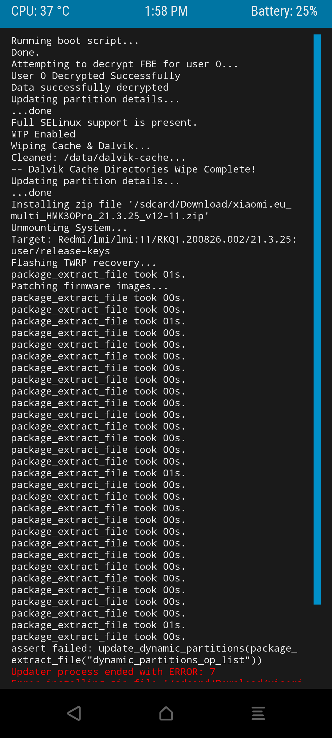

Eror 7 update rwrp
Spill
Mar 5, 2020
24
ו have the same eror 7
No matter what update I am trying to install
Same here.
Error 7 with twrp 3.5.2.0, 3.5.1.0 and previous twrp versions.
It only works with the chinese twrp "3.4.2b-1206-K30Pro-wzsx150".
I tried a full reset off the phone (factory reset, delete/format all except system-partition) but the recommend twrp doesnt work.
Any ideas/solutions?
Redmi K30 Pro

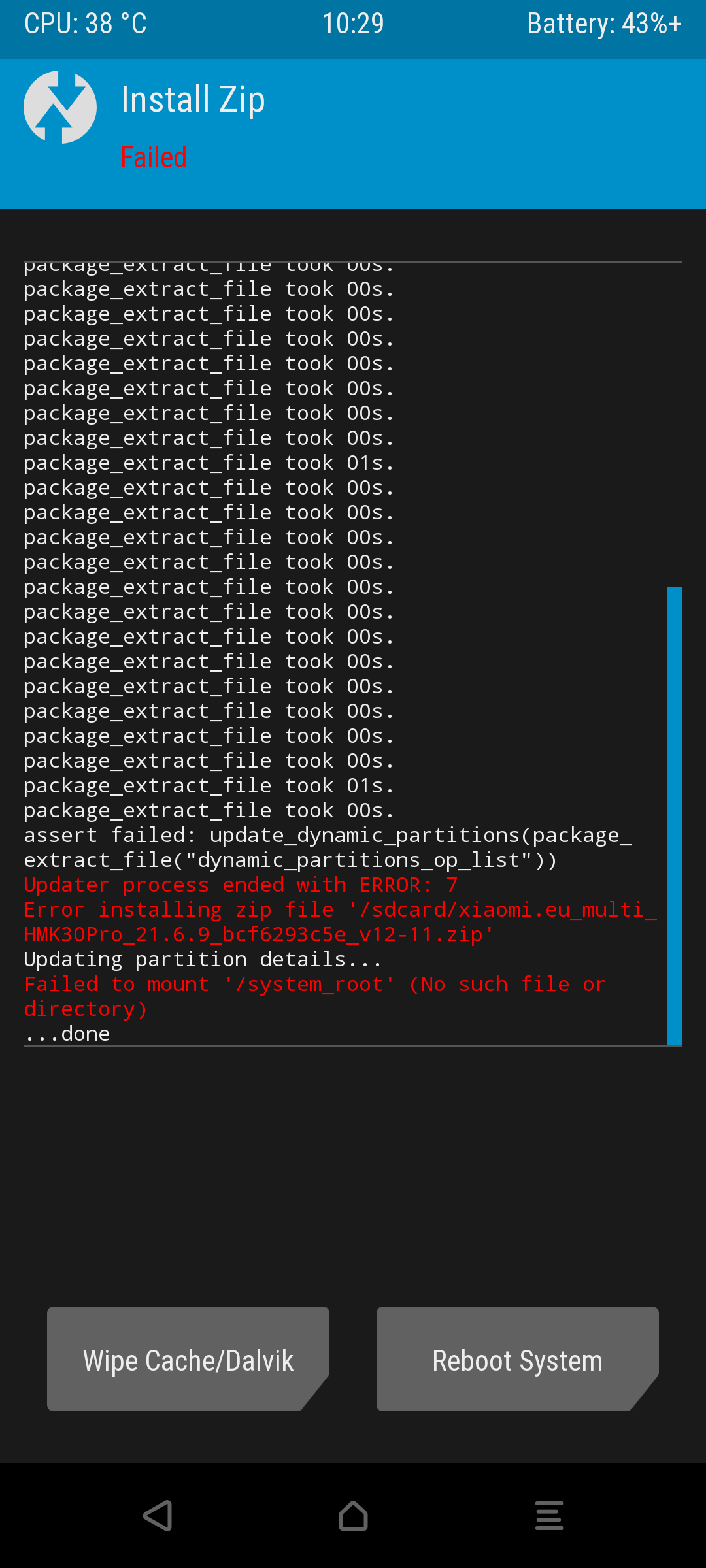

search in the EU_weekly ZIP File... the recovery.img and delete it in winrar.
your recovery, remains
...or (re)flash twrp "3.4.2b-1206-K30Pro-wzsx150"...after flash Rom

@hofi01
And thats the fix for this error? Thats a workaround, no fix.
Also its the weekly rom. Theres no recovery.img.
Poney70
Donator
Oct 3, 2019
4,535
337
@hofi01
Solution is to format data in the newer TWRP...
If it still can't install a ROM, format data again and retry ROM installation (until it works).
