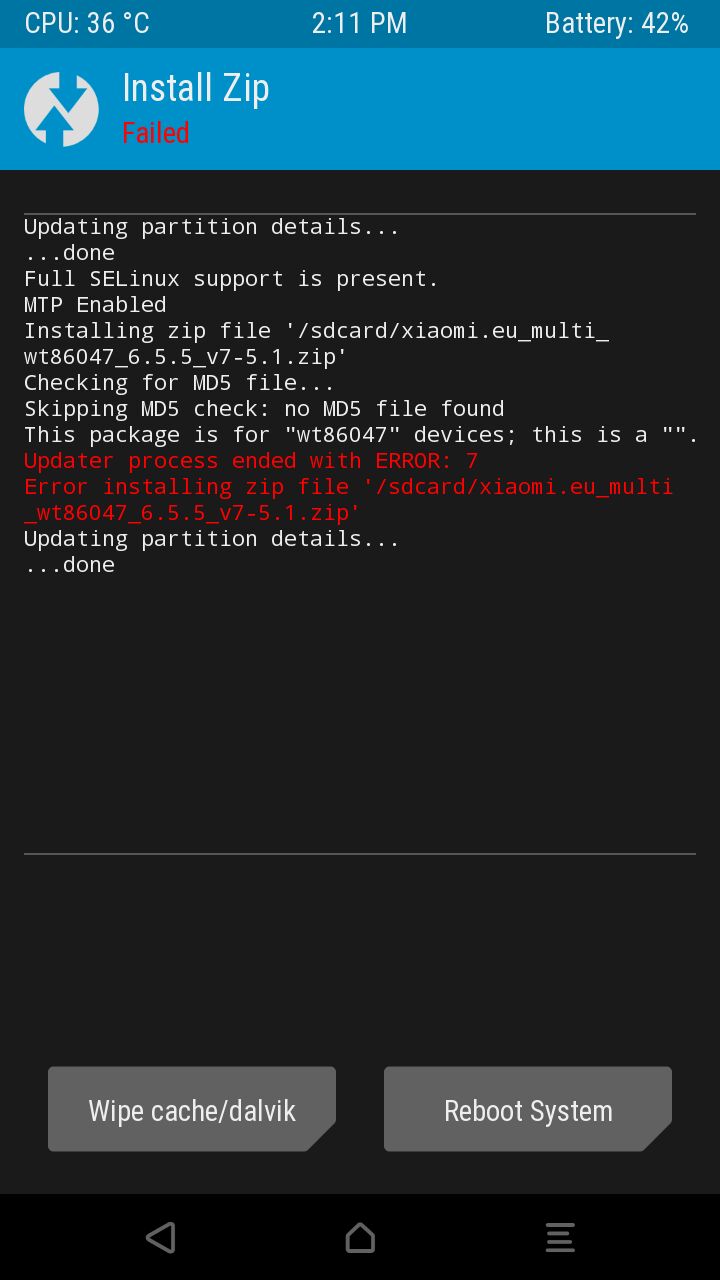

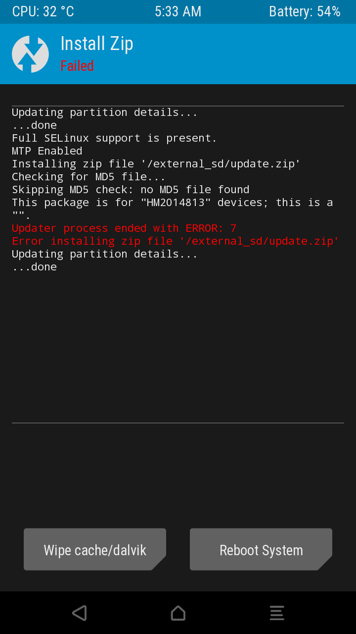

    I tried to install new MIUI Weekly release 6.5.5 or previous whit TWRP but I've this error:
    I tried to wipe the storage, but it didn't work. I've got a Redmi 2 Pro and there is MIUI 6.3.3 .
    Error is:
    "This package is for "HM2014813" devices; this is a "";
    Updater process ended with ERROR: 7
    How can I resolve?

    Switzerland
    It would seem that you have not downloaded the ROM right
    Sembrerebbe che non hai scaricato la ROM giusta

    I tried to download different ROM version for HM2014813 that corrispond to Redmi2 PRO and now the code is wt86047. This isn't the first time that I tried to update the ROM version, but since I installed the 6.3.3 version there is TWRP recovery to update (before there was a different recovery and there weren't any problems).

    Sounds like something is messed up with your build.prop....
  6. ingbrzy
    ingbrzyXiaomi.eu Multilang leader

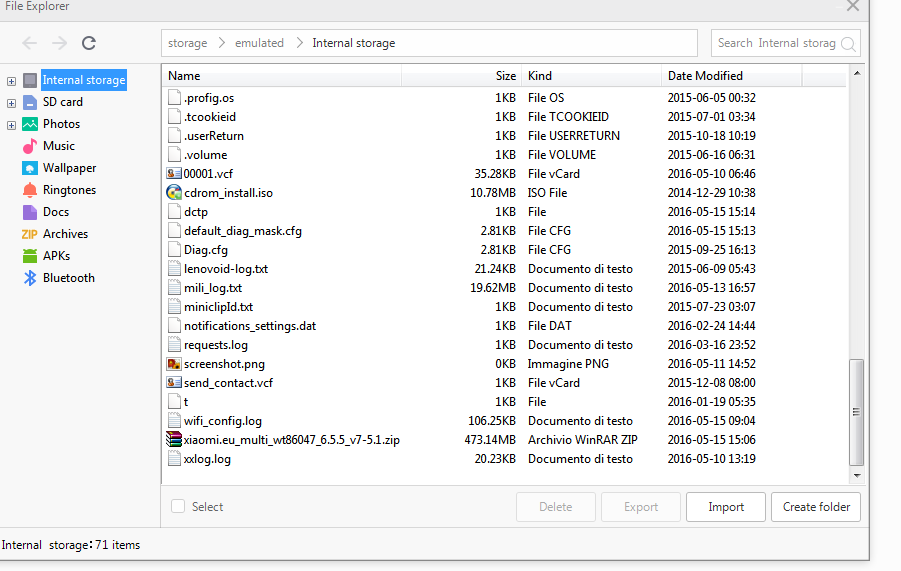

    Staff Member
    Copy zip into internal storage.. Not SD card..
    ~Tapatalk Mi5~

    Male
    It is into Internal Storage but the error now is:

  8. ingbrzy
    Staff Member
    Update your TWRP..

  9. lollo23
    lollo23Members
    May 10, 2016
    8
    0
    Male
    I installed TWRP and the update (xiaomi.eu_multi_wt86047_6.5.5_v7-5.1) in the log has been successful but after the reboot system, the screen is blocked on the written "MI" "mi.com" by at least 1 hour...
