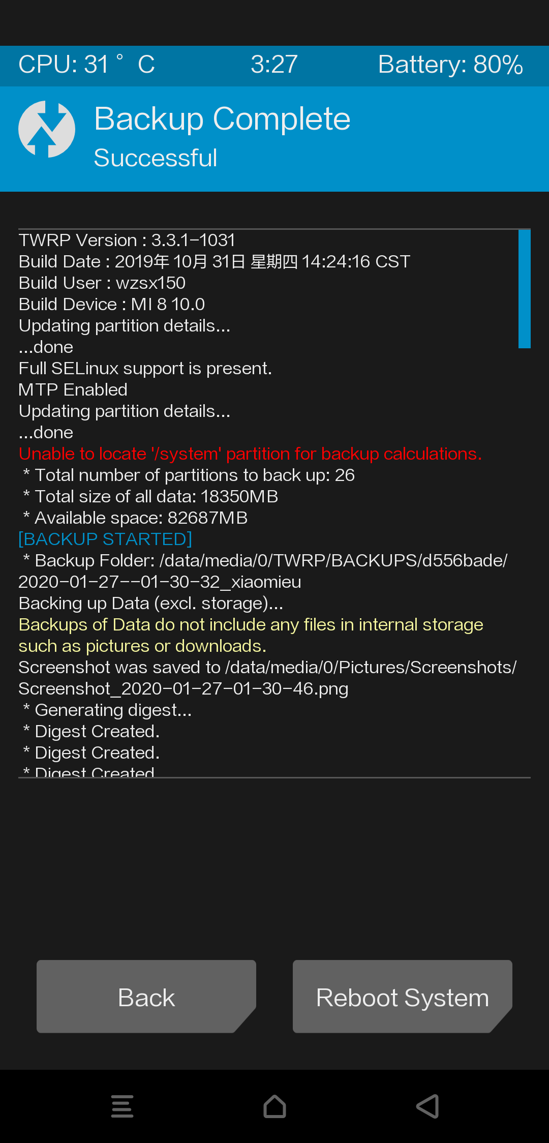

hi guys,
i successfully upgrade my TWRP to TWRP 3.3.1-1031 by wzsx150. however i have error as described:
Unable to locate '/system' partition for backup calculations.
i never had such error when i was in TWRP 3.3.1-1002 (from wzsx150 as well). any idea ? any feedback / insight is much appreciated.
Thank you.
PS: i'm currently on xiaomi.eu 11.0.6 Android 10.

Try OrangeFox TWRP => https://files.orangefox.tech/OrangeFox-Stable/dipper/OrangeFox-R10.0_4-Stable-dipper.zip
EDIT: Better to extract "recovery.img" file from zip and use fastboot command to flash it. Then copy zip file in phone's storage and flash it via OrangeFox TWRP to fully install it.
