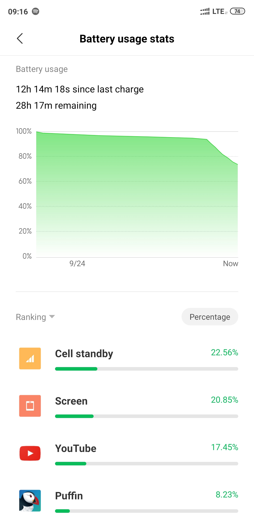

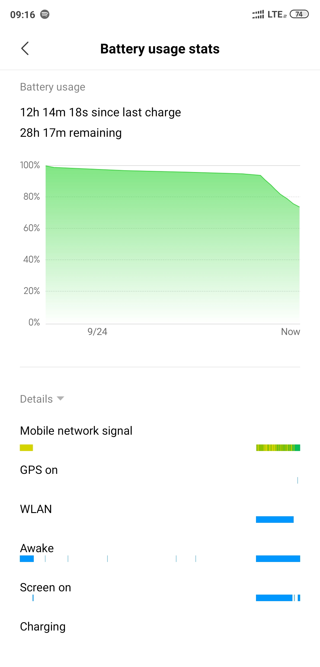

Extremely high "Cell Standby" battery drain
  • Thread starter ⫷ CRƎΛT1VE_ ⫸
  • Start date
⫷ CRƎΛT1VE_ ⫸
Cell Standby is even higher than Display.
I read that it's a problem with the baseband firmware on the Chinese Mi8 in the Global markets. I have a Chinese Mi8, which I'm using in Germany.
Can I do something to lower the drain? Or can the xiaomi.eu team do something against the high drain?
Thanks in advance!
EDIT: I forgot to mention that my device is in Airplane Mode during the night (not automatically enabled through the System Tasks toggle in the settings app.
