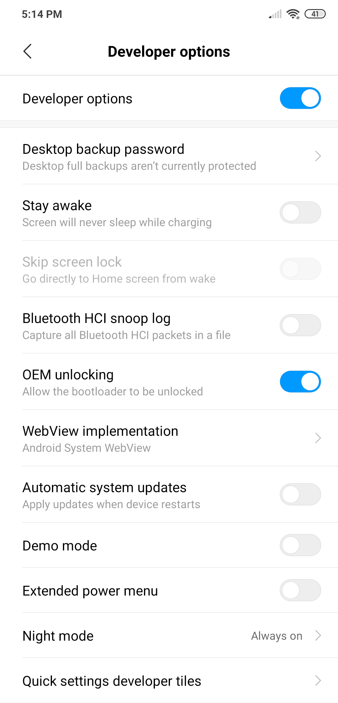

You did unlock your Bootloader, right?
To be more precise, by using mi unlock tool?
If so, ensure you have current mi usb drivers or use Linux / Mac, almost all Fastboot binaries should do it, especially if the device is recognized in the first place.
So, if your recovery image is the right one.. It should work... Take care of the file name, no spaces, not too long, ending .img.
Try again

bootloader is really unlocked? with unlock sign at boot screen?
Sorry, that was a typo in my post. Yes, I type "recovery" NOT "recover" but I understand you want to make sure. Also, the bootloader is for sure unlocked, yup, have unlocked symbol when first booting, and I have already flashed 2 roms to this phone before, read bellow for more info. So, a little more backstory, I didn't put this in the original post because I was not trying to make it too long.
