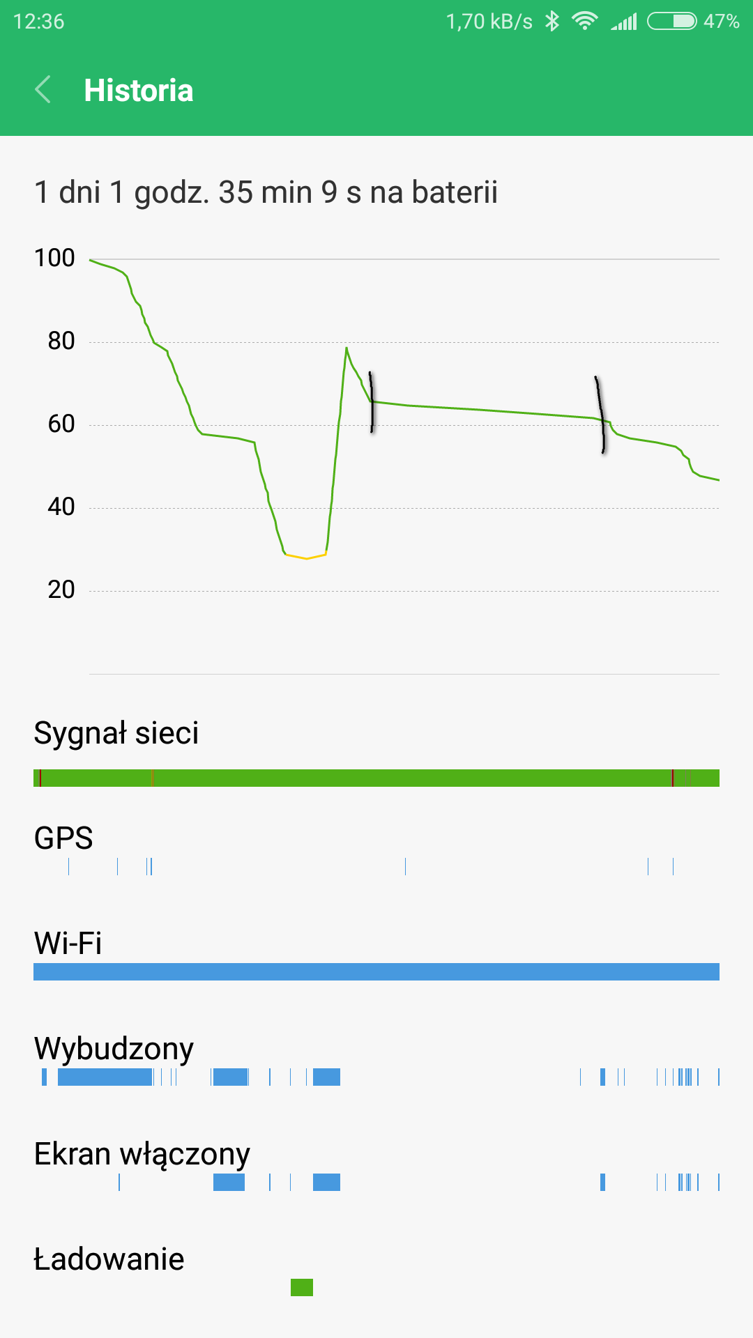

  6. Foriusz
    ForiuszMembers
    Dec 16, 2016
    11
    0
    Male
    Thats mine with alwalys on, marked time is when I slept. Looks like a normal % loss on my unit.

  7. rap ako
    rap akoMembers
    Feb 1, 2015
    0
    Male
    #8rap ako,Feb 2, 2017
    Any other have data about battery life?

  16. rap ako
    rap akoMembers
    Feb 1, 2015
    0
    Male
    can you post another batch of screenshot of your standby drain overnight with fingerprint always on?

  24. rap ako
    rap akoMembers
    Feb 1, 2015
    0
    Male
    Experienced battery drain with it, and reflashed rom
