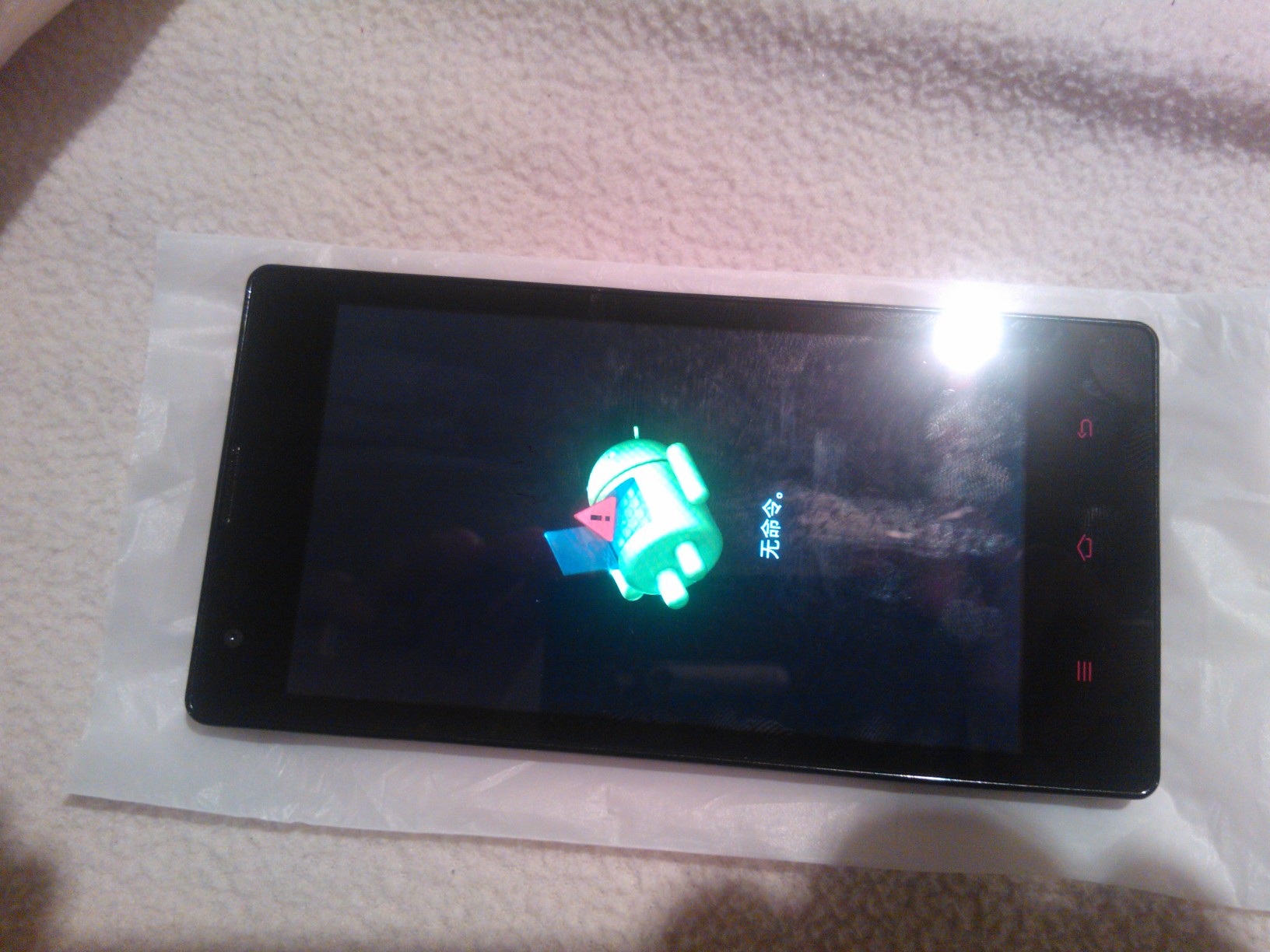

I've just gotten a Hongmi and I'm trying to switch it to the international multilanguage ROM.
At first I thought that the original ROM would be good enough, but there are a lot of parts that are not translated, and I don't speak any Chinese.
So, while trying to update it, after I loaded a recovery bootloader (CWM or TWRP) I get stuck. I see the Android logo lying on it's back and I don't know how to continue. I followed the the guides, but it didn't seem to work.
The weird thing is that the android logo has some text under it (it's in Chinese), which I didn't see on the pictures in the tutorial. I've attached it to this post. Does anyone have any idea?

Try to press the on/off button when you see that logo.
Or volum-up button
I had that issea to, but it was in english.
And there was saying: No action so try to do the things i just told you above.
And wipe all the data/cashe and than use your recovey update....

I already tried pushing the on/off button. I had read that on another thread with someone that was stuck at the same step. But it didn't do anything. Nor did pushing the volume button.
How can I wipe all the data? I got here using mobile uncle tool, which replaced the recovery with cwm or twrp.
Any ideas?
