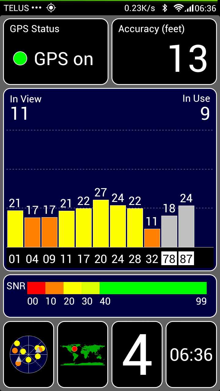

  2. Well i'm not sure what could be the issue. If you use GPS test does it even see any sats at all? This screen shot was just taken from inside my house after about 45 seconds.

    Yeah it shows stats.. but just wouldn't get a fix.. I have 2 Xiaomi MI-2 facing the same issue. This is what I did.. used MiFlash to wipe all and flash 3.1.11 Dev ROM from Xiaomi, then updated to MIUIAndroid's 3.1.11 release. Enabled Root after reboot and installed Maps and GPS Status.. still no go.. the stats shown are just info trying to look for satellites..
