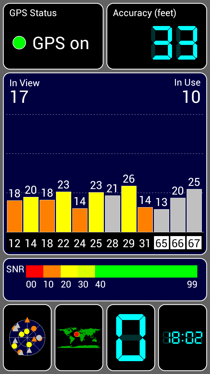

When you get this fix, are you indoors out outdoors kingoftf?
Indoors near the windows a matter of seconds. My version is the latest multi-language
Gesendet von meinem MI 2 mit Tapatalk 2

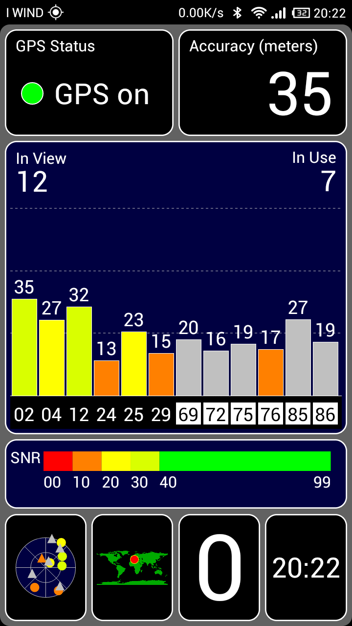

I had problems, but it was due to droidwall blocking the aGPS. If you are using gps without ephemeris it takes sensibly longer to fix and the fix tends to be slightly more inaccurate. If the phone is connected to the internet the fix is matter of 5-10 seconds in the open. By windows it takes more. Mind that gps needs satellites in different places above you to be accurate.
The picture shows a fix by the window (got it in 10 seconds, but it took 30 seconds to get an error of 30 meters).
