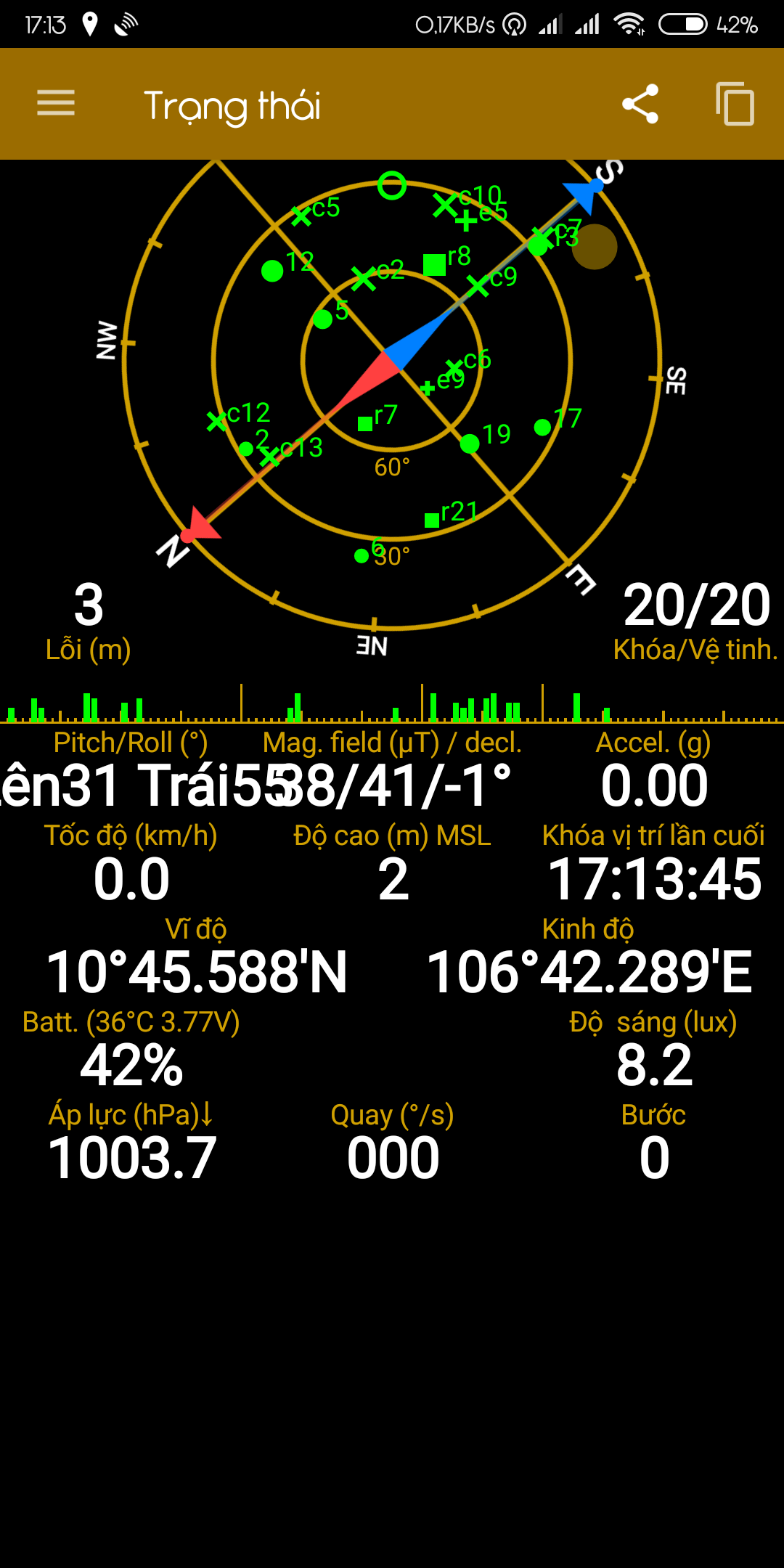

I get Miui 10 Eu 8.6.21 for my mix 2 ,its Gps inside house very good ,it lock fast and many gps satellites .and i get miui pro 8.6.21 miui 10 ,its gps is very weak when inside of my house ,not = Eu miui 10 ver 8.6.21. You should try it , Eu 8.6.21 better gps .
This photo of inside with 20/20 satellites , fail only 3m

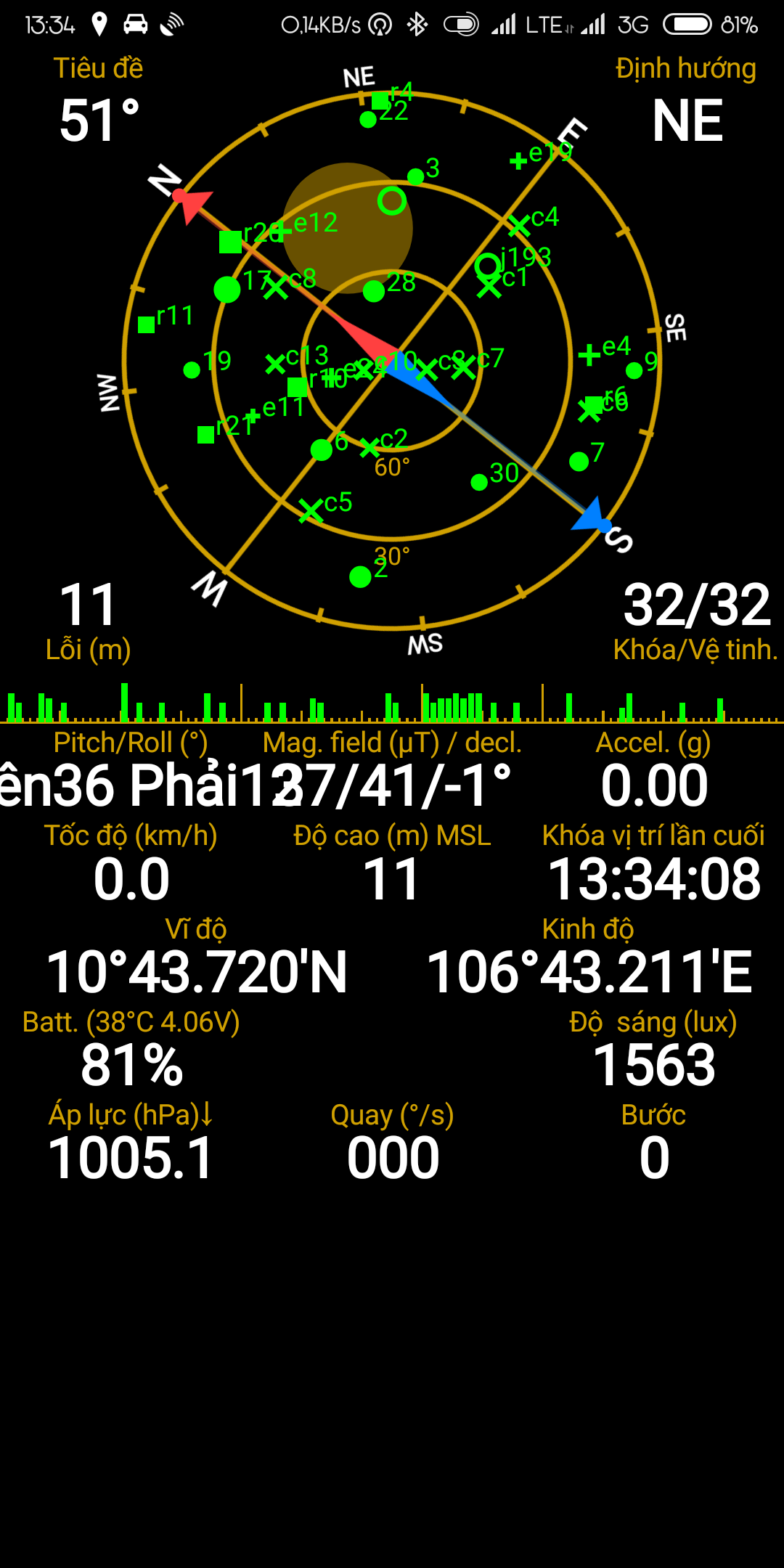

and out side with lock 32/32 satellites but fail to 11m because i sit near a high building .

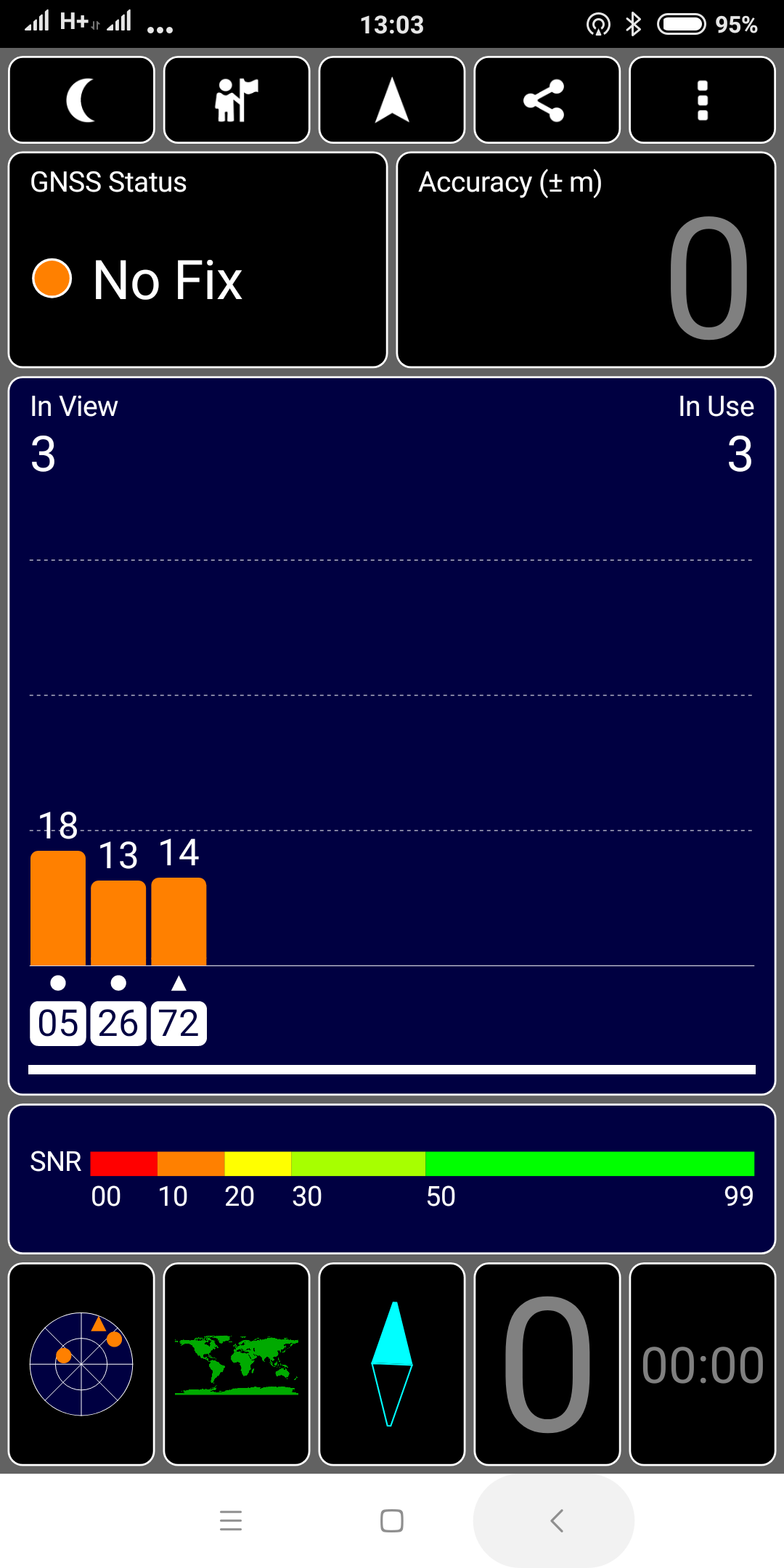

I have mix 2 with 8.7.5 rom from friday. I have no gps to navigate, (outside!) No Fix !
After tiring efforts and multiple rom changes i have discovered why i could not get a gps fix on my mix 2.
I had bought a really nice Elementcase from China* with an aluminum edge and it looked excellent!
After pulling my hair out from frustration for the past whole weekend, i pulled off the case and all of a sudden i had gps even in my house.
So, i have to apologize to the devs here for thinking maybe something was wrong with their work !
