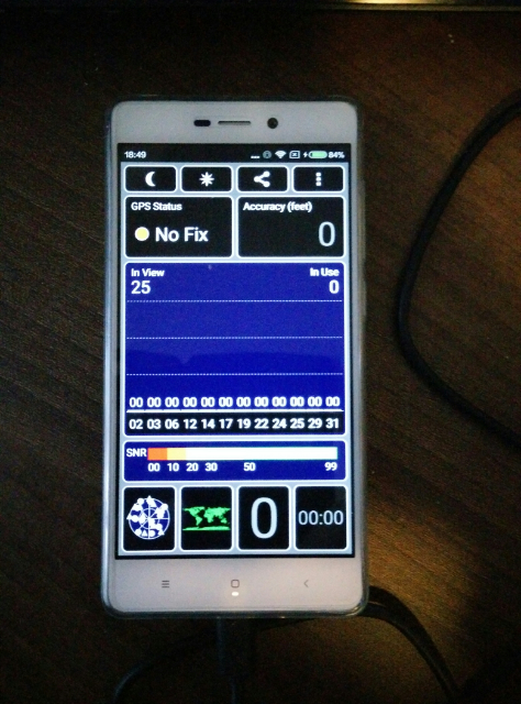

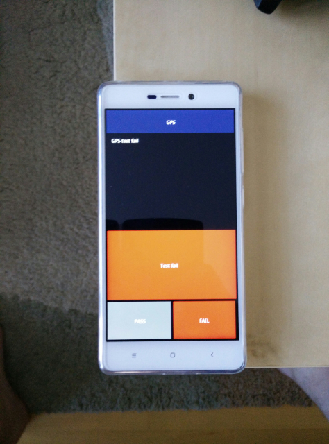

    Hi, I cant get any fix on my location on the Redmi 3, tried everyting with 3 different roms(came with some multilangual china rom "muiu 77.*", flashed to stock china 7.2.7m and now xiaomi EU V7.1.3.0) . I found that you can boot to recovery (vol up + power) and go to "PCBA test" and test the GPS. There I get GPS Failed, do anyone of you know if this means that the hardware for the GPS is broken?
    (sam no fix despite outside under bare sky for 30 minutes, 0 satellites in use)
