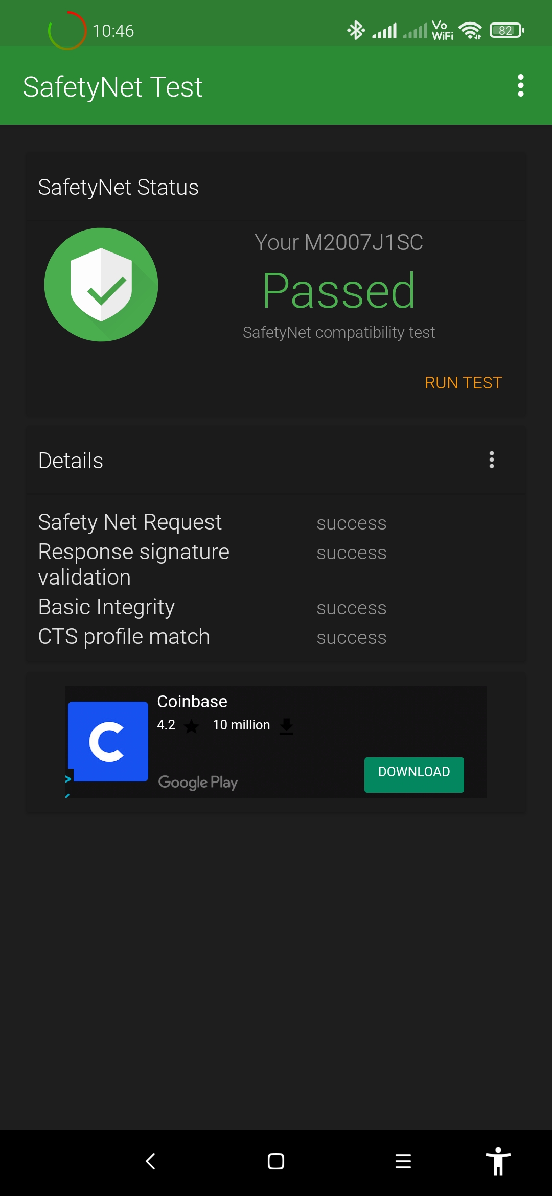

But if I want to update the smartphone via the settings panel and I have the magisk module that changes the phone's fingerprint (in this case from the mi 10 ultra to the mi 10 pro to be able to use google pay) does it download the right version or do I have to remove it?
In the latest weekly, you don't need magisk for Google pay. The safety net test is fully working now.

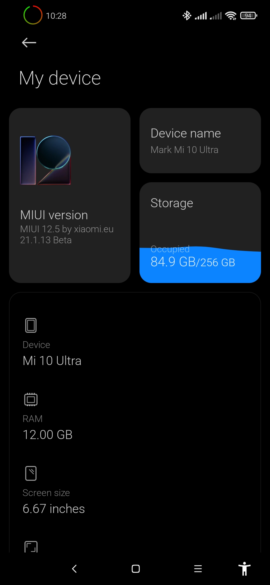

Yes I know but now I'm on stable because I'm not sure if I install the weekly on my main smartphone. Would you use it on your main device or are there too many bugs? and how is miui 12.5 changing so much?
I do use it and don't have any bugs that stop me using it for everything? If you are worried, the make a twrp full back up and save it off phone. This way you can go back if you are not happy. By the time the beta updates get to the weekly, they have already been tested as alpha versions beforehand.

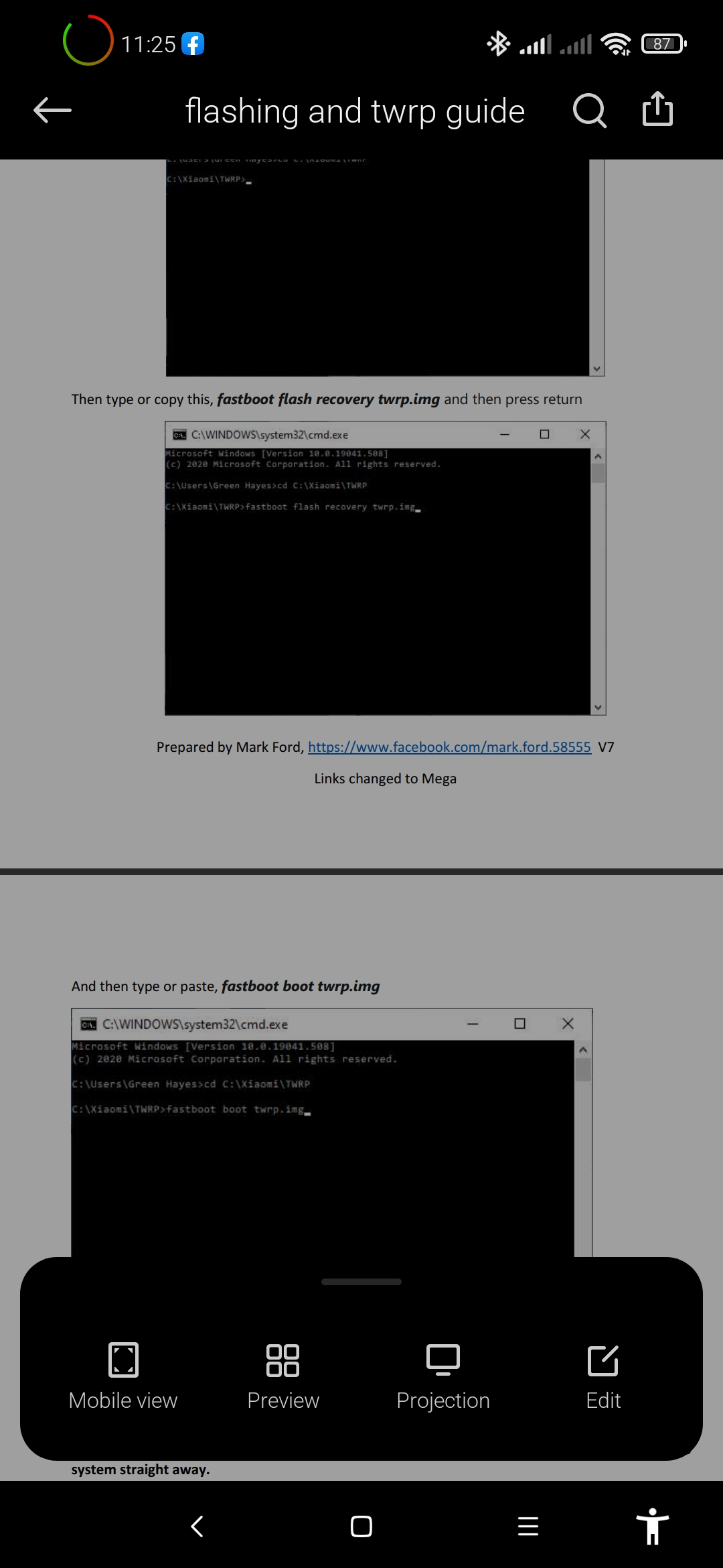

Did you follow the guide that then says to send the command in the command prompt window fastboot boot twrp.img to reboot it to twrp?

[QUOTE = "Mark F, publicación: 586381, miembro: 270248"]
¿ Siguió la guía que dice enviar el comando en la ventana del símbolo del sistema fastboot boot twrp.img para reiniciarlo a twrp?
[/CITAR]
yyesterday I followed your guide and everything perfect, thank you very much
