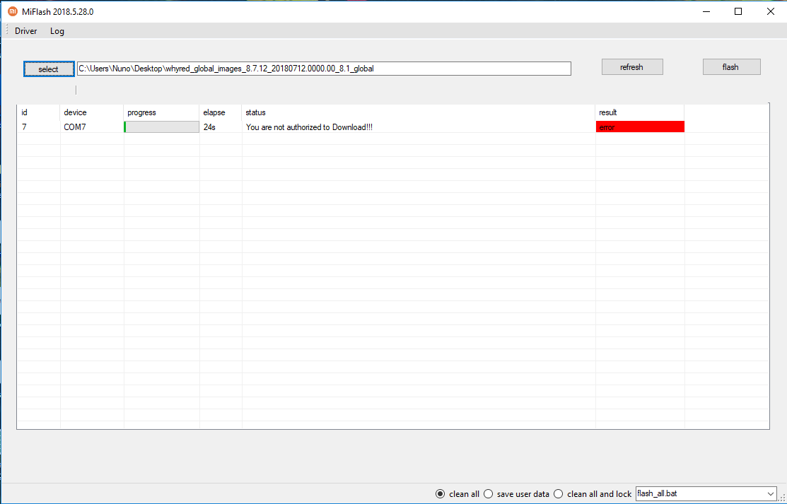

I tried to flash the oficial global rom with the test point method but still gets an error in xiaomi flash tool :/ All drivers are installed corretly. I getting stuck and without ideas
I tried another version of xiaomi flash tool. this one asked me for a login. I used the same username ans pass of the account linked to the bricked devices butr unfortunatly its unauthorized. I have already applies in the russion forum. Lets wait for tomorrow and hope they authorize me to flash it back to normal
Its done. Now I only need to wait for xiaomi's authorization to flash the phone with official rom. As soon I get authorization, I will give you feedback.

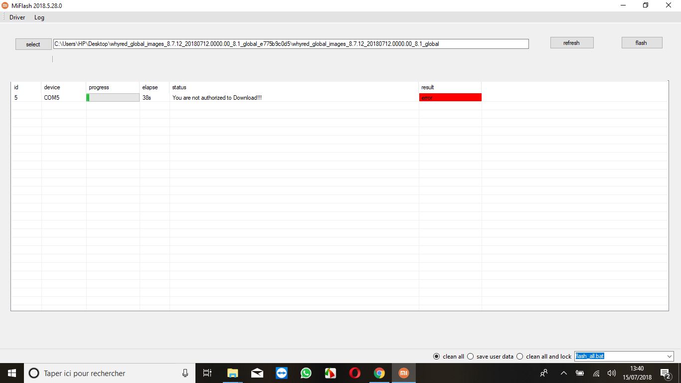

thank you for your replay and sorry for my english ,i'm from france, i have juste post my id on the topic ,thats all?and i have a question please ,lik me you have no screen and no led so how did you don to begin the flash? i receive : cannot receive hell packet...
Yes thats all. DId you dissassembled your phone to use test points method?
I didn't need that cable. I just disconnected the battery, plugged in the usb cable in the PC and in the phone, short the test point till ear a sound of new device in the PC. As I already have the drives installed, my pc founds the phone as HK-USB QDLOADER 9008 (COM #).
After it just use the Xiaomi flash tool provided in the links above.

Came back from work and decided to try again to flash the dead redmi note 5. In the login section this time appears that my PC is bounded to my account.
The flashing progressed bar es going up. Let's wait and see if it works.
