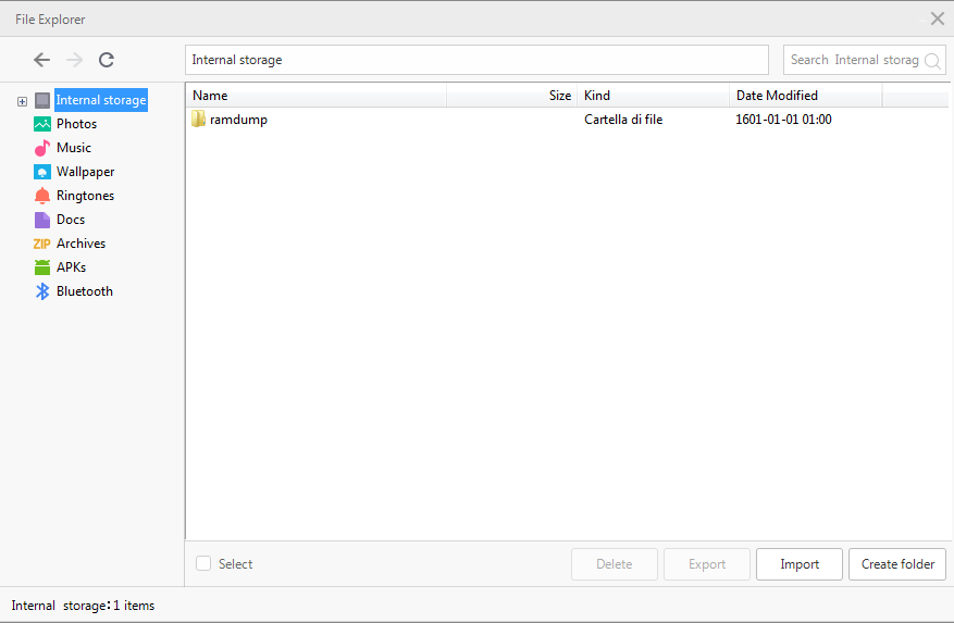

Hi guys, here I tried to collect the most infos I can up to now. First of all I want to show what I have in Internal Storage: As u can see: nothing. If I try to copy something with MiPcSuite it didn't fail, but it also didn't copy anithing. If I try to copy just dragging something in it, it says errror I wrote what CWM says when i try Wipe/Data reset: -Wiping Data- Formatting /data... Formatting /cache... Formattig /sd-ext... E:unknown volume for path [/sd-ext]... Formatting /storage/sdcard0/.android_secure!... Error mounting /storage/sdcard0/.android_secure!... Skipping format... Data wipe complete And then I used the cmd mount to see what I have mounted, here the results (I am not able to understand anything reading them) shell@android:/ $ mount mount rootfs / rootfs ro,relatime 0 0 tmpfs /dev tmpfs rw,nosuid,relatime,mode=755 0 0 devpts /dev/pts devpts rw,relatime,mode=600 0 0 proc /proc proc rw,relatime 0 0 sysfs /sys sysfs rw,relatime 0 0 none /acct cgroup rw,relatime,cpuacct 0 0 tmpfs /mnt/asec tmpfs rw,relatime,mode=755,gid=1000 0 0 tmpfs /mnt/obb tmpfs rw,relatime,mode=755,gid=1000 0 0 debugfs /sys/kernel/debug debugfs rw,relatime 0 0 none /dev/cpuctl cgroup rw,relatime,cpu 0 0 /dev/block/platform/msm_sdcc.1/by-name/system /system ext4 ro,relatime,data=orde red 0 0 /dev/block/platform/msm_sdcc.1/by-name/userdata /data ext4 rw,nosuid,nodev,relat ime,noauto_da_alloc,data=ordered 0 0 /dev/block/platform/msm_sdcc.1/by-name/cache /cache ext4 rw,nosuid,nodev,relatim e,noauto_da_alloc,data=ordered 0 0 /dev/block/platform/msm_sdcc.1/by-name/persist /persist ext4 rw,nosuid,nodev,rel atime,noauto_da_alloc,data=ordered 0 0 /dev/block/platform/msm_sdcc.1/by-name/modem /firmware vfat ro,relatime,fmask=01 33,dmask=0000,allow_utime=0022,codepage=cp437,iocharset=iso8859-1,shortname=mixe d,errors=remount-ro 0 0 /dev/fuse /storage/sdcard0 fuse rw,nosuid,nodev,relatime,user_id=1023,group_id=1 023,default_permissions,allow_other 0 0 shell@android:/ $ That's all I thought would help u and me, if need anything else, just let me know
http://xiaomi.eu/community/threads/mi2s-extending-size-of-storage-partition.21391/ read and apply , you have corrupted sdcard , easy fixable
