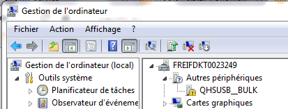

Connected to a Windows PC, it detects a QSHSB_BULK:
and tries to mount 7 unrecognised partitions but asks to format them..
