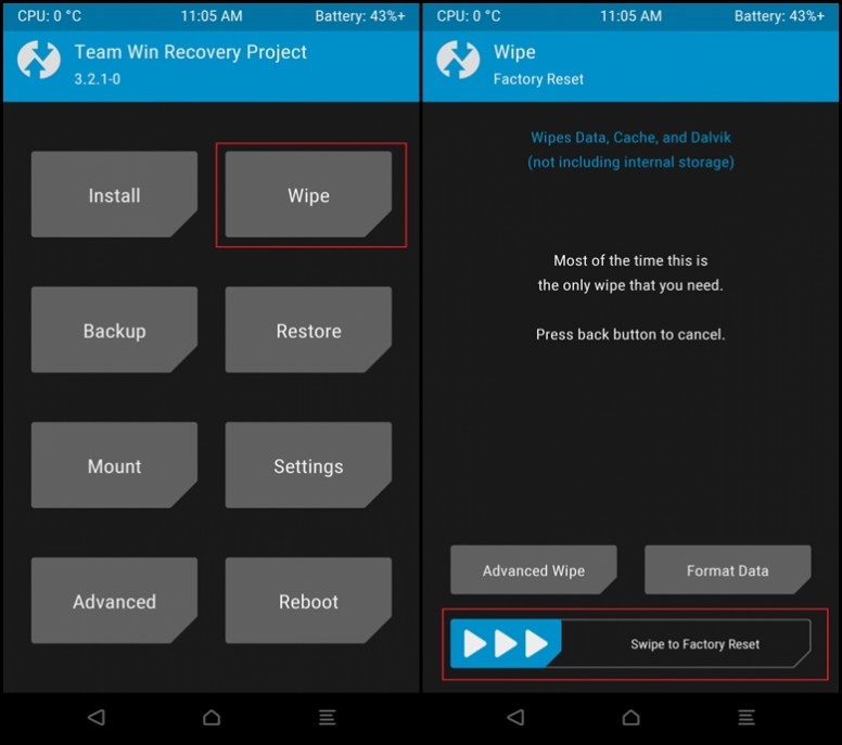

You have to press the format data button, then type yes to confirm. It's mandatory in order to downgrade from a higher version. Phone won't boot otherwise.
32264
fw85-
Oct 6, 2020
65
30
You have to press the format data button, then type yes to confirm. It's mandatory in order to downgrade from a higher version. Phone won't boot otherwise.View attachment 32264
Note that you need to press Format Data, the image posted above highlights factory reset, which only wipes data and that isn't the same.
The difference is, that formatting data actually re-creates the data partition as a whole with a very important side-result - it removes any encryption present on the data partition.
Now, Wiping data (or Factory reset) keeps the data partition and its scheme intact and simply deletes any data present on it - while preserving encryption.
That's why a lot of people, who forget to format data after switching between major ROMs (e.g. chinese MIUI -> EU MIUI), tend to run into issues when booting a newly installed ROM - when the system boots up, it tries to decrypt the data partition, but since it's been encrypted by a different ROM altogether, it doesn't work, the decryption fails and the system shuts down as a result - sending you back to recovery.
Reactions: Poney70 and Mark F

Downgrade EU rom is format data mandatory.
Do it in TWRP, reboot it and reload your rom for flash.
