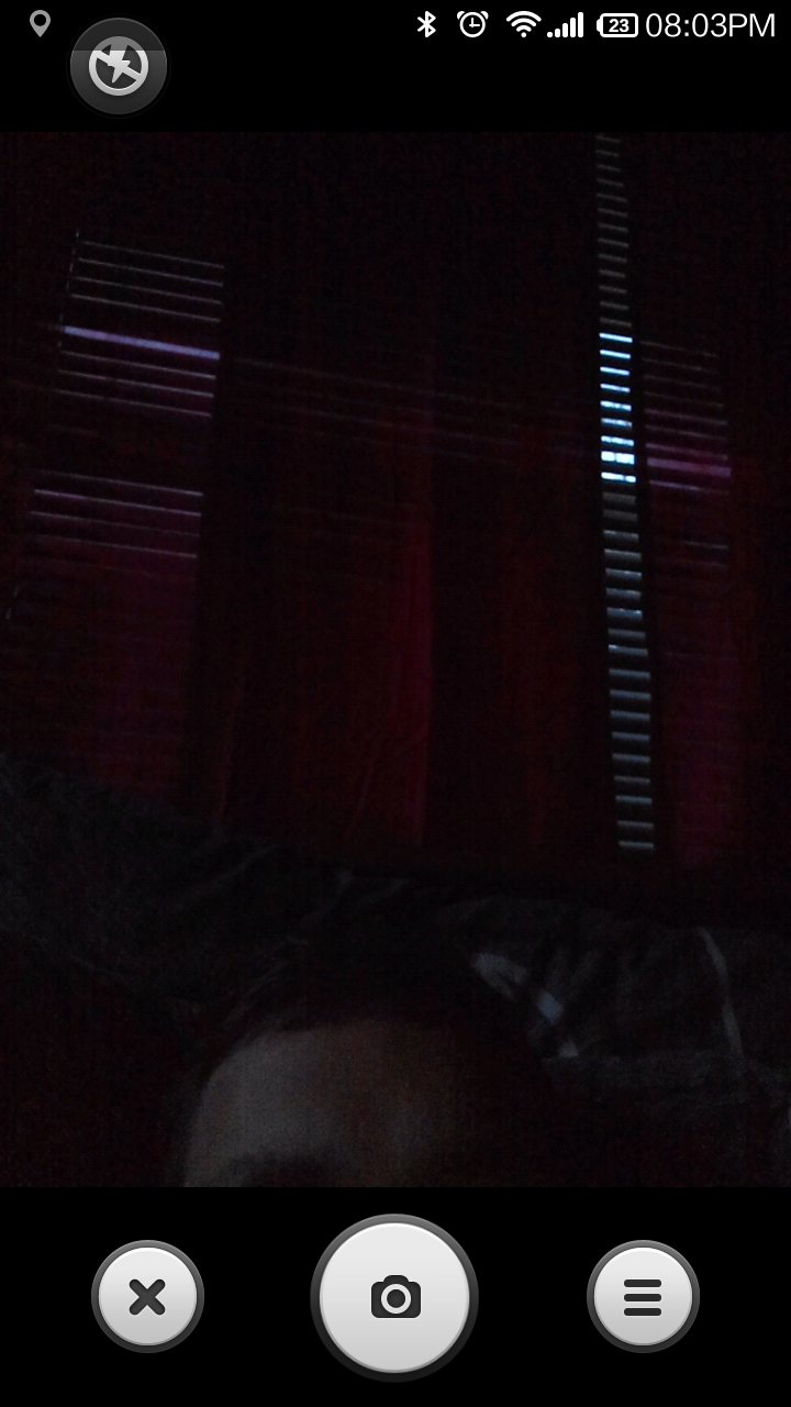

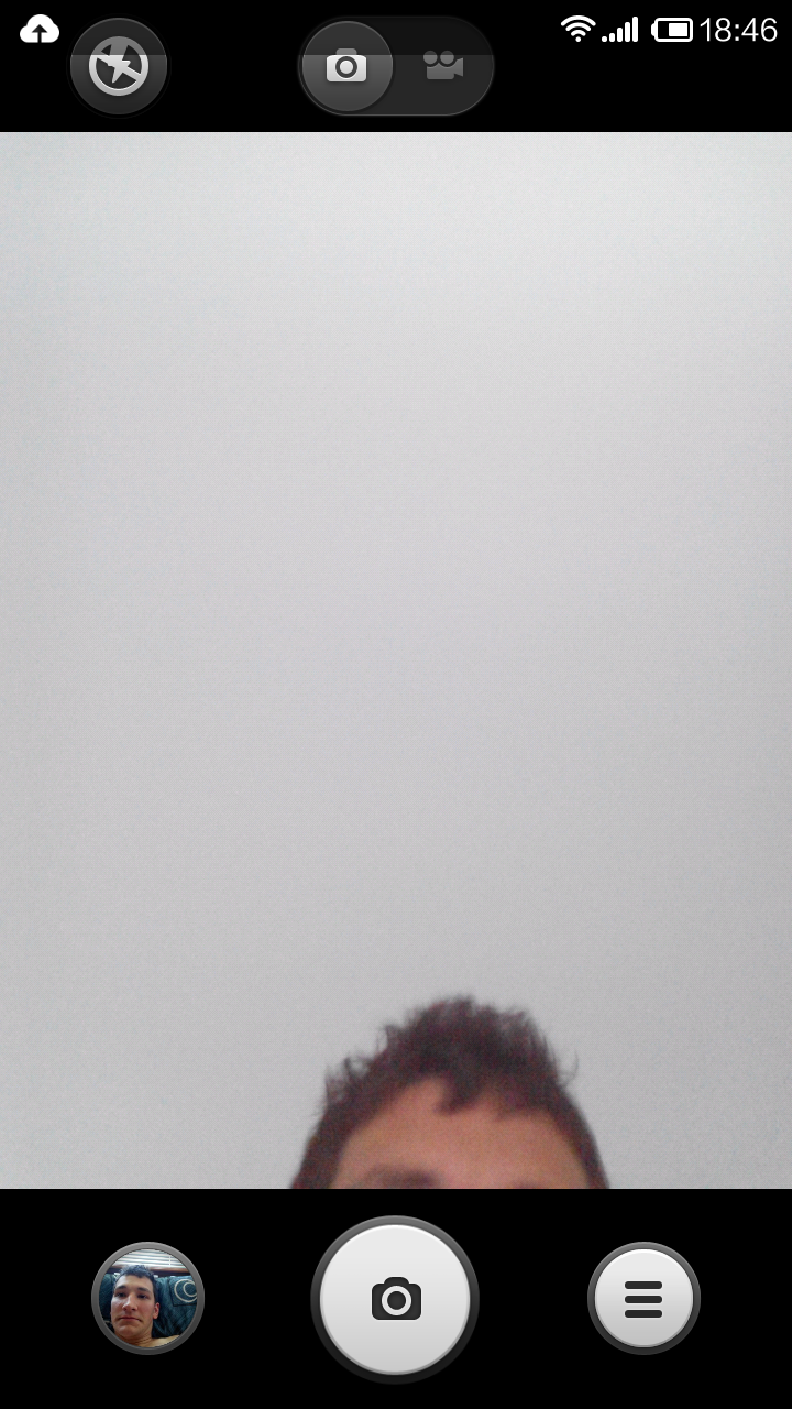

    Hi guys just brought a new redmi note 2 weeks ago and it has a problem with the rear camera. There is no option to switch. I've tried clear cache, tried reset to factory and checked in hardware *#*#6484#*#* and it won't open in that.
    See screen cap Screenshot_2014-10-27-18-46-25.pngScreenshot_2014-11-01-20-03-43.png
