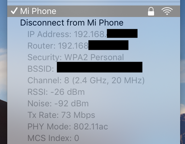

The problem is that the hotspot (2.4 GHz, Device identification:default, security WPA2-Personal) is correctly seen by the laptops but there is no internet connection. I received the Mi 9T last week and it's a great phone except for the hotspot not working properly. I received it with the global version installed, I did all the usual updates up to MIUI V11.0.4 (QFJMIXM).
On the Macbook Pro (Retina 2015, Mojave 14.6) there is a very slow, barely usable, connection which is confirmed by the MCS index = 0, despite the strong signal (RSSI= -26 dBm). Under the WiFi information on the Mac, the country code is missing and the transmission channel is usually an unusaul value (3, 7 or 8 I noticed). For comparison, when using the hotspot function in another Android phone (Honor 8X with stock ROM) with the same SIM card , the MCS index is 7, the country code is correct, the transmission channel is 6 or 11, and the download/upload is around 20 Mbps.
When using a Dell laptop (Windows 10), the laptop connects to the MI 9T hotspot and has an IP but the pages are not even loaded. Funny enough, when both laptops are connected to the wifi created by the MI 9T, they can ping each other correctly.

Is there any way to change the Country code in the MIUI EU 11.06? On my Macbook it returns "Country code: X3" (System information/Wifi) whereas the other android phone with the same SIM and same APM settings returns the correct code!

Update: I have upgraded to the latest weekly ROM (MIUI 11.2 20.3.26), unfortunately the country code is still X3 when using the hotspot, both at 2.4 GHz and 5.0 GHz. The only difference is that at 2.4 GHz the MCS level is 0 (even if internet works normally) and with the 5 GHz setting the MCS is 7 or 8. In both cases internet works fine, but the country code is an issue with the firewall on other devices.
Any suggestion or help is greatly appreciated as I really need the hotspot function to work as per the other Android phone!
