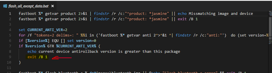

Everything begun after a simple reboot and the phone didn't start again, even it's was working well with a custom ROM before and I didn't do anything.
Then, I believe I made some mistake, because I tried to recovery it flashing a stock ROM (jasmine_global_images_V10.0.13.0.PDIMIXM_9.0), with XiaomiMiFlash app,
but the app didn't accept the flash because of the if bellow:
27234
So, it's now when I think that I made something bad. I removed the line with red arrow, because I thought it wouldn't be a serious problem. After that, the phone does not start anymore. Then, I remove the battery and I tried to make a manual connection after disconnected the battery, like the guy bellow, to flash a ROM (check this video), but it didn't work:
27235

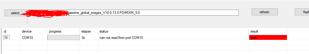

Now, every time I try to flash I got this:
27236

What is your ARB version?!
And which kind of USB do you use to connect it to the PC? USB2 or USB3?!

@sz.hatef ,
I think it's ARB version 4 and the USB port is 2.0 .
If you have ARB4, flashing Jasmin Roms (A2 Roms) lead you to breaking your phone, as what you have right now.
You need just forget Android One and flash Wayne Roms (6X Roms) and use MIUI for now on.
You can find plenty guidelines to recover a brake converted A2 to 6X (since you have ARB4 it means your phone is converted to 6X).

Hello, I'm in the same situation as him, MiFlash always gives the error "can not read from port COM3" and when I try to flash a Wayne ROM, MiFlash asks for an authorization that at the moment, I don't have, can you help me?
Hi, I am afraid that hear you encounter a problem over flashing,
About the first error I suggest you to use an USB2 port not 3. If your PC hasn't got any, use a hub instead ( apparently not an USB3 one ;) )
For the second one you can find a solution, I think; I have never experienced such a problem with my account, and my account is a normal one, so I do assume that you can manage to solve that too.
I hope to hear you soon that every thing is safe and sound again.

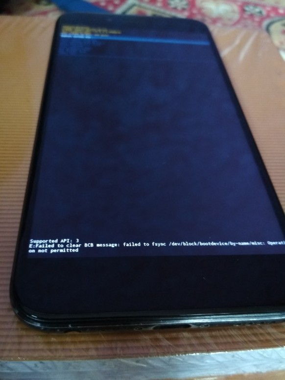

Hi, below Supported API 3 shows:
Failed to clear BCB message: failed to fsync /dev/block/bootdevice/by-name/misc: Operation not permitted
Pretty sure this is why I can't sync to pc nor wipe factory reset
