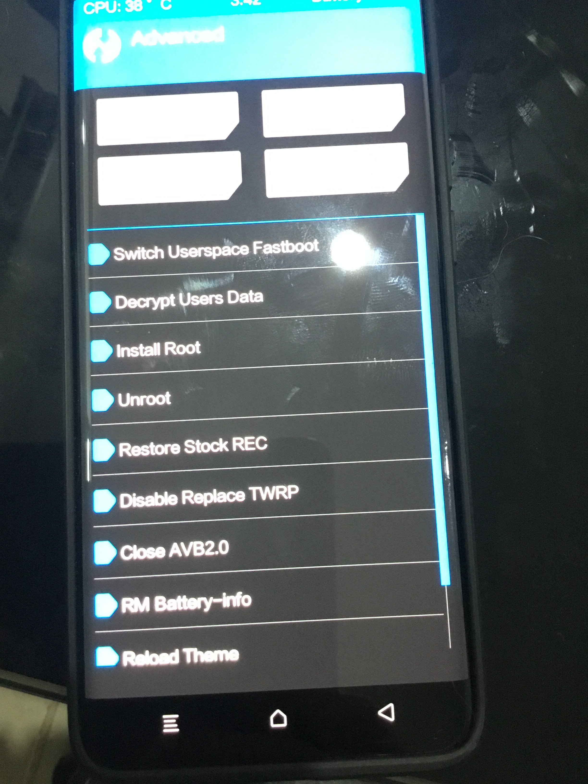

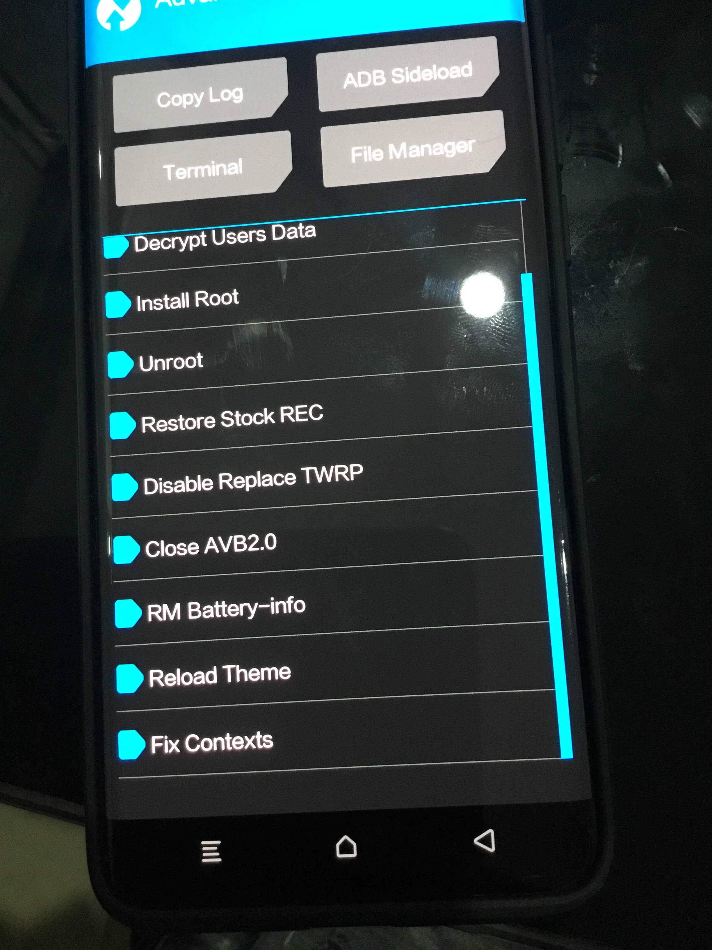

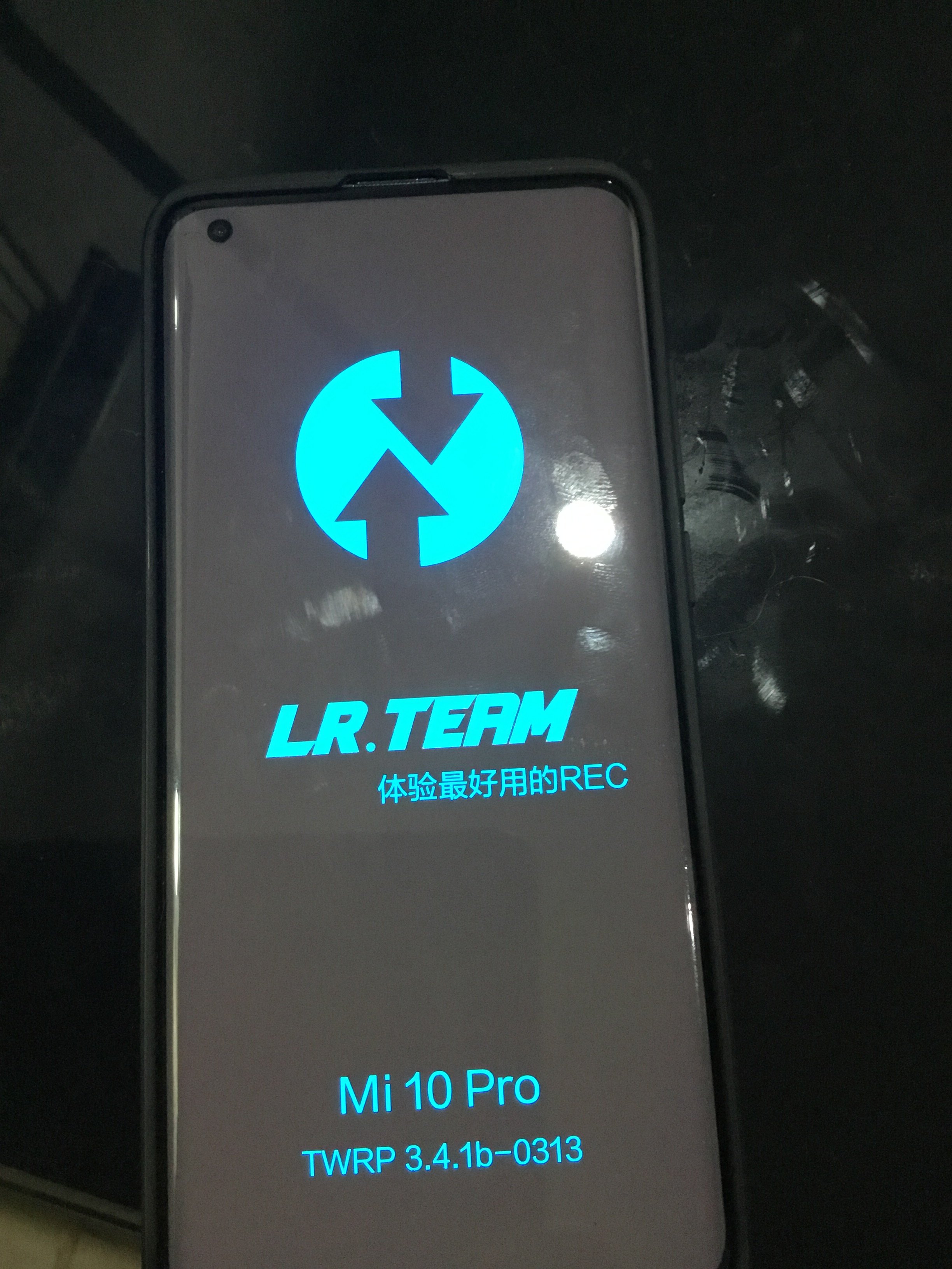

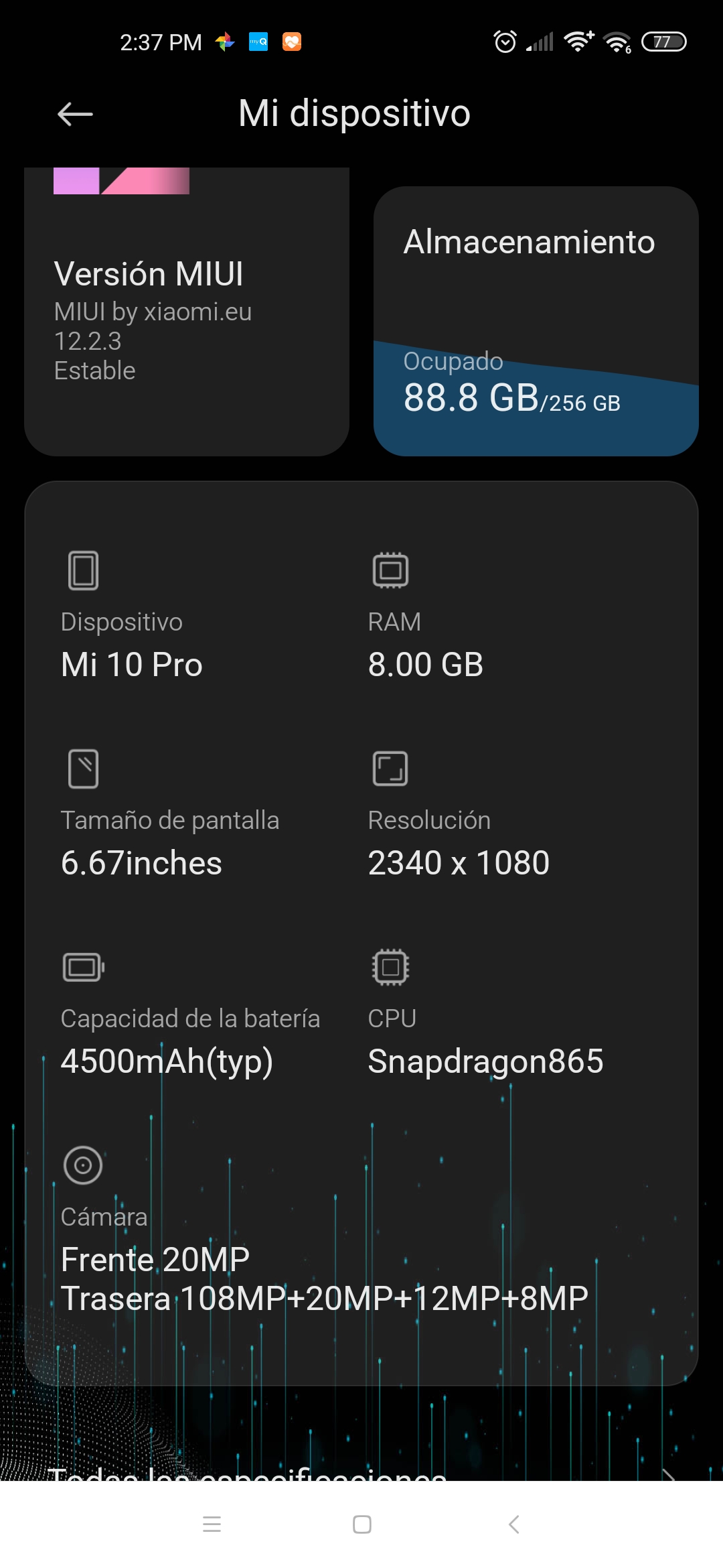

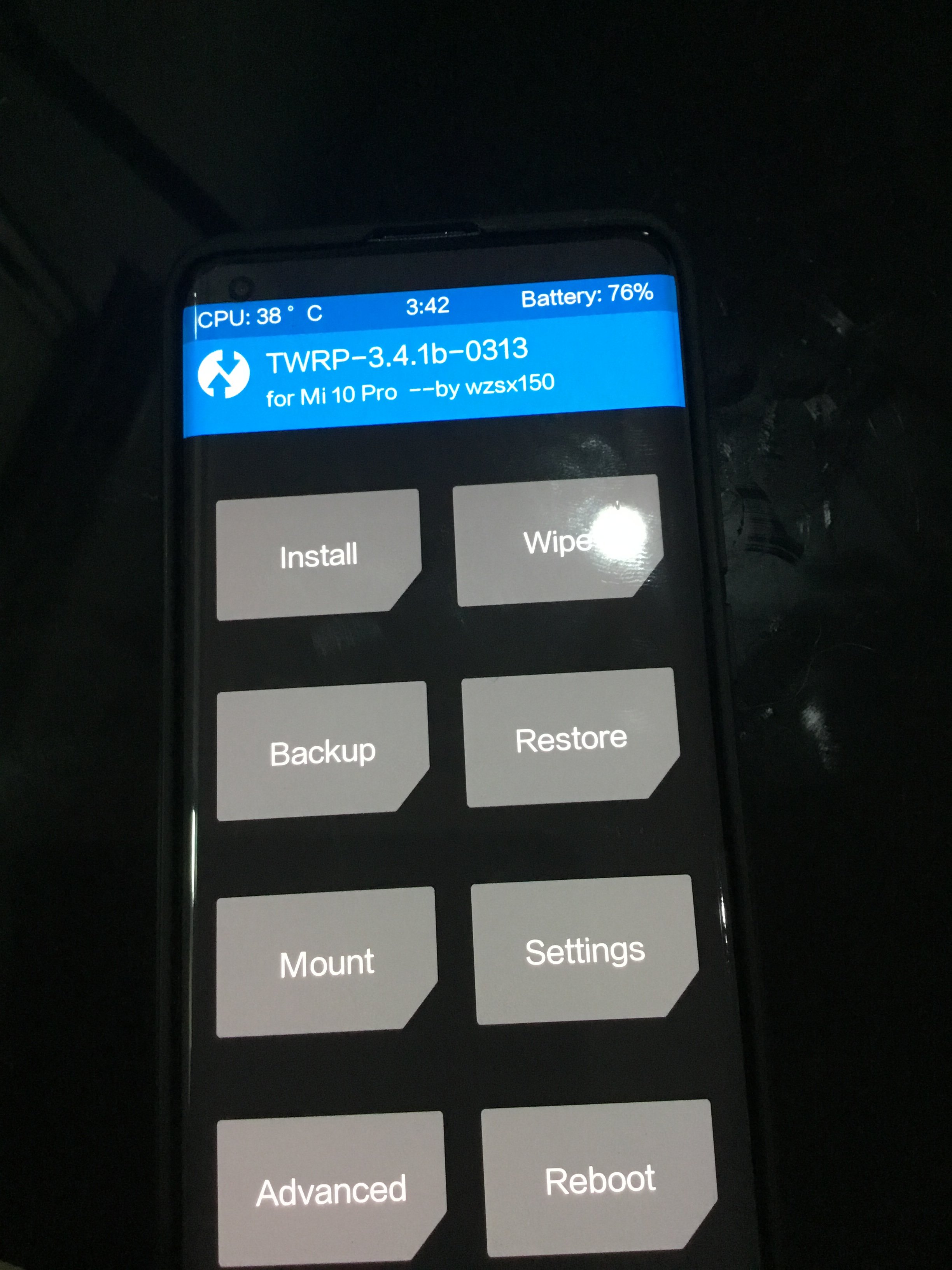

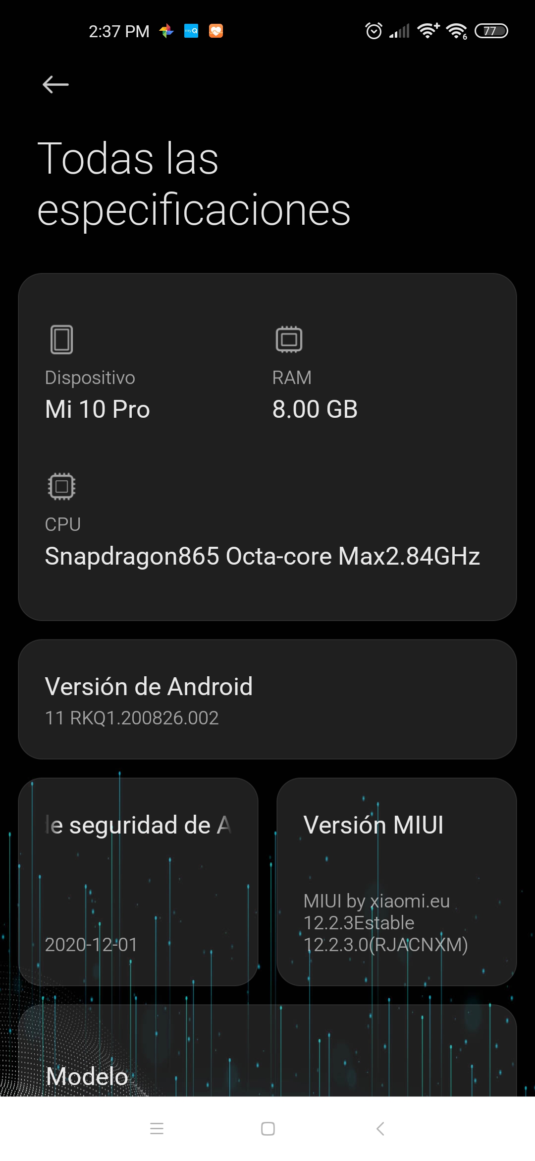

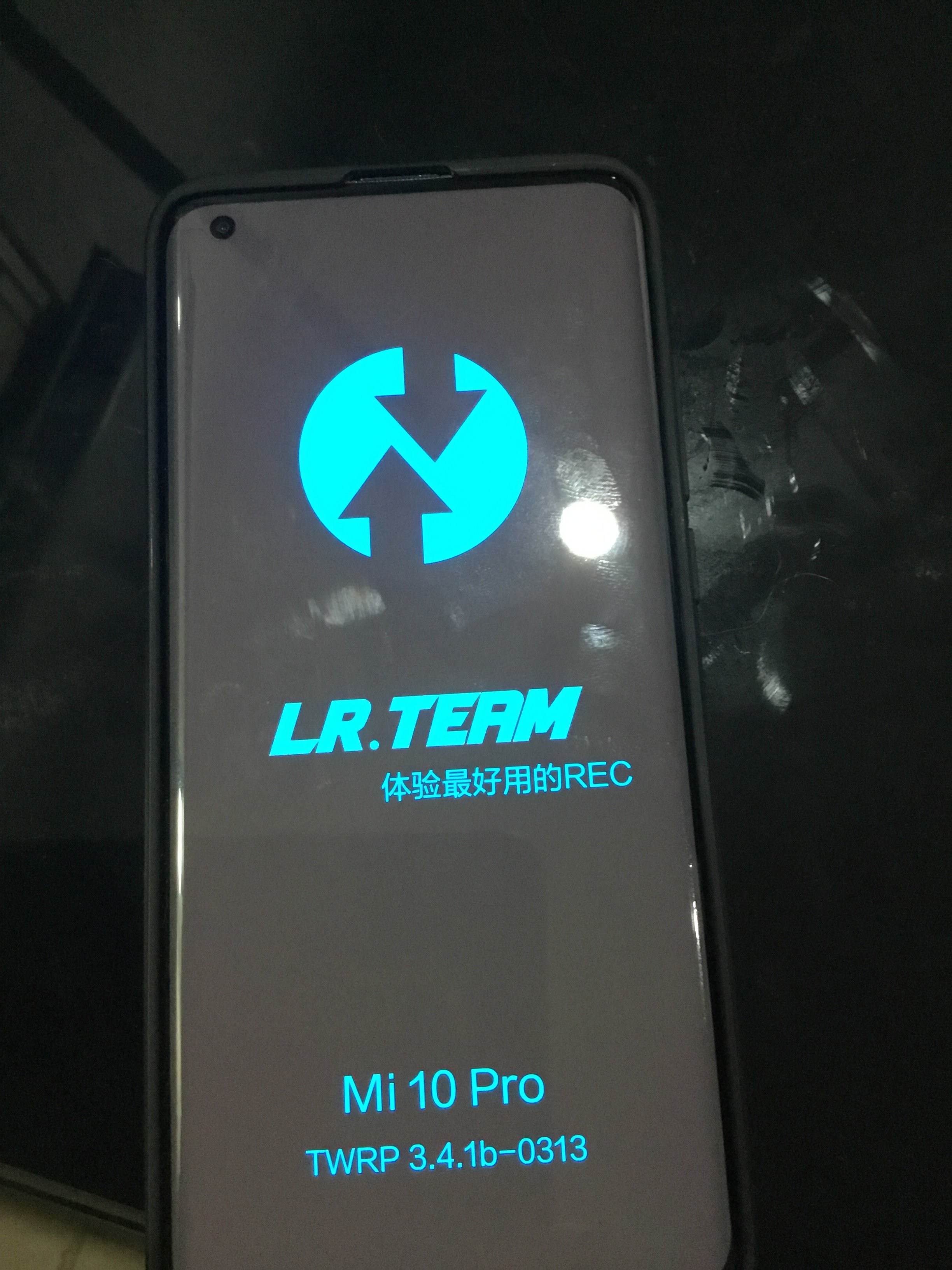

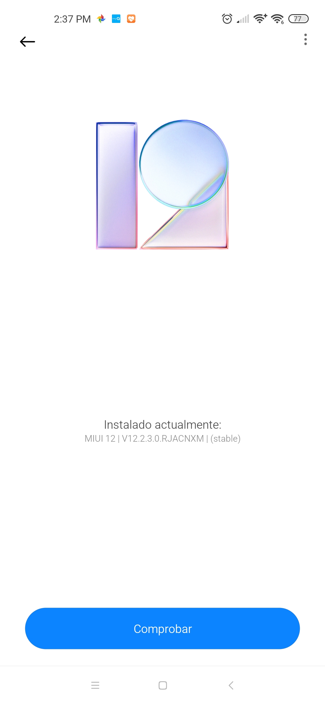

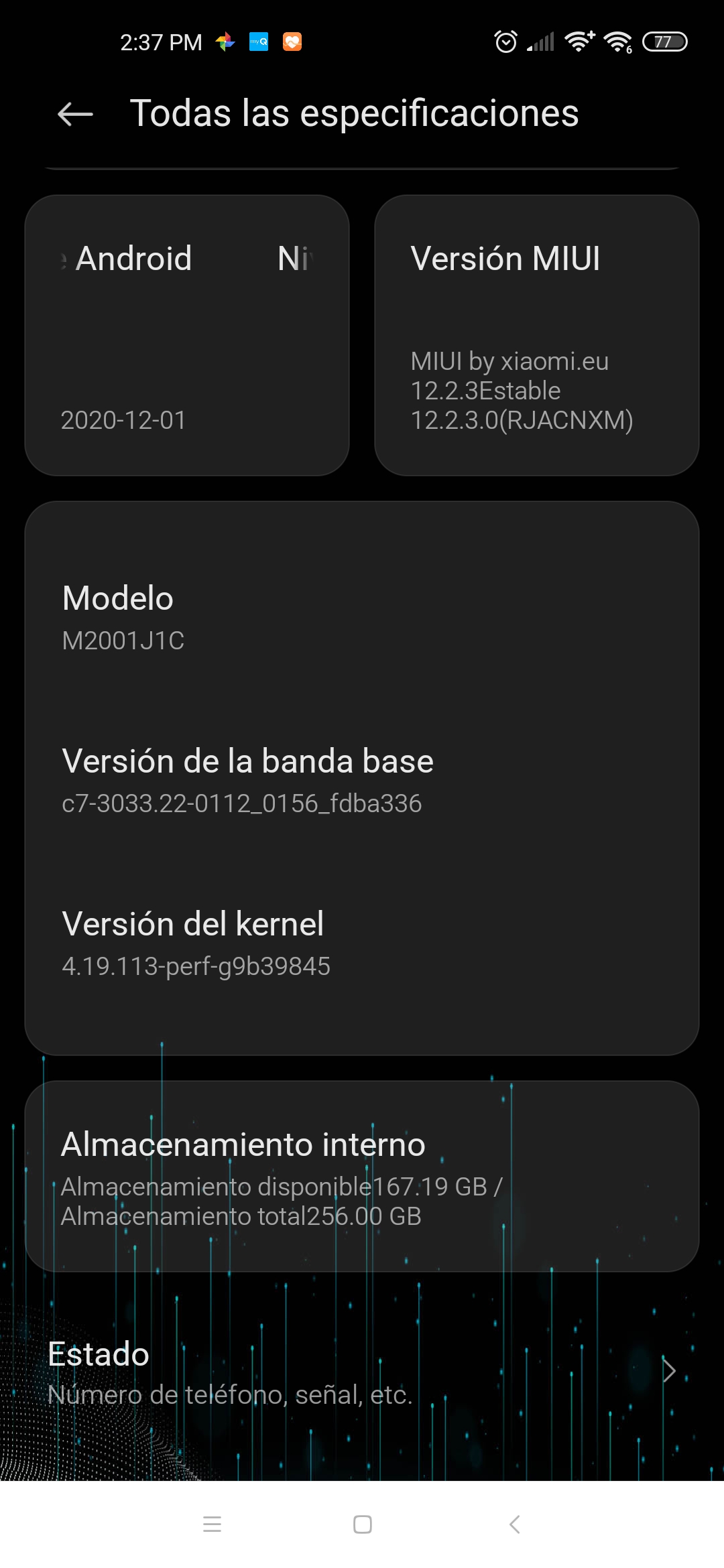

Hello , and sorry for asking this. Its better to move on from my software to this newer rom? i had already one year with my mi 10 pro but i read that the weekly rom its better and i want to try it but i dont know if i can flash the weekly rom and i dont know anything about how to do it. i read that i need to change my recovery but how i do that? sorry for asking. i upload some jpg about my cellphone

Latest TWRP for your device is this one => https://androidfilehost.com/?fid=14943124697586336672
You can install it via your current TWRP:
1) Download the new TWRP on your phone then boot in TWRP and go in "Install" menu
2) Select "Image" button then find "twrp-3.5.2-0-cmi-manuelbianco.img" file and flash it on the "Recovery" partition
3) Go back in main TWRP menu then go in "Reboot" menu and select "Recovery"
4) Done! :)
WARNING: Going from Stable to Weekly version, without formatting data, may result to a device bootloop/only boot in Recovery!
=> You can now try to install the latest Weekly ROM for your device in the new TWRP but if your device doesn't boot to system after that, you need to "Format Data" in TWRP (the "Format Data" button in "Wipe" menu) and reboot your device. ;)

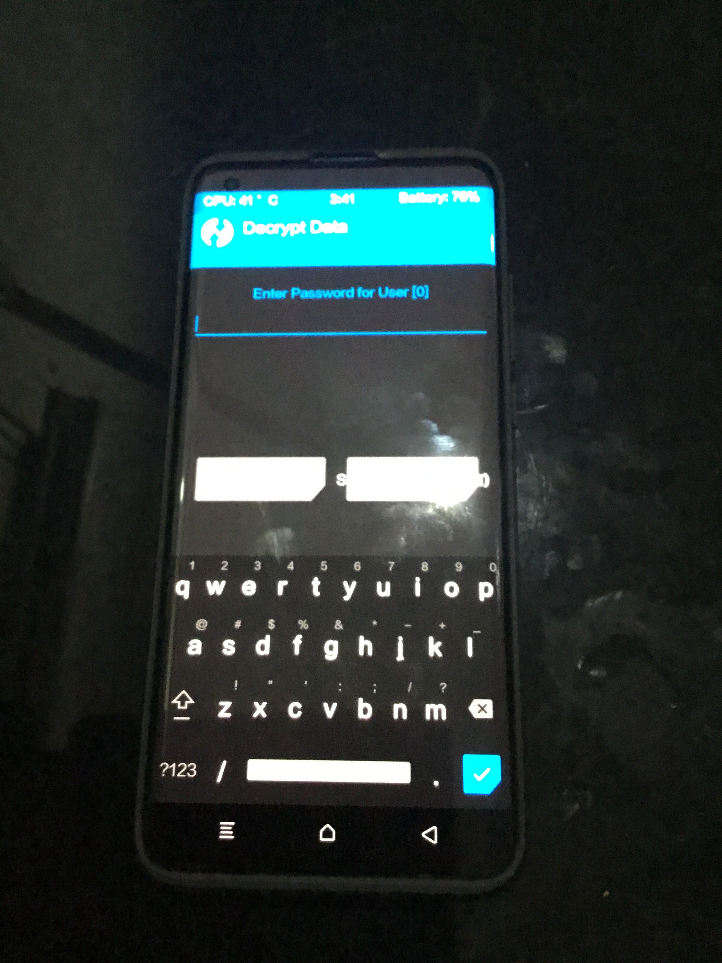

My Magisk root has gone with the last OTA update on my Mi 10 Pro (EU Stable 12.2.4 from 12.2.3). I try to install Magisk23.0.zip with TWRP manuelbianco.
First trouble with TWRP itself:
TWRP starts with fastboot method fine. I have TWRP image installed within twrp, but doesn't start with power + vol+ combination, neither reboots to recovery from twrp itself. Only fastboot from PC is working.
Installing Magisk23.0.zip sends red error messages, too fast to read and restarts TWRP. The Log (in Advanced) doesn't show the log of Magisk installation. Magisk app shows that Magisk is not installed.
The Magisk app offers the method to patch any boot image. Do you think to patch my 12.2.4 Stable ROM and reinstall from TWRP will work and provide Magisk installation too?
