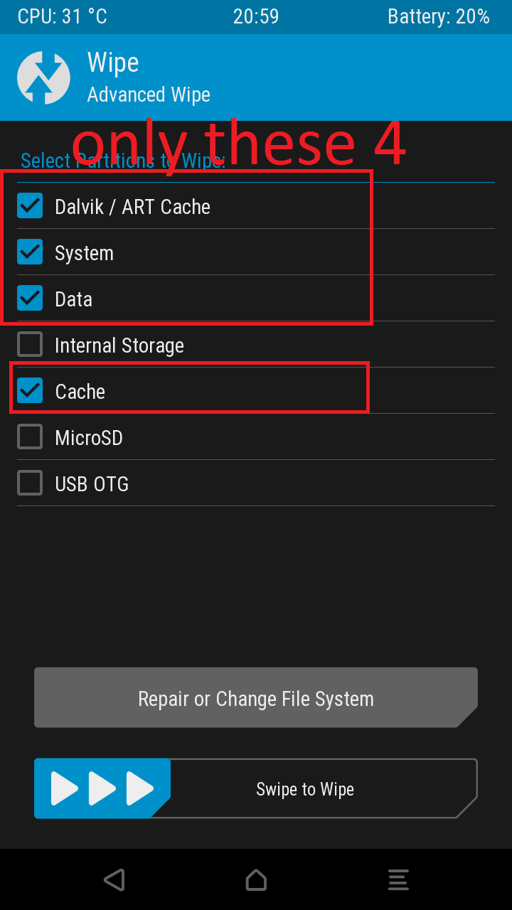

    Wich TWRP did you used for ?
    I sure the rom is correct, but i wiped everything except external storage and USB OTG...
    How did you do ? Did you flash with your rom on external sd card or internal ? Because, i think i can wipe it if i put the rom on sd external card... What do you think ?
    PS: wich rom did you use, stable or weekly update ?

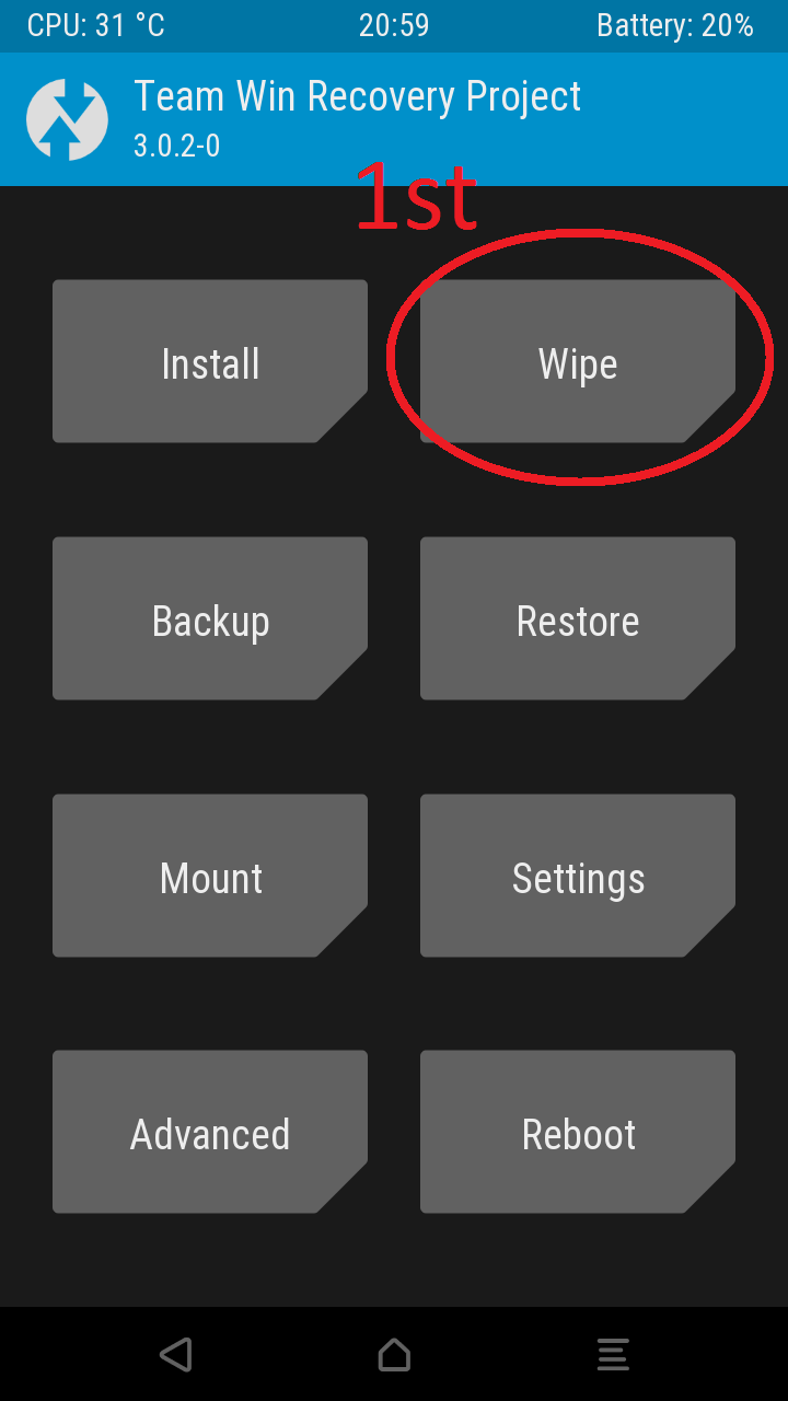

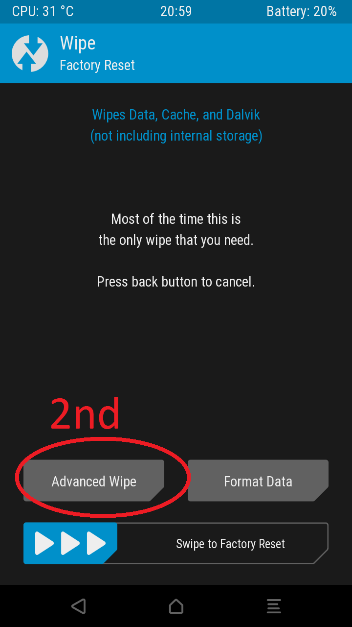

  5. det-Happy
    det-HappyMembers
    Dec 5, 2016
    8
    Male
    Germany, Dortmund
    #5det-Happy,Jan 4, 2017
    TWRP 3.0.2.0, i get it from there: http://en.miui.com/thread-328569-1-1.html
    I installed the rom via external SD-CARD (128 GB). But you don'nt need kill everthing on your device. Just 4 Partitions.
    the weekly, xiamoi.eu_multi_HM3SHM3X_6.12.29_v8-6.0

    Great thanks to you det-Happy, now it works ! i install the stable one and it works !
