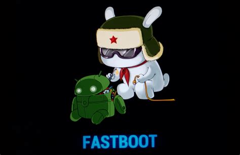

if you see various options you are not in fast boot mode ( Volume down + Power on ) , with options visible you are in recovery mode ( Xiaomi style ). You need to see the little guy on the attached picture.
When writing "Volume - " I should have better mentioned "Volume down" :-(
For the rest you simply follow the instructions on the 1st page of the "MIUI weekly Rom releases" It's simple
Good luck

Sorry, my mistake.
I have started phone in bootloader mode (volume down + power) but when I plug it in, nothing is happening.
I launch miflash_unlock.exe, restart phone in bootloader mode, plug it in and nothing is happening. It does not "see" the phone at all.
