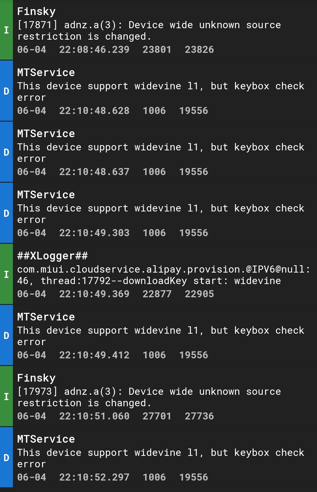

Today, 10 hours ago I got a new L1 certificate on my Mi9 via fingerprint payments. Unfortunately the widevine status changed from L1 back to L3. I'm also unable to download a new certificate. When trying to download the new certificate, the error code 1 pops up

Logcat entrys including wide. I've DMd you the whole logfile.

You must have installed something that broke the Widevine on a deep level. Some Magisk module perhaps, or flashed some ZIP.
The important part is here:
Code:
[06-04 22:10:48.637 1006:19556 I/QCOM-OEMCrypto]
OEMCrypto_Initialize
[06-04 22:10:48.637 1006:19556 E/QSEECOMAPI]
Error::send command ioctl failed. ret = -1, errno = 22
[06-04 22:10:48.637 1006:19556 E/QCOM-OEMCrypto]
Error at trusted_app_get_api_version : 472
TA Result : 10 OEMCryptoResult : 1
Error at _oecc01 : 110
LibOEMCrypto version 1.30
TA   version 0.0
Api  version 0.0
[06-04 22:10:48.637 1006:19556 E/WVLib]
initializate oemcrypto fail
[06-04 22:10:48.637 1006:19556 D/MTService]
This device support widevine l1, but keybox check error
