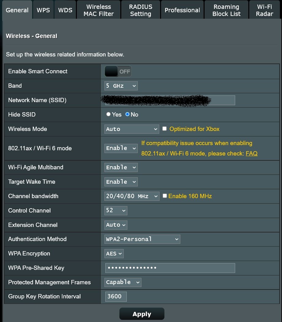

@osnix and @marcel112
Can you share your setting from your asus router like this?
Not yet but once I'm home I can.. I already see some problems in yours. Enable 160 MHz to start with. Also since you set 5 GHz only for the SSID 20/.. MHz setting doesn't make much sense.

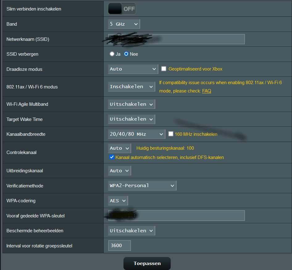

Same Problem. Tried the same settings... Max. 9.3MB/s. The phone show also only 430Mbps as connection speed.
FYI
I could fix the Problem. I had to disable "802.11ax/ac Beamforming" and "Universal Beamforming". Now i can reach max. speed of my home internet 500/50.
