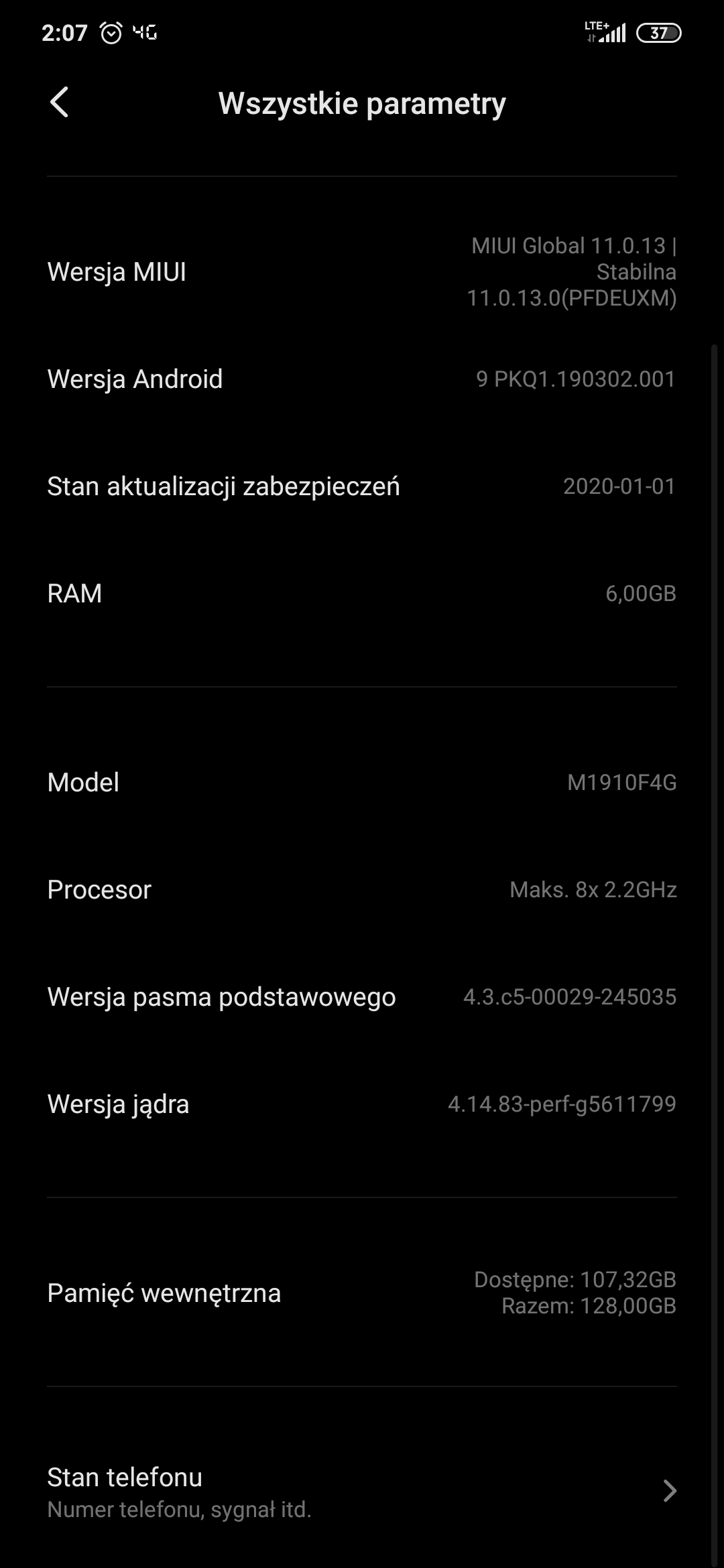

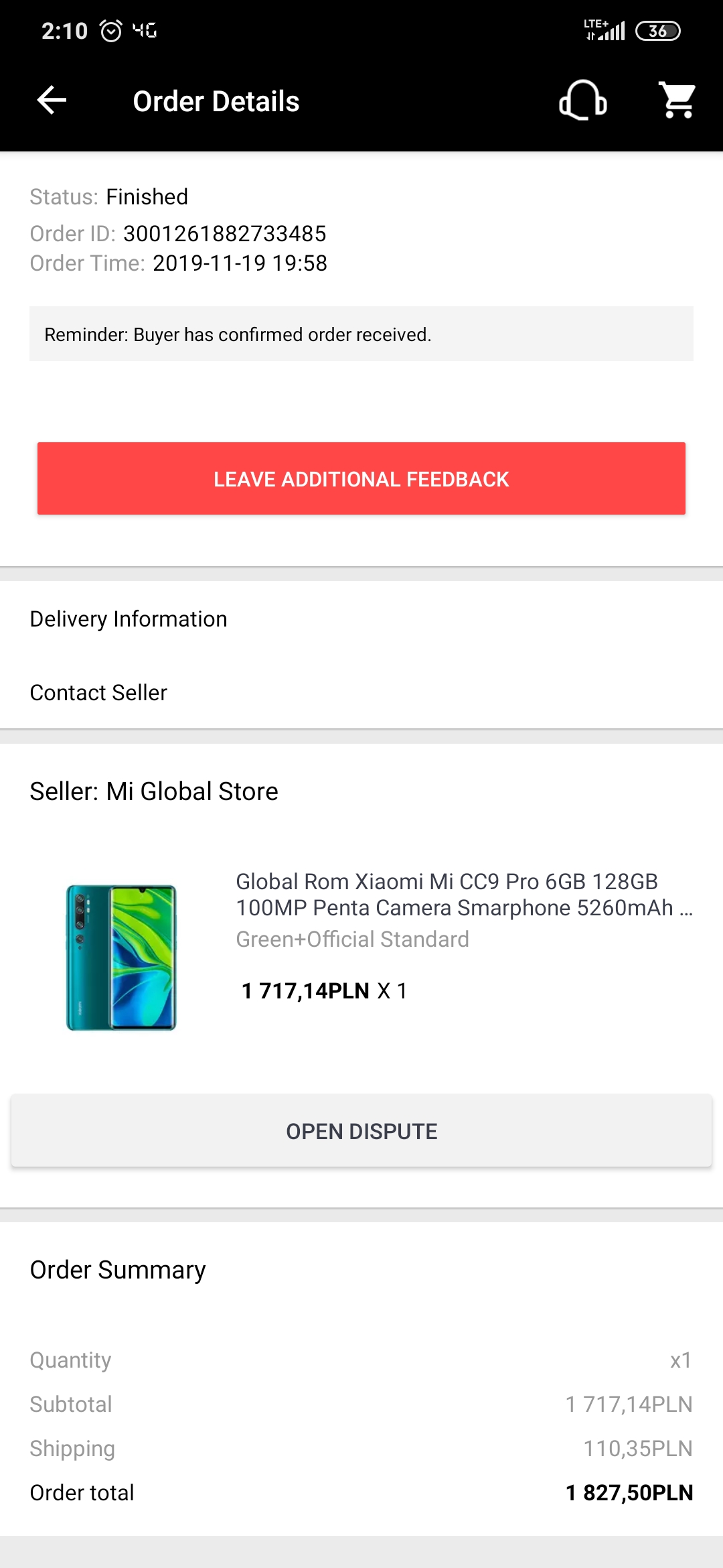

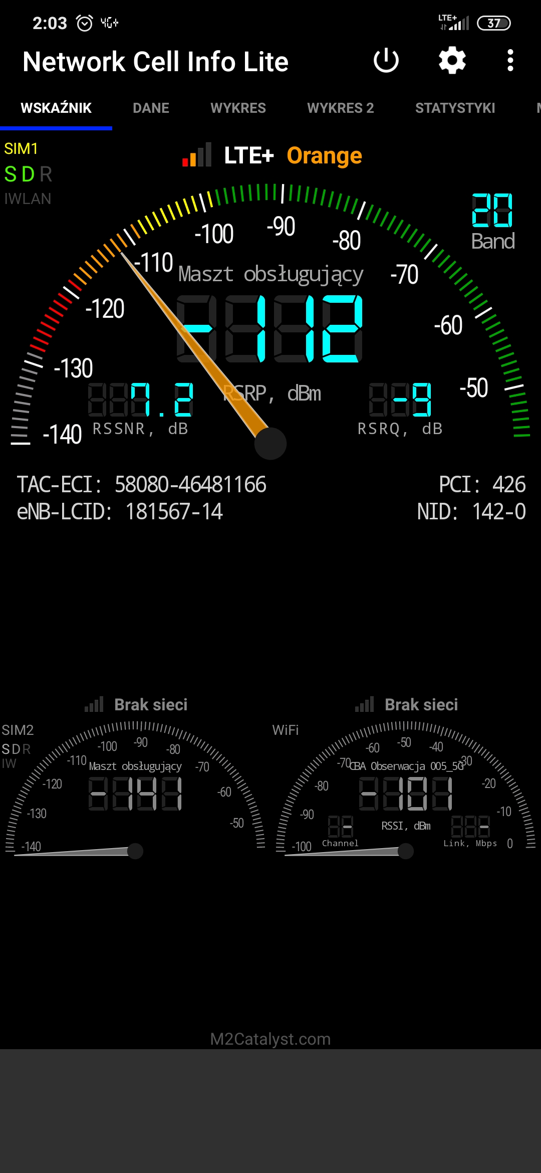

Buy from screenshot- mi global store
28198
28197
28196

I'm unlock, try weekly and stable xiaomi.eu, and after week back to global and lock, any soft- b20 is work normally.

If it's true, seller send me note10 , not cc9 pro.
But it's strange, on weekly and stable xiaomi. eu, cameras named is "photo shot mi cc9 pro penta ble ble ble, in globale stable Europe, photos names: shot mi note 10 ble ble ble

M1910F4G XIAOMI PHONE MODEL is NOTE 10 and NOT a CC9pro :
Full LTE band coverage only on NOTE10 Global
WEEKLY EU is made from CHINESE rom.
So, you have chinese cc9pro naming in application and boot. But your phone is still a NOTE10.

@LOLO9393 that was exactly what i was thinking.
That's why i asked for a picture of the box .
It's a NOTE 10 and not a cc9 pro like the topicstarter claimed to be.
