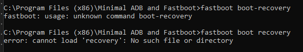

after flashing and rebooting it will start system. did you not read my howto carefully :)
How to start TWRP manually
# fastboot reboot-recovery
# fastboot reboot recovery
# adb reboot recovery
# restart device
# hold "power on" and "volume +"
Reactions: generalgotovina
# fastboot boot-recovery
# fastboot boot recovery
# adb boot recovery
# restart device

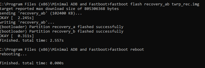

so. I installed "XM12Pro_V13.0.36.0.SLBCNXM_v13-12-fastboot.zip" via fastboot. worked. booted and I did the minimal setup.
then I rebooted into fastboot
(used the latest version: https://dl.akr-developers.com/?dir=skkk/TWRP/A12/v6.0_A12)
flashed twrp with "fastboot flash recovery_ab twrp_rec.img"
tried to use your commands:
none worked
tried then to boot twrp with
"fastboot boot twrp.img" (with the boot image)
did not work
tried to reboot with vol up and lock button
Booted again into fastboot
something is wrong here...

ups… reboot instead of boot should work. but why are you in fastboot instead of recovery after volup+poweron
can you try to flash another twrp version or boot another twrp version?
