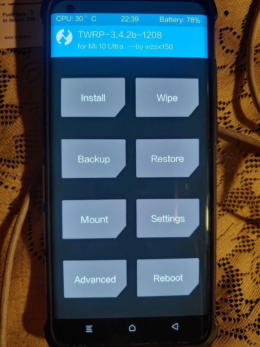

When I choose to install it from Settings - My Device, I'm booted into Recovery - TWRP 3.4.2b-1208 by wzsx150.
I've never seen this recovery before in my life.

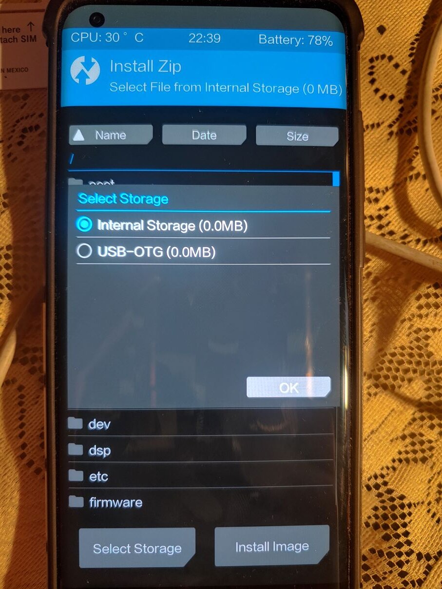

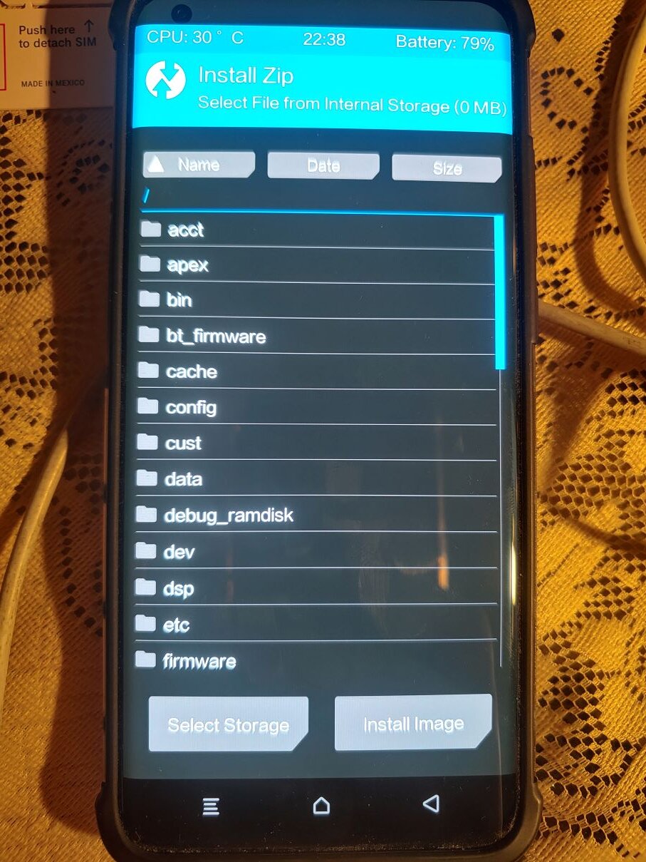

When I go to install, the zip file isn't showing up in the root directory.
When I hit Select Storage I have Internal Storage but it shows as (0.0MB)
What am I doing wrong?
Install rom from usb otg or install new recovery support android 12.(install by usb otg same rom) I'm use twrp-3.7.0_12-v7.2_A12-cas-skkk.img
