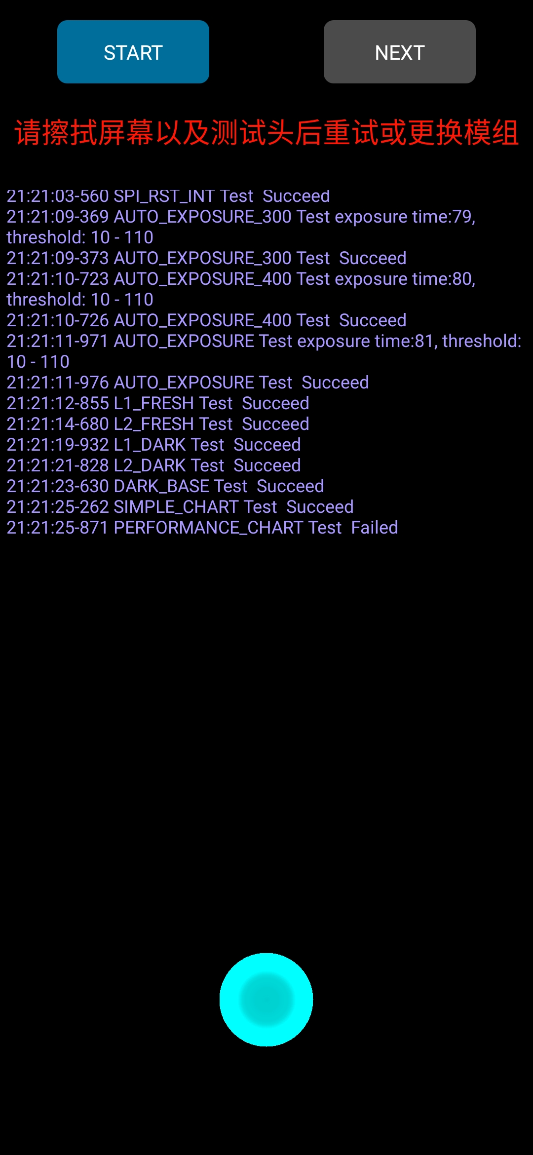

Hi
I have a Mi 11 with a broken display. I´ve changed the display with an Original Servicepack. Now the fingerprint sensor doenst work. I´m now in the service menu and i can calibrate the sensor. First thing to do is to put a white object over the sensor. Next object is a black thing. But the next message make´s no sense for me. " Test, put the FLESH CHART horizontally." I dont know what it means. I´ve tried everything. When i do nothing then the message prompt. "1503 Get calibration failed."
Has anyone an idea? Who can help?

Yeah I have the same issue after replacing the screen, Except I get the Error "1515 Brightness instable"
I guess theres some sort of pre set flesh texture the sensor needs to see.

Heya,
I did end up finding and fixing the issue, the problem is that you either replaced the screen or messed with the persist partition (holds sensor config data)
I fixed it by deleting the Goodix Folder in the persist partition, you need root permission to do this. After that, try calibrating again, it should work.

Heya, I had to try a few times after deleting the Goodix folder, in the factory, they use something silimar to a fleshy cube that resembles your fingers texture

Hola a todos
Espero poder ayudar a todos aquellos que estáis teléfono teniendo problemas con agregar una huella dactilar en un Xiaomi, o al calibrar la misma, ya que después de cambiar la pantalla, porque se te haya roto, es totalmente necesario volver a recalibrar la huella dactilar.
El problema surge cuando estamos recalibrando y en el tercer mensaje, que indica “Test, put the FLESH CHART horizontally”, al poner el dedo, u otro patrón de colores, como puede ser el color carne, el naranja u otro patrón de gama de colores tipo skin, el terminal siempre devuelve el mensaje de error, de hecho son varios mensajes diferentes, como “get calibración failed”, “1515 Brightness inble”, y varios más, todos porque el tercer test, no está saliendo correctamente. Da igual el mensaje que aparece, el problema es el mismo, y aquí lo vamos a solucionar definitivamente.
No os preocupéis, tiene solución, y no tienes que borrar la carpeta nmt \ vendor \ persit \ goodix…. Teniendo que haceros root, ni tampoco necesitáis instalar la versión original china, ni restablecer de fábrica, ni nada por el estilo… nada de esto es necesario, sólo seguir los pasos que indica el test, pero tiene truco al final, y esto es lo que quiero compartir con vosotros, que a más de uno os va a alegrar el día, ya que lo habéis intentando todo sin éxito…
Hay una herramienta china para recalibrar el lector de huellas, tras haber reinstalado el display (cambiado vuestra pantalla), y cuesta unos $ 25, o 22 €, pero NO tenéis que comprar esto, ¿ya que tenéis un dedo verdad ?, pues este producto es lo que imita, una huella dactilar del dedo.
Os dejo un enlace para el que quiera comprar la herramienta, pero os digo que lo podéis hacer sin ella:
https://es. Google_7_rmkt y gclid = EAIaIQobChMIl6yRo8r38wIVcWQVCB2WSgsKEAEYASADEgK3SPD_BwE y aff_fcid = 92c1b593ebb04795abffad4d731fdfe2-1635784019888-04944-UneMJZVf y aff_fsk = UneMJZVf y aff_platform = aaf y sk = UneMJZVf y aff_trace_key = 92c1b593ebb04795abffad4d731fdfe2-1635784019888-04944-UneMJZVf y terminal_id = 0efe7cb77dcf43b681a4c850e7fc2249
Precisamente esta herramienta me ha enseñado qué hay que hacer, y por fin, mi teléfono cuenta de nuevo con el servicio del lector de la huella digital, y os digo que funciona como cuando lo compré nuevo. Ojo, porque hay protectores de pantalla que impiden que esto se ejecute de forma correcta ... os recomiendo quitarlo mientras recalibramos de nuevo el lector de huellas. Yo lo tengo puesto, y es verdad que la huella tarda un poco más en ser reconocida, pero prefiero sacrificar la inmediata, y conservar mi pantalla como si fuera nueva por mucho tiempo.
Bien, vamos a allá:
1º vamos a AJUSTES
2º vamos a Mi dispositivo
3º vamos a Todas las especificaciones
4º Vamos a versión del Kernel y pulsamos sobre el mismo, hasta que aparece el menú CIT, arriba a la derecha, vemos tres puntos, que al pulsarlos, nos aparecen "Additional tools", pulsamos sobre esta opción, y nos llevará a un submenú , que se llama Herramientas adicionales. Abajo del todo, vemos la opción 11.- Fod Fingerprint Calibration, presione sobre la misma.
NOTA: Si tienes activado el modo oscuro, quítalo, ya que el sistema necesita el estado normal, para que la huella se ilumine al máximo.
Ahora aparece un primer mensaje, que indica “Putt the FLESH FALT and then click START”. Bien, lo que haremos será poner un trozo de papel blanco, una servilleta, o algo que sea totalmente blanco.
Cuando haya terminado de scanear, te pondrá “Putt he BLACK FLAT”, con lo que pondremos algo totalmente negro, como un trozo de papal, un trapo, o algo que sea totalmente negro.
Si todo ha ido bien, que lo hará, pondrá “Test, putt he FLESH CHART horizontally”… y aquí viene el problema, porque siempre te tira error… bien, si has visto la maquinita china para calibrar la pantalla, verás que el trozo de silicona de color carne, o amarillo, tiene unas estrías, o bandas horizontales, que simulan los surcos de la huella dactilar, por eso, el teléfono te está hacer diciendo que lo pongas de forma “horizontal”, sólo tienes que esto… Mírate el dedo pulgar de tu mano, y verás que en la parte de arriba de la yema del dedo, las marcas de la huella se ven de forma horizontal, que es la forma en la que tendrás que colocar tu dedo sobre el teléfono. Es decir, no coloques el dedo de forma horizontal, sino de forma vertical, que haga coincidir esas líneas de tu dedo, con lo que el lector de huellas está pidiendo.
No te preocupes si fallas a la primera, vuelve a intentarlo hasta que te salga, te prometo que te funcionará al 100%, y te habré alegrado el día. Mira tu dedo, para que entiendas el sentido en el que las líneas tienen que tocar la pantalla.
Gracias por leer, y espero de verdad que esta guía te haya ayudado.
