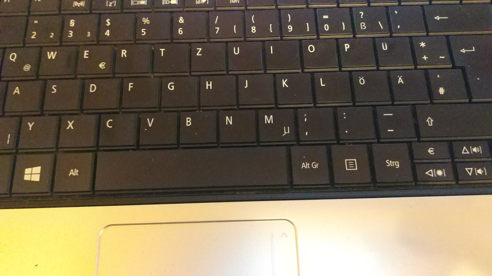

    I am using Mi 5s and camera focus seems having some issue, have a look attached photo, left top corner you could see it's blurry while center is completely normal, I need to tap focus couple times to make blurry go away, any idea why?

    Have you tried using 3rd party camera app ?
  3. kojoti
    kojotiMembers
    Mar 16, 2012
    62
    14
    18
    Male
    Focus don't have any issues bokeh effect when you focus and make photos of close objects....
  4. HALİL MERT SOLAK
    Dec 3, 2016
    6
    1
    Male
    We call that "macro" that means camera app always try to focus closest objects. You must try to hold your phone paralel with your object (i.e keyboard like your photo). Have a nice day!

  5. lkthomas
    lkthomasMembers
    Nov 15, 2016
    25
    5
    Male
    I did, same problem, I was using open camera to test.
