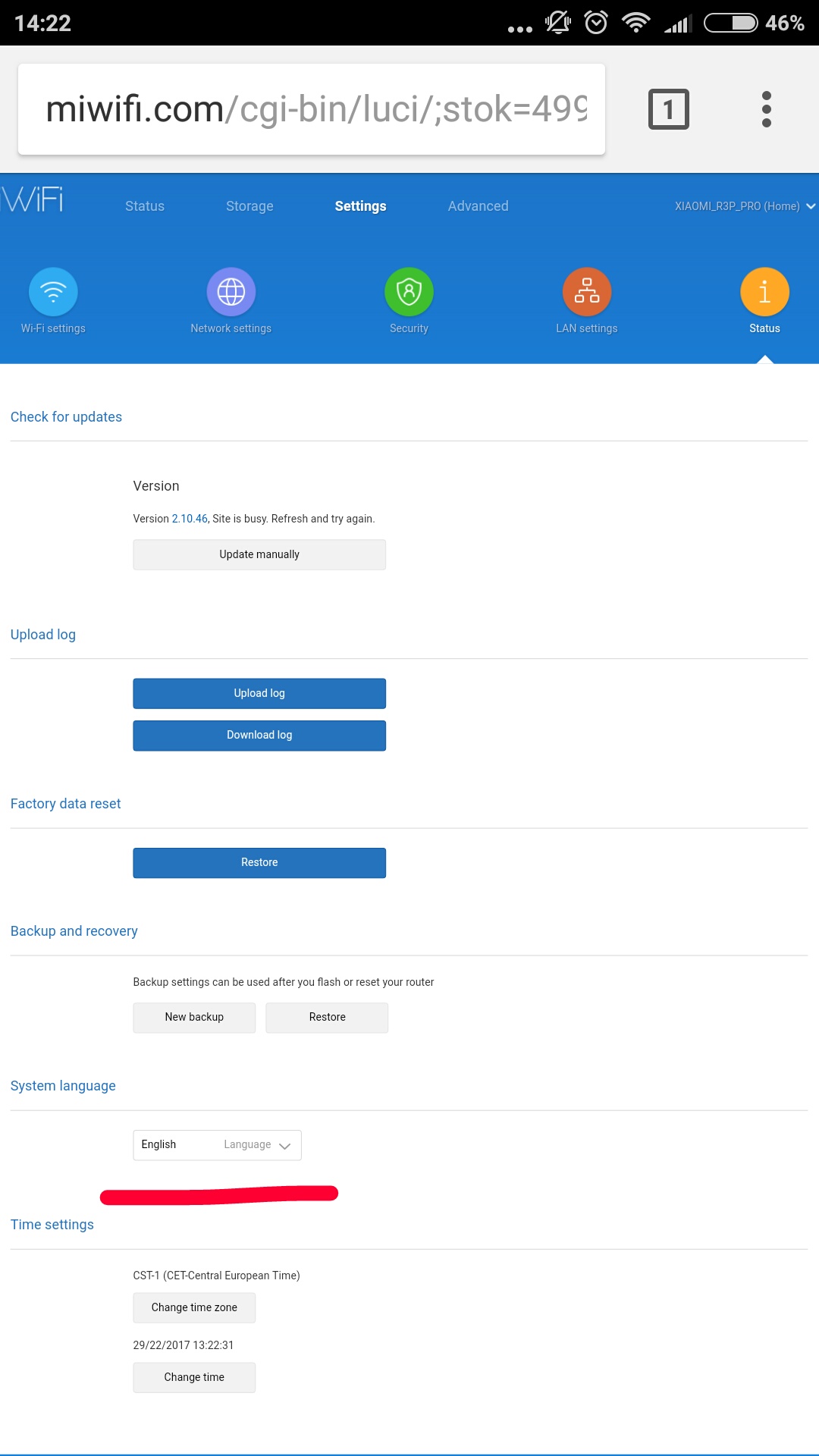

Hi, im a bit new to all this, but where did you find the R3P international firmware? I don't seem to be able to find it under ROM downloads.
