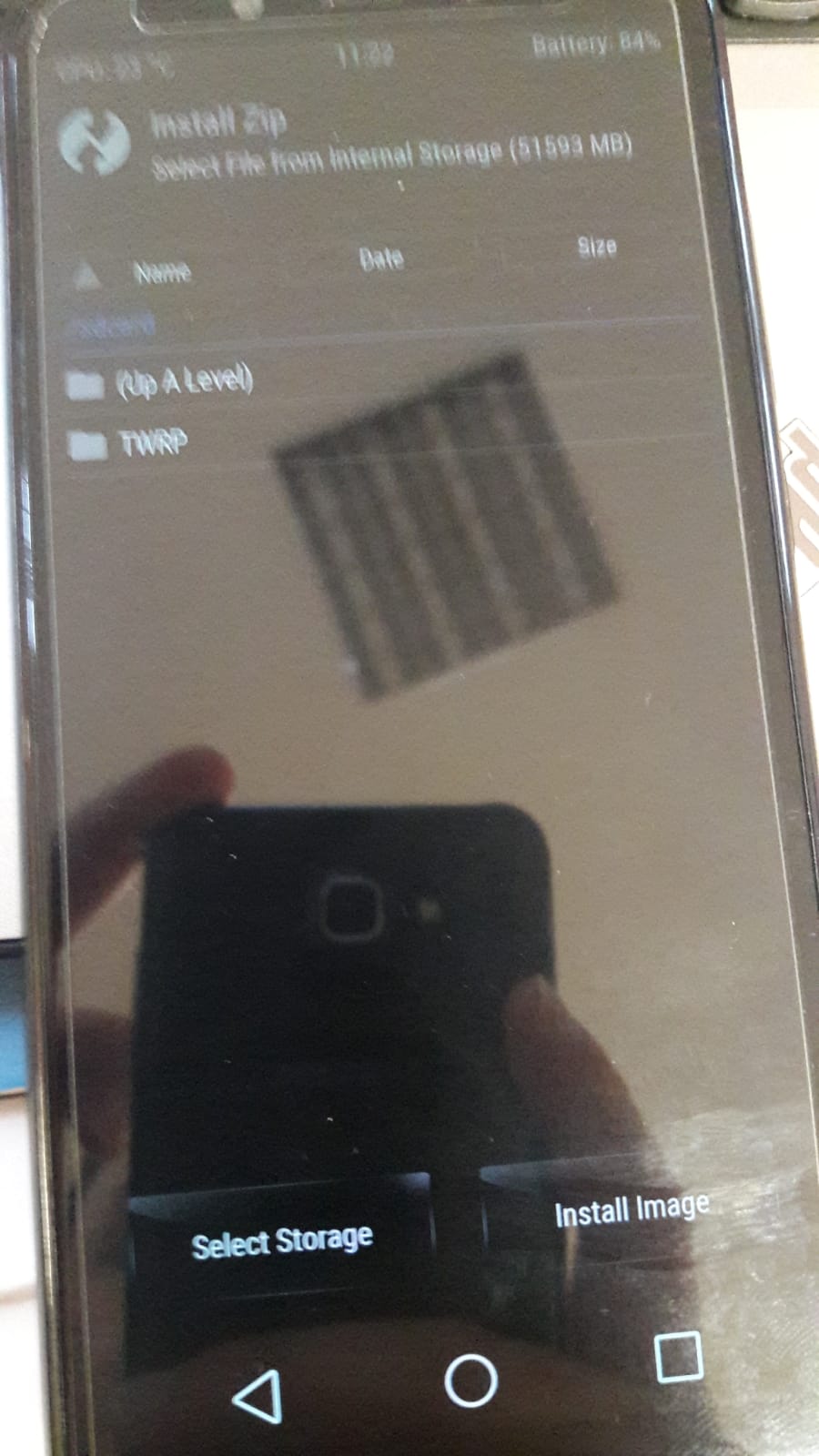

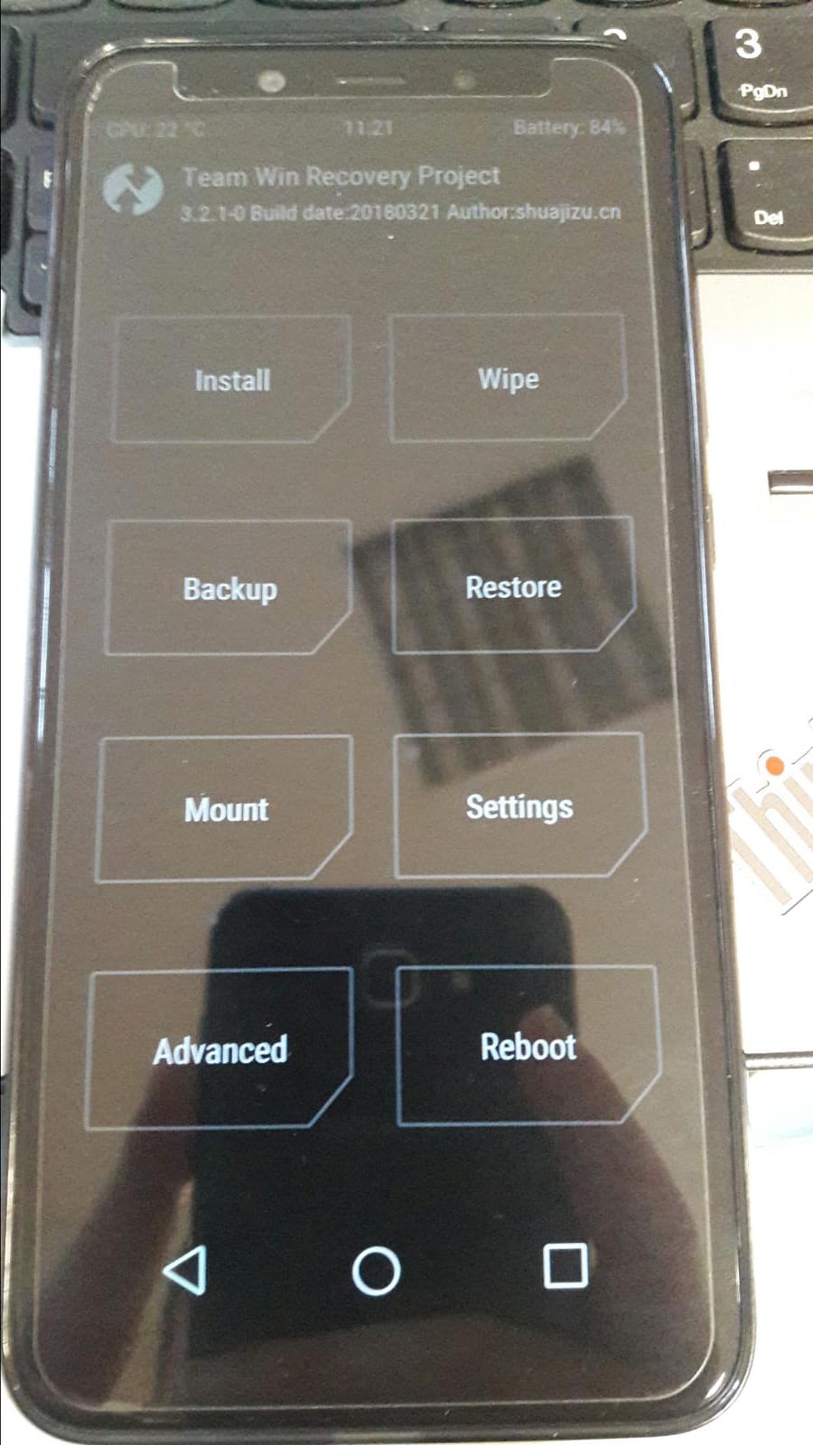

En: After the factory reset my software gone. My phone is open twrp and fastboot mode. but software file not copied on my phone memory. How to unbrick help pls???
TR: Factory reset yaparken ters bişeyler oldu. cihazın yazılımı uçtu. twrp ve fasboot mode giriyor. pc görüyor ama twrp mode'da rom dosyasını telefon hafızasına kopyalamıyor. konu hakkında yardım lütfen!!!

copy rom file to internal storage via PC and install it again..

If you boot in to TWRP, you can access your phones internal storage over USB. Copy the latest ROM zip to your phone and install it through TWRP like you would anything else.

when i try to copied the rom file internal storage this message seen my computer screen; device is not connected or can be disconnected
I would start the process again. Completely unplug the phone, reboot it back in to TWRP and THEN plug it in to the computer.
