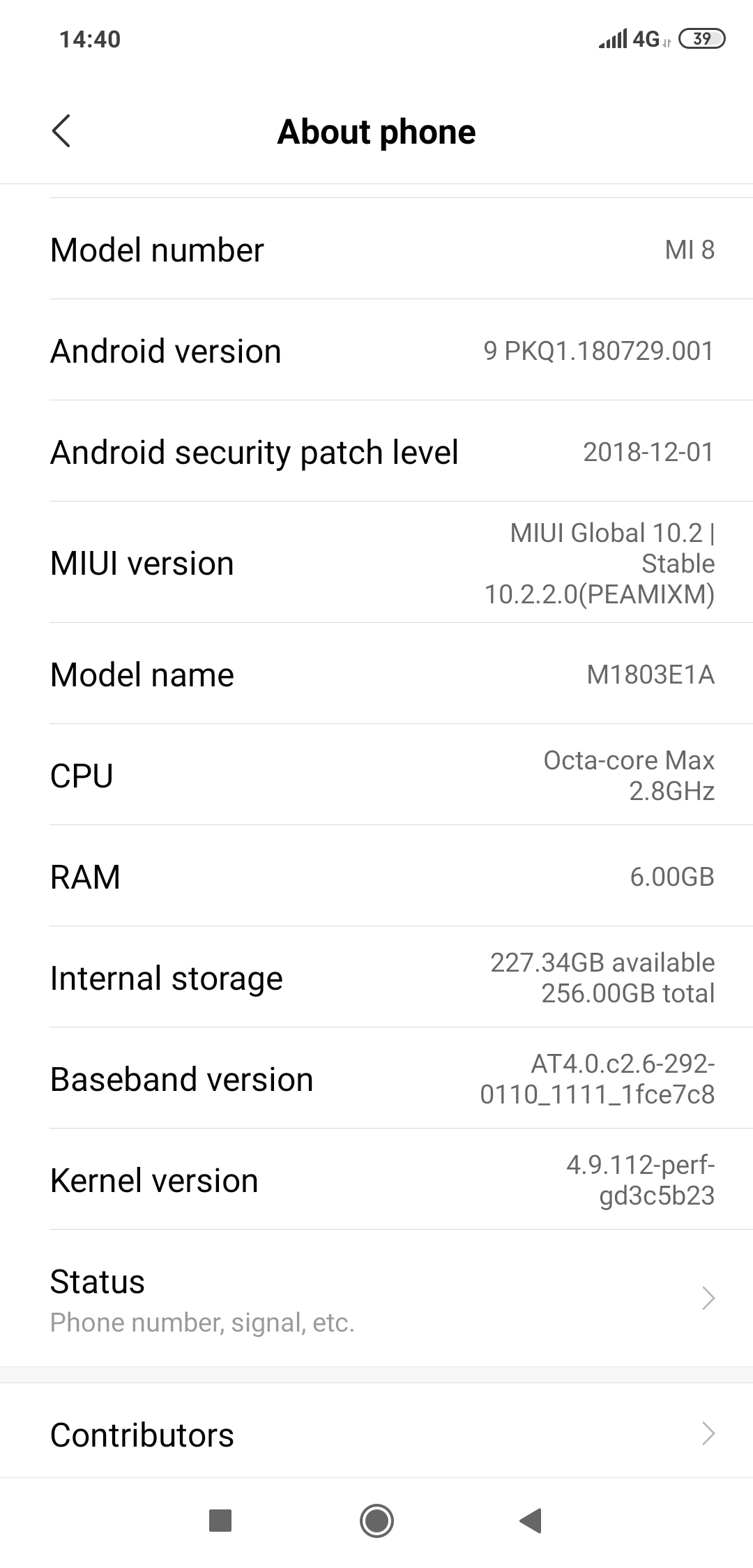

I have attached my Mobile phone details. Does that tell me it is a Chinese version ?. The bootloader is unlocked.

According to attached screenshot above it is official global ROM from Xiaomi: MIUI global 10.2.2.0 PEAMIXM
https://en.miui.com/thread-5289843-1-1.html
This ROM has SafetyNet certification but installed system has not. Therefore I suppose there could be a backdoor or trojan horse - or it's a fake ROM.
