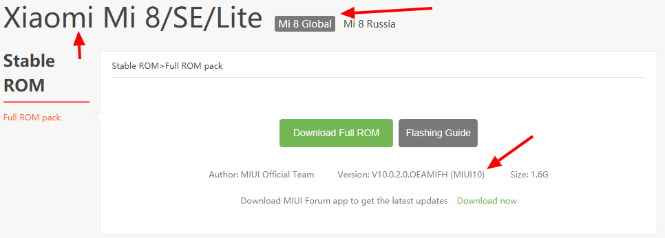

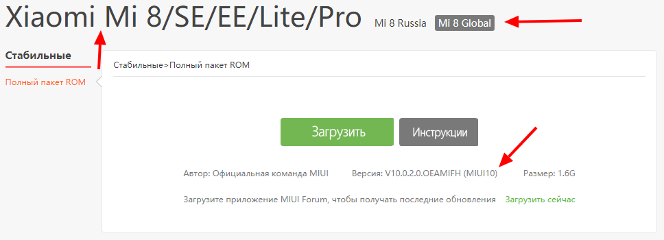

Hey I found that this rom (ROM V10.0.2.0.OEAMIFH ) on the russian site is the same on the us site, but the names for the device is NOT the same.
check the captures.
Image on US website
Image on RUS website
The question is: Could I use this ROM to flash the MI 8 EE?
